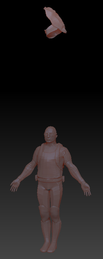

that’s cool but, i exported all subtools and modified one of them in xsi, and reimport all meshes into zbrush then i can see the modified mesh is not in the right place… :-? any solution?
Hi mehdiravan!
What kind of modification have you done in xsi?
The only way I can think is that you have change transforms, like scale, indepedantly
but in this case you should have the same result in xsi…
Can you give me any details?

Ok, and now ? :roll_eyes:
i applied randomize deformer to shoulder armor. thank you.
