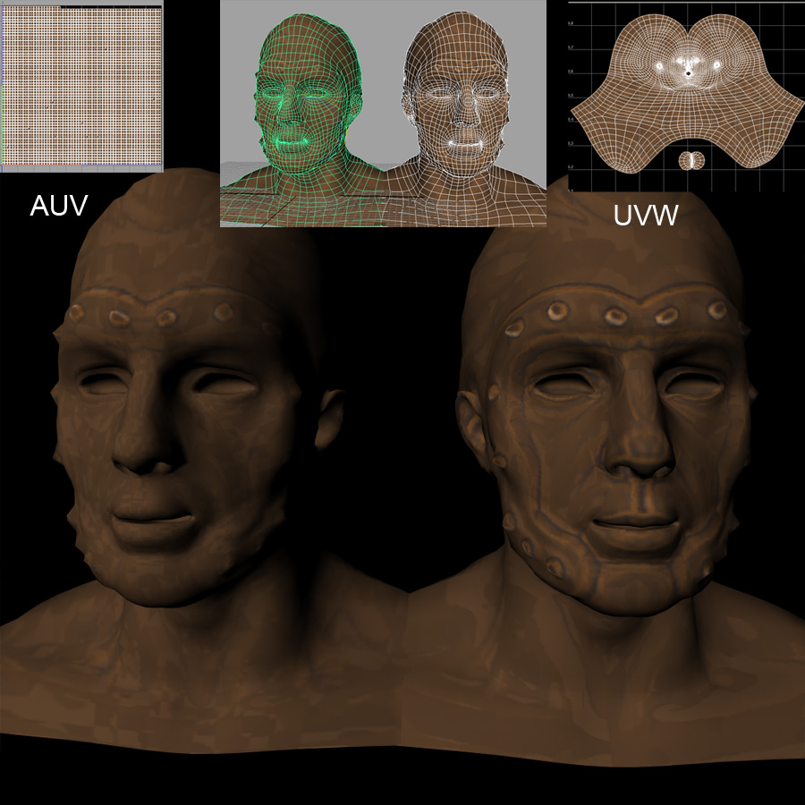

I’m puzzled by your tut showing Sebcesoir’s baking method
How is it that you can use AUV tiles and not me :question:
I always get the tiling in the texture!
For this method I’m forced to use clean Uvs and it’s
very frustrating to see you using AUV and not having any problems…
I tried it on the demohead with the same displacement settings
as you and it’s not like the Alpha Depth slider is very complicated either…
Any hint about what I’m doing wrong?
heh
on the record I really hate AUV tiles. I would never use them on a professional model as an end mapping system.
That being said they are very good at transfering the burned texture back to the mesh.
Heres the secret burn it back to the mesh first, never output the first texture that is baked using the crop and fill.
By burning a 2048 map back to a 1 million poly object it will blur the map taking out all the AUV lines.
Why? because for a 2048 map to stay at 2048 res,
the polys would have to equal 4million or so in Poly paint world (could be more)
Then when you get done with all the burning it back to the model I would sudjest making some UVW mapping for the head. for maya or max
Video 2 is a product of that blur and thats why the AUV did not do anything weird. But I bet you anything that the normal map would have looked like crap using those same AUV tiles unless I burned it to the model.
Which I am going to try now;)
Didn’t work at all!
The shading is inverted on each tiles from the one beside it.It’s very weird.
It seems something is happening at the crop n’ fill step because when I load
the displacement map as a texture there is no seams at all.
I even use AUV for normal maps in max all the time without any problems.
I think I’ll give up on this…:cry:
Thanx anyway:)
on texture baking 2 you don’t have to worry about AUVs at all because there is no crop and fill, its staying in poly paint mode to burn the material into the texture.
But your right the crop and fill is doing some odd stuff with AUV tiles.
UVW wont do that.
Did not have time in the vid to go through a UVW map for the head;) (see doing UVS in blender video with the demo soldier post #98)
I’m just writing this info out incase another peep comes across this issue also. Christian
Anyway here better illustrates AUV vs UVW and how much more crisp things look.
Both models were made using texture baking 1 video just with different UVS (there is no bump map on these models!)
Some of the metal mat caps will look weird in the spectral shading areas. using this method.
To get around that use texture baking 2 video

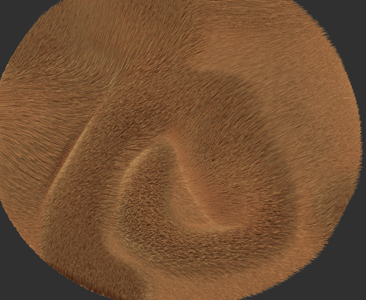

I have been working on a character with fur lately and wanted the fur to stay a good resolution without a trillion polys.
So I figured hey if I was having fun dealing with keeping good resolution, I bet there is somebody strugling with that issue also.
So heres my solutions to keeping resolution under wraps.

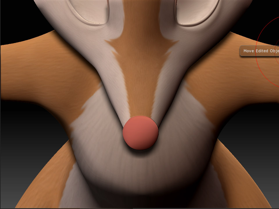

This was a problem when I wanted to polypaint an entire figure with fur. The head was decent poly count/even poly size, but I left the body pretty low, with huge polygons in comparison. Thus, when I divided the entire mesh to paint, and got the head with enough polys, the body was still too low to have the same detail. I couldn’t divide anymore since the head was already so dense, I’d run out of memory on a 2 gig system.
My solution was to split the figure into subtools and divide each to be sort of even. The head, body, arms, legs, hands, feet, all split to subtools using polygroups. (I made sure the figure had it’s uvs before doing this) Then going to each subtool, I turned creasing on and divided them all until they were all about the same polygon size. So I probably left the head and hands/feet alone, and divided the arms, leggs and body to match. Then I used make-1-mesh and it was one tool again. Still split up, but I could now divide it all at once evenly, and while pushing my memory to the limit, the detail going from the face to the body was even. And the UVs were still working when I did color to texture. And painting across the split parts worked fine. If you use the smooth brush on the left, to blur colors, there could be some issues at were the mesh is split. Using projection master blur brush is still fine.
I didn’t think about creating an alpha with as many fibers as here to use with the drag-rect brush. I did something similar, but then used spray and variation to get the color and depth all at once while painting how the fur curved and flowed (which was hard to do). I wasn’t going for anything ultra realistic, more suddle:

Sometimes I felt going to a texture sometimes loses detail, which might have been caused by real unwrapped uvs that don’t use every pixel of a texture area compared to tiles.
I believe the opposite is true. If the texture has a larger pixel count than the model has polys, the pixels would be compressed into individual pixels to match the polys and you would loose resolution. An exact or near match should be the goal and the more polys the better it will look.
And get your topology as organised as possible to start with.
Same as you should have more poly’s where you want more sculpting detail, you also want to ensure you have enough polys in the areas where you are going to paint detailed work.
