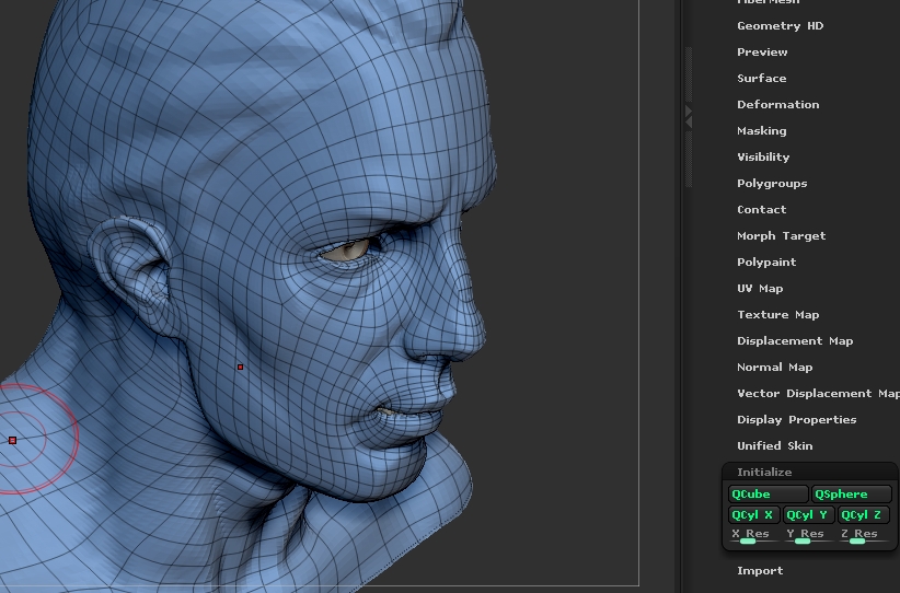

Just would like to change several objects into a modeling sphere or Cube and then sculpt on them to make Morphs…Has to have same Poly count when Macro’d…
Really…Why did I not see this before…?
Thanks will try out…
Does what it says BUT…
It doesnt have the same poly count when Initilized…
I played with the sliders but to get an actual Poly count was horrendous…
We need perfect precision when making morphs or they wont work…
So we need an input that would give the option of how many polys the initialize does…
Simply having the same poly count isn’t enough to get good morphs - they’ll basically be a mess because there won’t be any correspondence between the point positions. If you want to have a sphere then you’ll need to start from a sphere and sculpt the object. You could then return to the sphere to sculpt the morphs.
