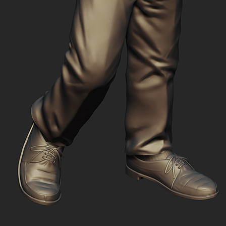

Korado3D: thanks! The shoes are no exactly symmetrical, but I do agree that the sides are not very different.

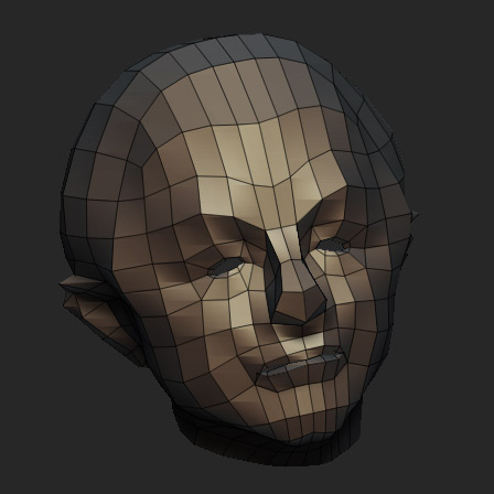

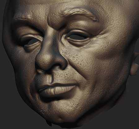

This was the topology for the head that I used from the beginning.

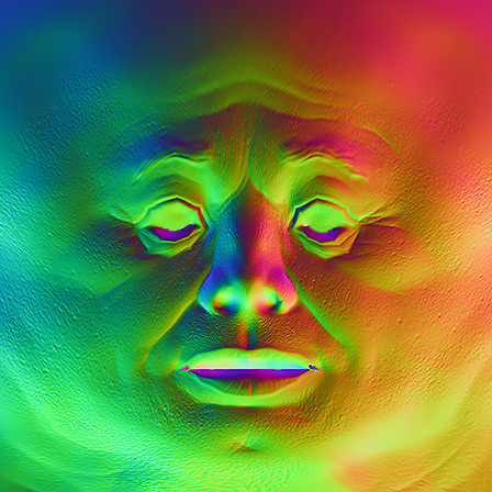

I did the high frequency details when I arrived at the texturing stage. I tried to paint directly a bump map inside ZB, but I wasn’t satisfied with the control and I decided to do it over again directly onto geometry

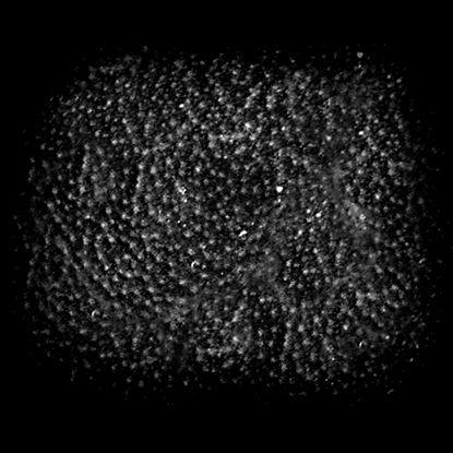

For the skin pores I used an alpha map made from a photo of an orange.
Since the model was static and it was for a still image, I decided to use a local space normal map to save me from other headaches. This way I could get the highest details without using displacement. This is not a solution if you are going to animate it.

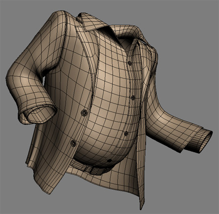

For the body I used a zsphere model as a mockup, then I brought that into max and used it as a reference for the clothing. A shell modifier was used to give thickness.
Then sculpted the folds in ZB

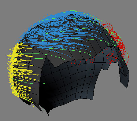

On the hair, I created some splines (green) ontop of the hair mesh sculpted in ZB, and I used those as guides for the Hair and Fur included in max. Also I painted a quick density map in ZB.
I chose to render the hair in mental ray as mr prim because the result was more crisp than the default one. The rest of the model was rendered in Vray and composed in Photoshop.
