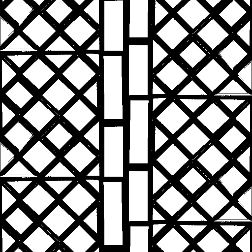

Step3- Using photoshop I figure out my tiling grid patteren and test the grid texture on the geometry to make sure its reading well. Again checkout cgtextures.com under the tutorials tab for tiling complex patterns …there you will find a bunch of other good texturing technique/tutorials you may want to read and find useful.

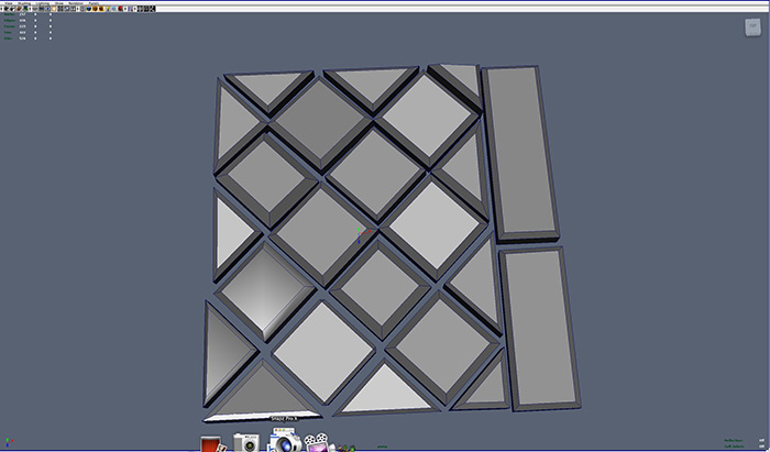

Step4- Using Maya I model my grid using quad polygons…export geo as obj file

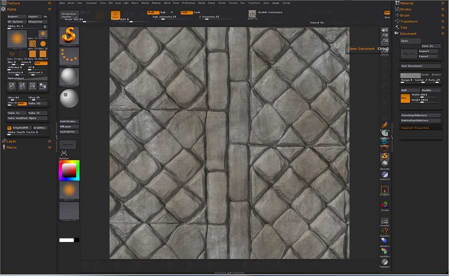

Step5- import obj maya file and use Zbrush to detail the blocks.
Step 6- Use Zbrush’s material grab and export Normal, diffuse color, specular, cavity,… etc. versions.

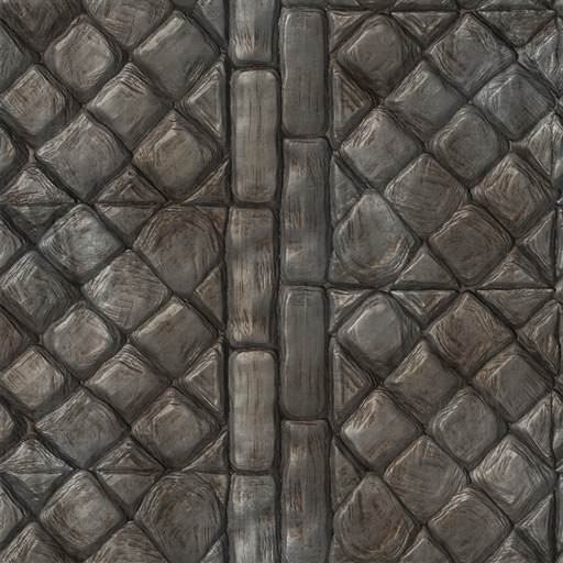

Step7-Use photoshop to composite and touchup your final texture
NOTE: for the real final texture i will spend time and add chewing gum; cigarette butts; twigs, oil spots; squashed insects,…others details to make it a bit more interesting texture.

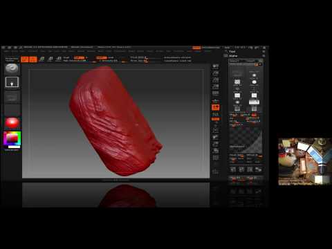

Here is a screenflow movie of zbrush process, enjoy!

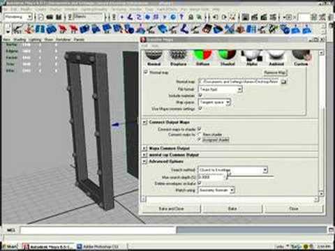

Thanks for the reply. Sorry, what i meant by “baking” is to transfer hi resolution details into the low resolution mesh by producing a normal map.
But what if it is something as complex as say a gun, in which you cannot use just a 2.5d mesh in zbrush or a single plane in maya to do your normal map, where you really need to take the hires mesh into maya and bake it into the lowres side by side, how do you deal with this in your production workflow esp. when maya doesn’t have a gigapolygon core to handle many polys in it.
I have tried all the settings and positioning the lowres to the hires model as closely and accurate as possible, but i always end up with less than satisfactory results. Although it may look good when viewed under hi-resolution in maya’s viewport with its normals maxed to soft, but when i render it in mental ray, my gun looks like a balloon with details. On the other hand if i put its edge smoothing to hard, it doesn’t look like a balloon but the details projected look very cheap and obviously low-res looking esp. the bevels, if you know what i mean.
Good morning Jinian, As a background artist I make mostly repeating textures, but in some exceptions I want to bake my textures (edge grab objects).
see if this zmapper tutorial helps you:
http://gnomonology.com/group/14
( I am still on zbrush3.2, I understand you dont need zmapper for 3.5 version, I will try it today and let you know).
If everything else fails then checkout xnormal softwarehttp://www.xnormal.net/2.aspx
