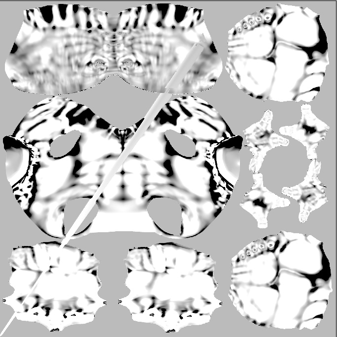

I created a model in max8 sp3 and unwrapped it in max (no overlapping). Did the detailing in in zbrush and now i am trying to export the displacement to use in max. But unfortunately i am having some problems with doing it.
My 32bit displacement map which i exported using the quick code has this streak that goes across my tiff file as you can see below. As i am a noob to zbrush i have no idea what to do and pretty much lost. I understand that it might be a vertex gone astray but when i look at the mesh with the details that i have created. it looks fine. So i have no idea where the streak is coming from …?
Can somebody please enlighten me on how to solve this problem, as i have spent alot of time doing the displacement
Encoded: that happens to me all the time, one of your UVW verts got zero’d out. Either reimport your mesh on it’s lowest level or export the lowest level and fix the uvw error.

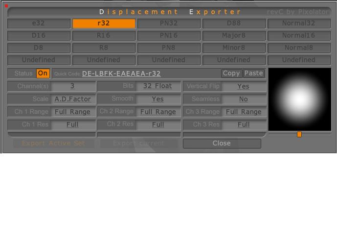

I’m trying to use multi displacement 2 to export my displacement map (just installed it)- however the button is greyed out and there is a questionmark sign. Did I install it wrong or did I miss something?
Hi yuriythebest
I think is the setting of the plug that is not ok.
I post the setting i use, coming from the pdf guide of the plug.
Important is the Quick code hilighted in the pic, also this is from the guide.
The window on the right side i think is about the strenght of the map, i leave this in the middle and i will experiment different settings…
I still get he same thing:
Hi
seems that something is going wrong in the plug.
Try and reinstall the plug, probably is this the issue…
yeah, turns out I also had to put the *.psd files in the plugin folder, that just fixed the interface and not the problem, though I was finally able figure out how to export using the good ole method.

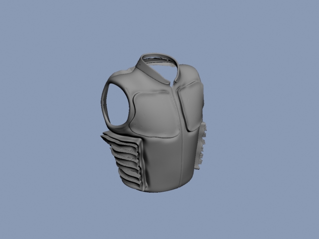

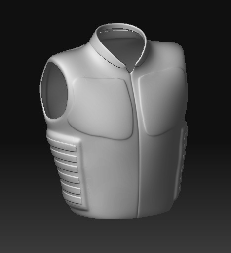

Hello! I i need help: i do all like in tutorial on the first page and when i try displacement on the test head - all ok.
But!
This i have in zbrush, after aplying displacement on model
what is wrong?
