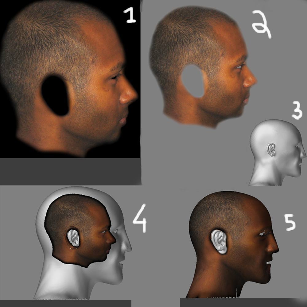

Hi Aurick,
I have recently tried your method but I think I am doing it wrongly, I cant figure out what I am doing wrong.
I am working on a human face model.
  1. I have inserted a black layer under the layer of the photo to represent the transparancy in photoshop and have saved the image as a psd.
  2. As you can see there are no black edge lines
  3. The model on which the texture will be painted.
  4. I used projection master with the rectangle tool and Zadd was set to zero.I have clicked on the transparent button in the texture pallete as requested in your tutorial. The texture for some reason has some black edge lines.
  5. After placing the texture on the model the way I want it and picking up the colour with projection master, the black lines are still there.
Please help
Aven though your background layer is black, that doesn’t change the fact that the edges of your photo are blurred. This then combines with the black background in the final PSD to create various shades of black. Even a shade that’s 1 point of difference from pure black is enough to keep it from being transparent.
In short, your original cut-out can have NO blurring. If you’re using the selection lasso to cut it out, that means that there can be no antialiasing or feathering. The slightest bit of transparency to the layer will blend with the background and create problems.

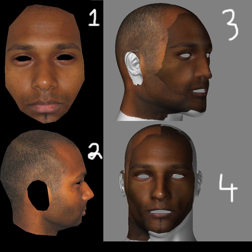

thanks for the reply. I did what you said and it worked, however I am having another problem. Is there a way to solve this?
  1. I have used this texture in projection master to texture the front of the face.
  2. Used this texture for the side. 9this texture however was maped before the front texture.
  3. As you can see, the front texture is leaving that ugly seam.
    4.front view with the textures mapped.
Please, is there a way to fix this…
Thanks a lot.

Guy’s, shaded was not on when using pm, and I didn’t use two different materials. Colour and faded were the only two checked. Thanks for replying but I still cant figure out whats wrong.
This time I turned on dsmooth to something other than 0 and I also loaded the flat meterial, but the result is the same.
Svengali- I have read and done some of the built-in tutorials and documentation, maybe not enough though.
If someone could still help me though, it would be great
Stupid question, but how many photos are you using?
Reason is that the first time I used zapp link I rotated the head
and used two different ( front and side shots ) for the texture.
Had lines exactly like this.Head was lighted differently when model turned.
Like I said, stupid question, but the results were similar.
I am using thee at the moment. one for the leftside, one for the right and one for the front. i first map the left and right and then the front.

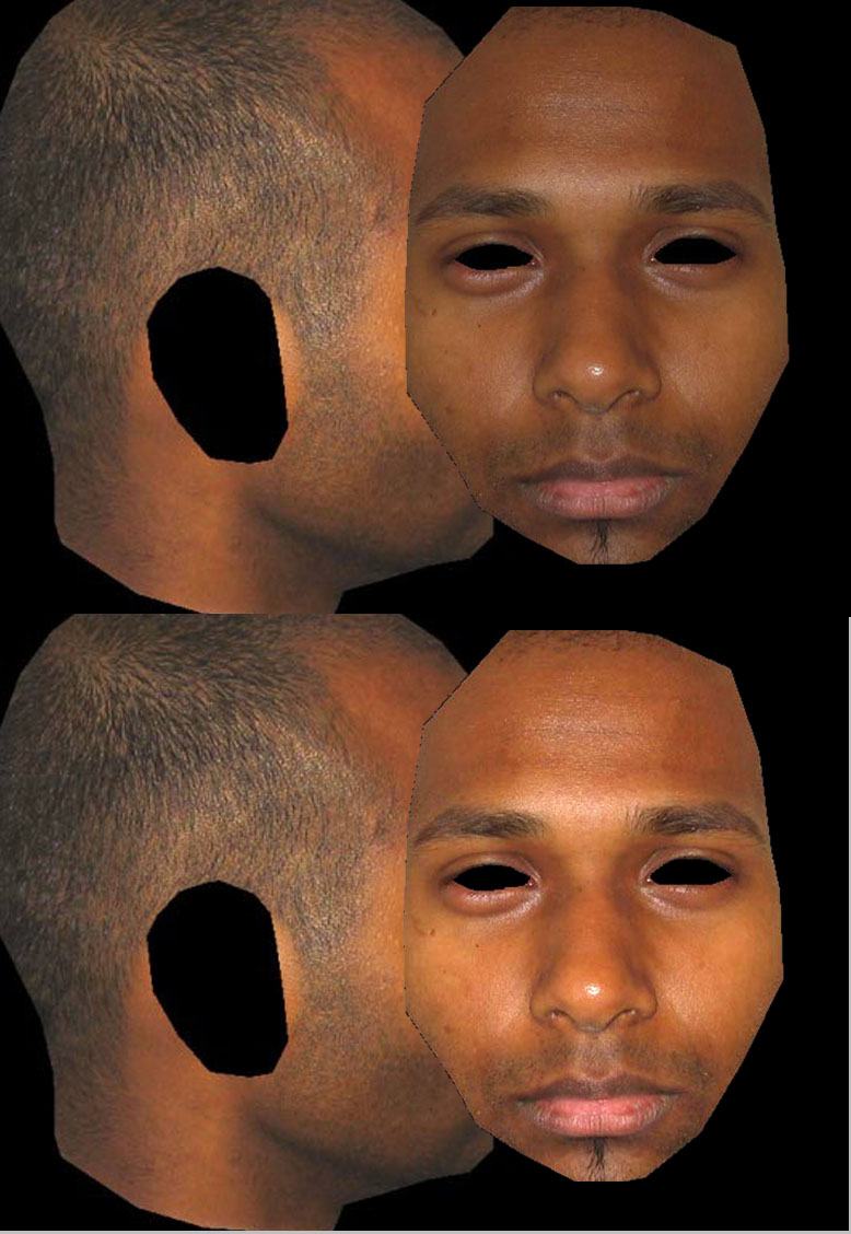

Svengali and all the rest. I appreciate all the replies from you guys. Svengali, I will try the colour correction. Did you use photoshop for that. I too had tried using photoshop CS for the colour correccion but for some reason the image was as I have posted earlier. The way I did it was:
a) open the source image
b) open the image that has to be corrected
c) in the opend image that has to be corrected, click on IMAGE, ADJUSTMENTS, MATCH COLOUR and then by clicking on source select the source image.
Yours however looks much better than mine. how did you get the colours to match so close?
Carlsden,
Each view is on a seperate layer using PS6. Selecting the front view layer, I just used the Adjustment:small_orange_diamond:Brightness/Contrast sliders to bring the front view color values up to match the sideview levels. No hue shifts, nothing else.
