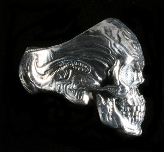

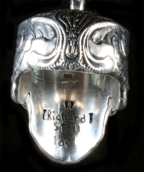

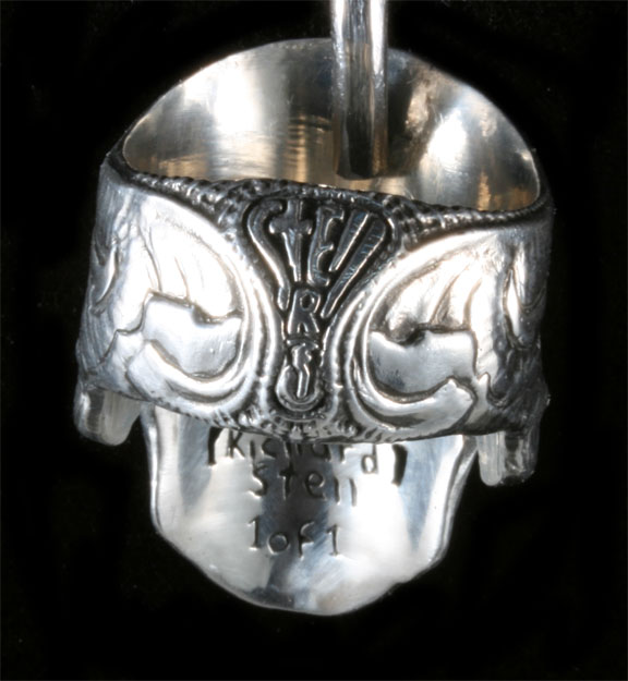

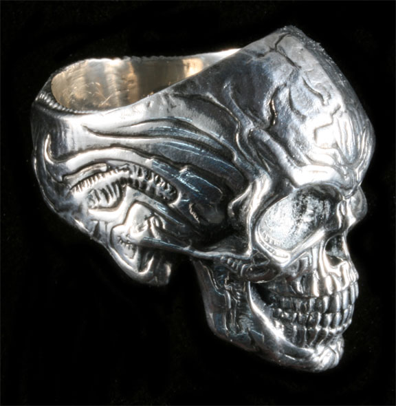

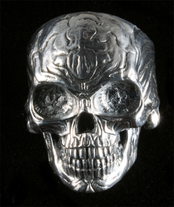

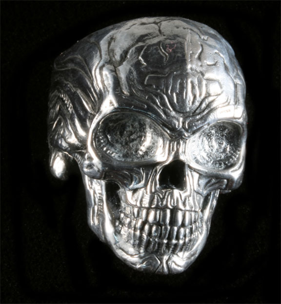

here are pics of the wax I posted in silver back from the foundry…
still waithing on pic from the foundry.
and still looking for those pics of the grown parts…
stell-34
stell-34-2
stell-back
stell-back-2
stell-front
stell-side

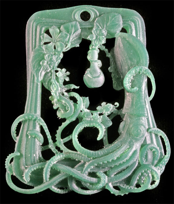

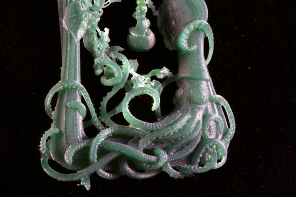

here is a pic of the squid wax.
this one is a little screwed so I did a little redesign as far as the thickness of the leaves and vines.
i’m milling that out as we speak.

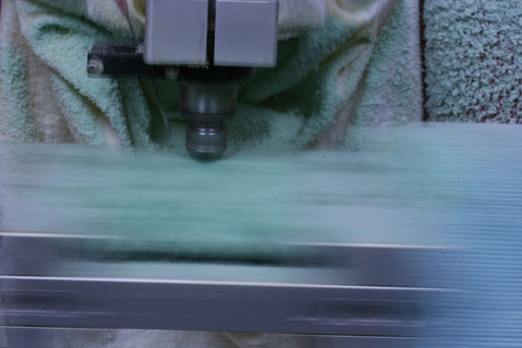

honestly and no joke it fills me with joy.
you know what a nightmare doing the tiny tiny detailed objects can be.
having the freedom to mask turn twist etc…
to have a mill in the house to generate the part
have it in haned and touch up… all in a day is MAGIC.
bench work will never be the same.
we have come a long long way,
and I dont ever have to see an open bucket of acetone or fiberglass chop again in my life…
yeeeeaaahh
truly wonderful.
just look at it go :smiley:
wooooohooooo

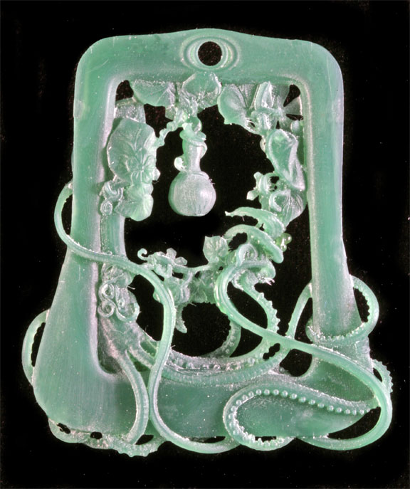

here is the new wax…
Cephlapod-Love-back
Cephlapod-Love-front
Turned out great how large is it?
50mm x 60mm
It’s a little bigger than most my pendants but it lays well I think .
another reason for it being a little larger is I want to make a small attachment for the top so you can also wear it as a broach.
something different, trying to keep more wearing options open.
