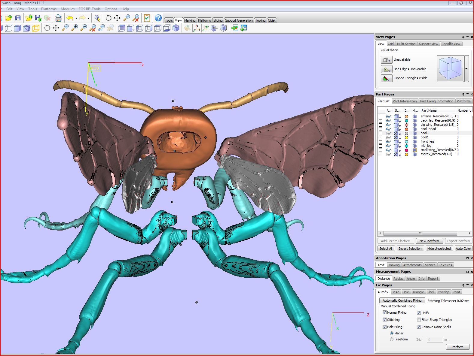

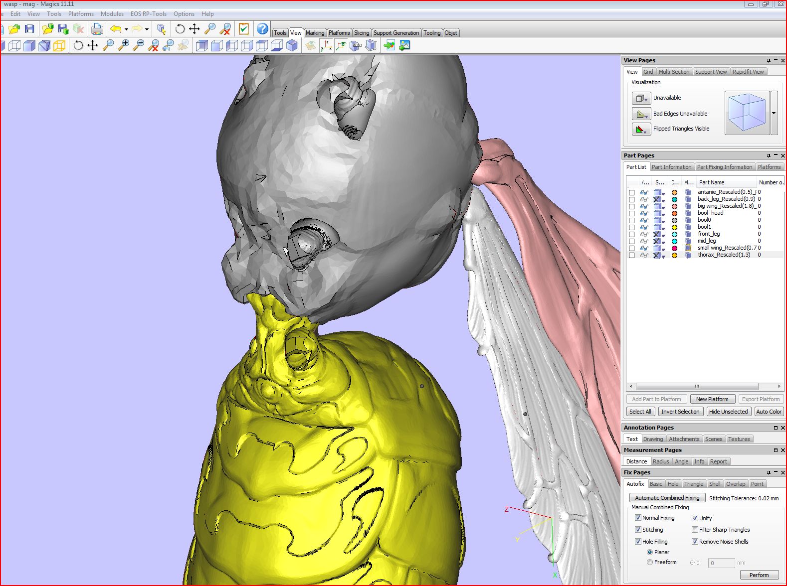

Sigmund Hentze - I used to have to use 3 programs to get the model down to where i could build tooling paths. and the stls that rhino would export were sloppy. it couldnt tell the difference between sharp details and inverted norms or noise shells so it would screw the details.
I dont know what they did in there but the stls are very very clean. I run one or two passes in magics and the shells are beautiful.

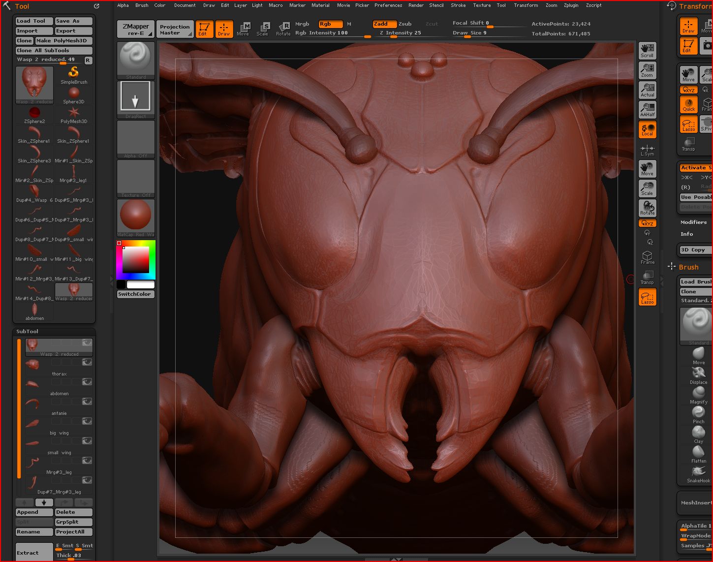

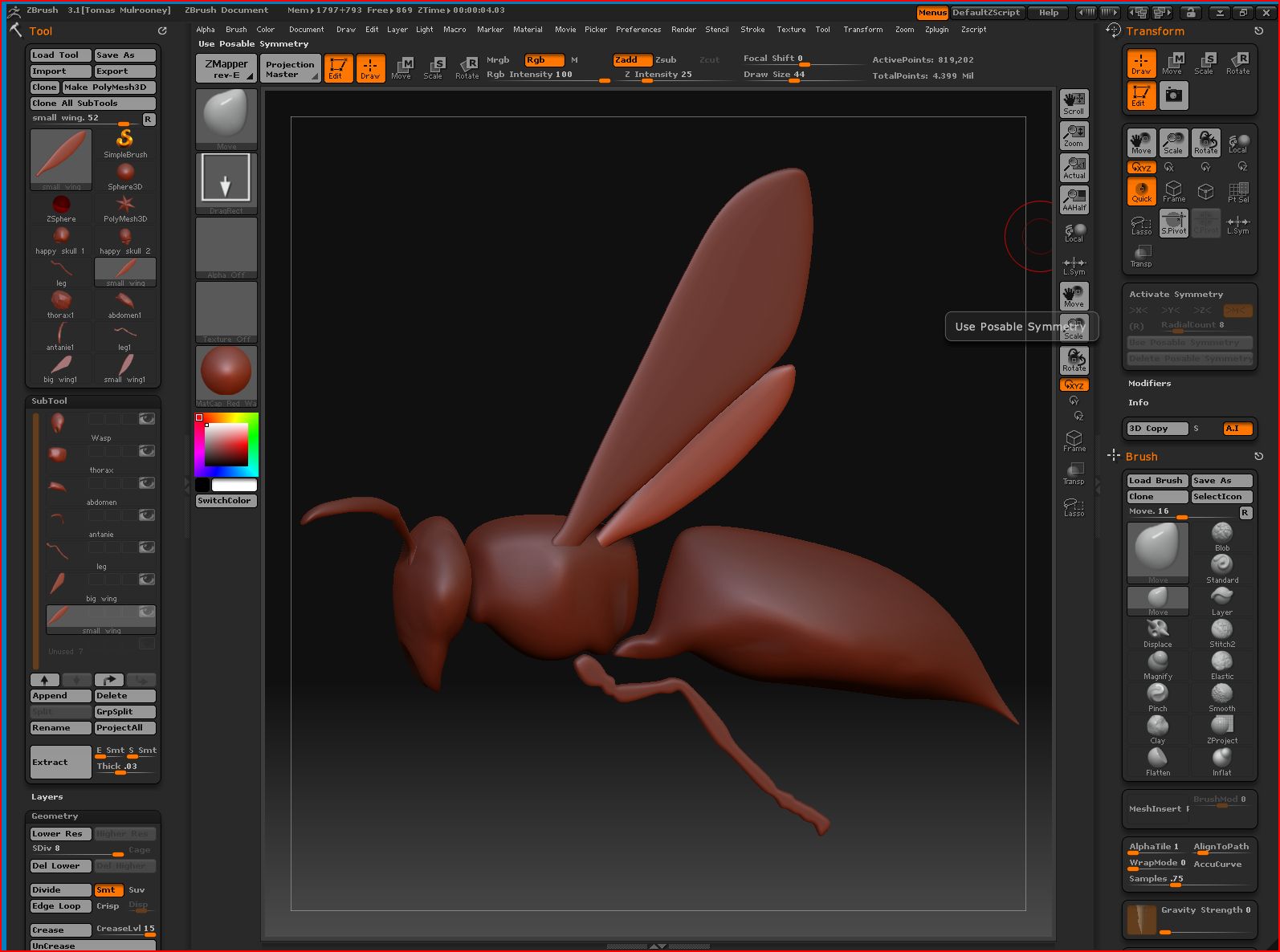

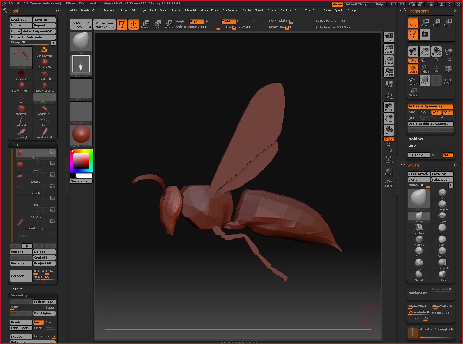

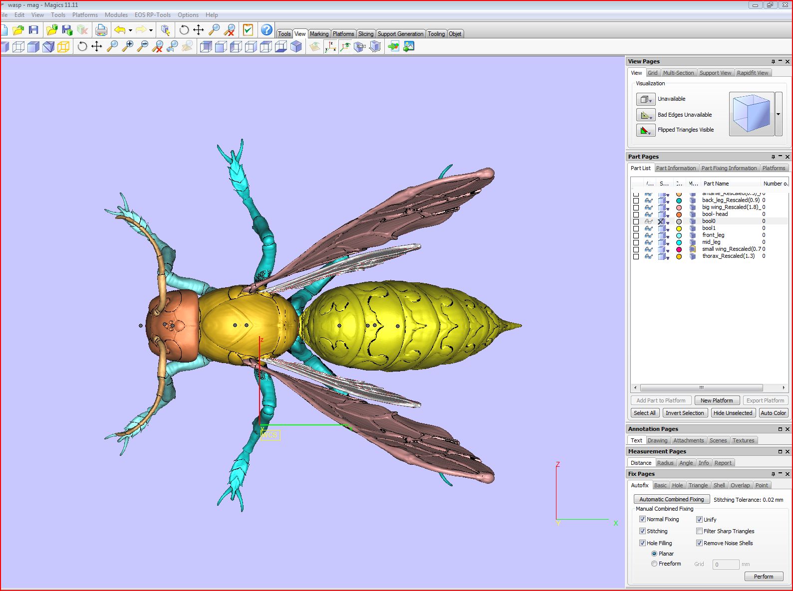

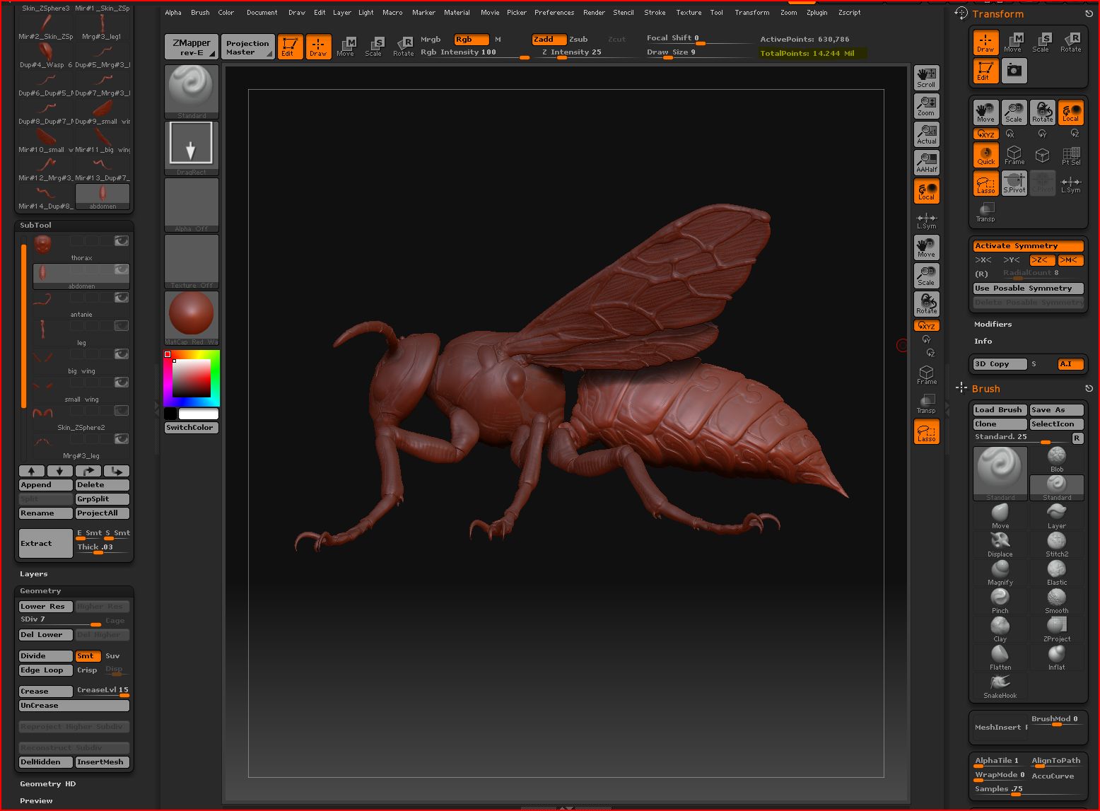

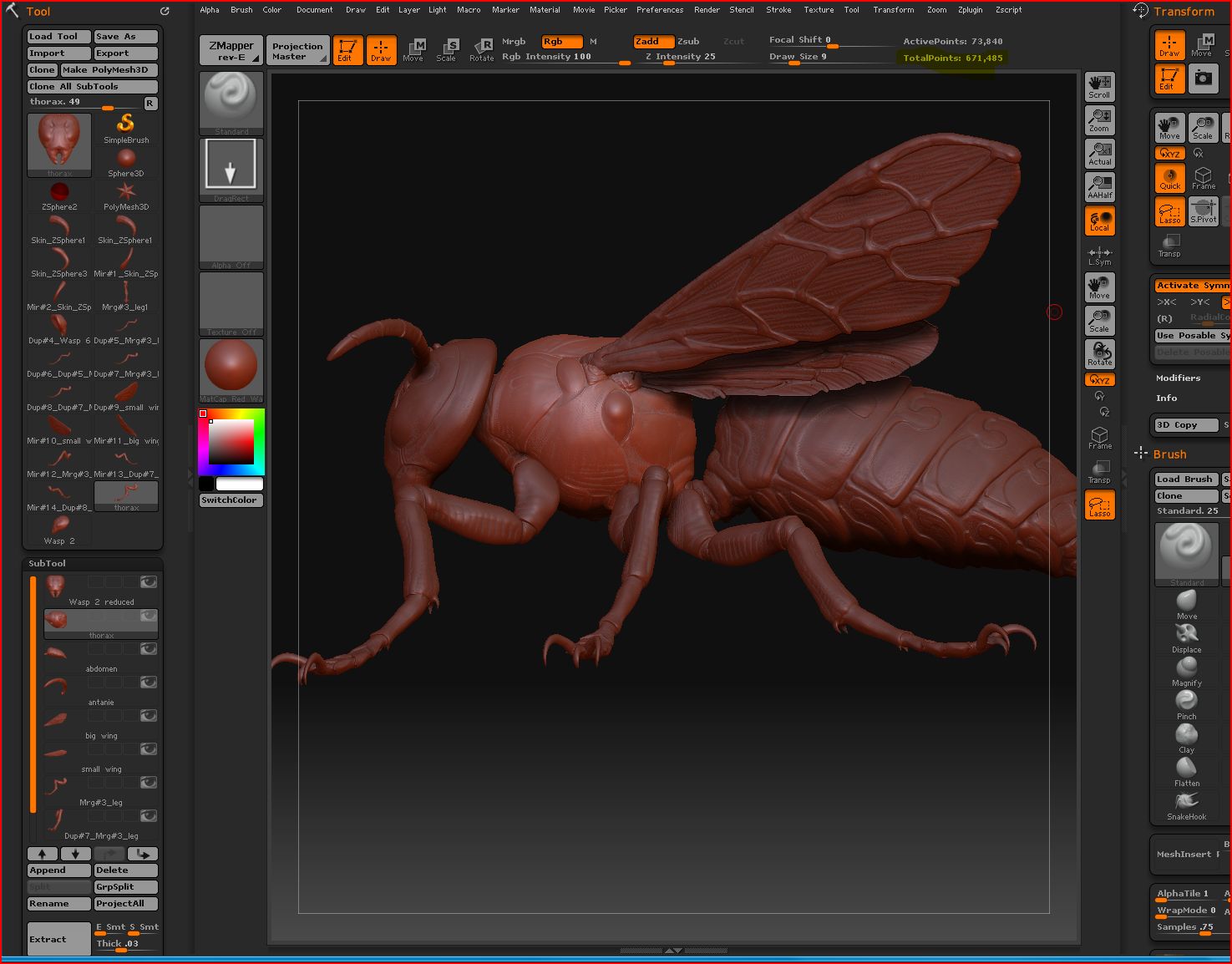

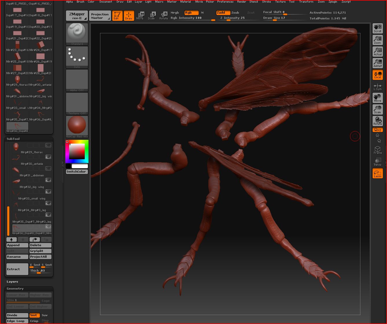

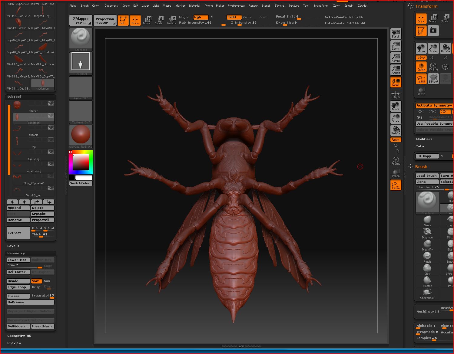

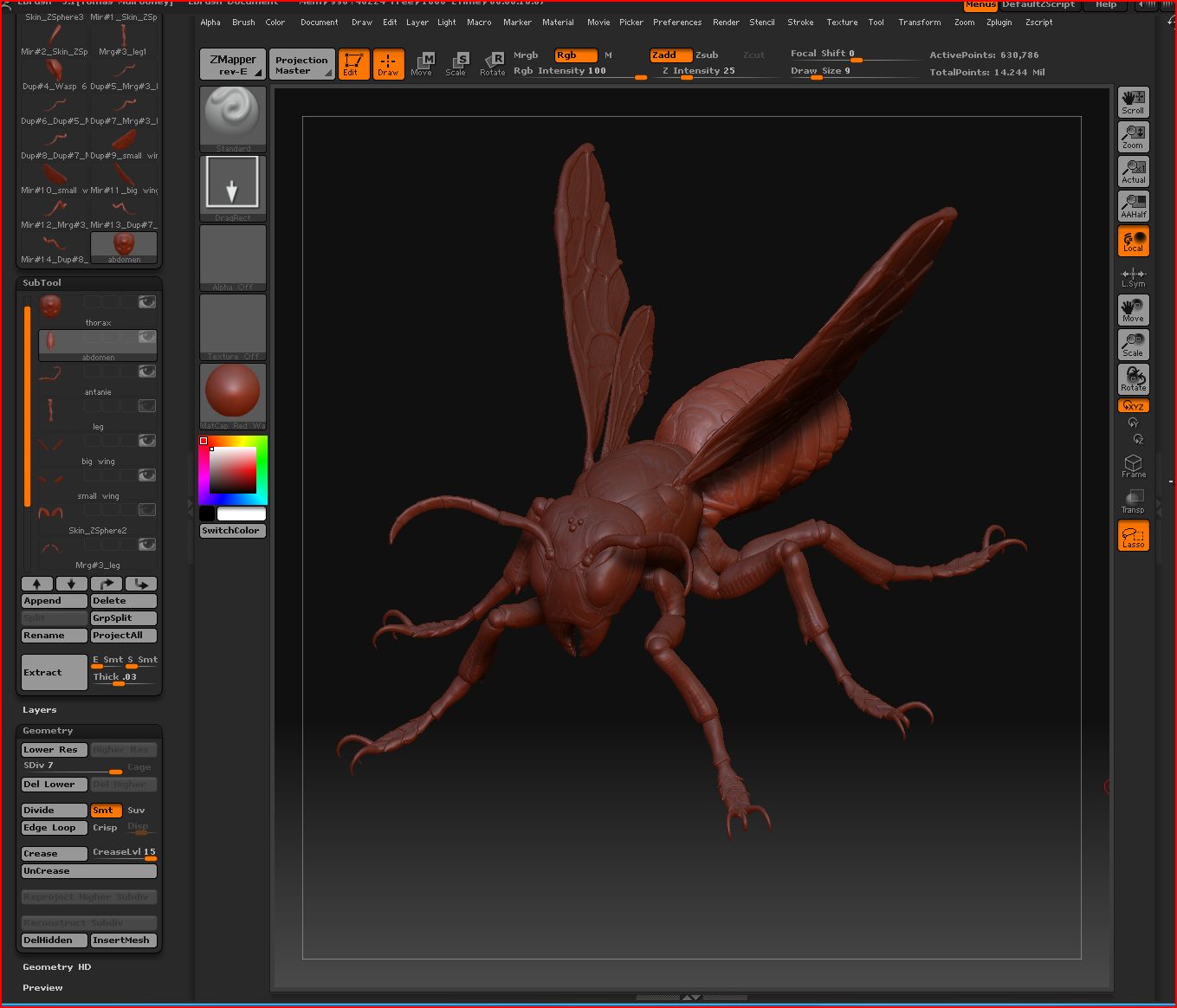

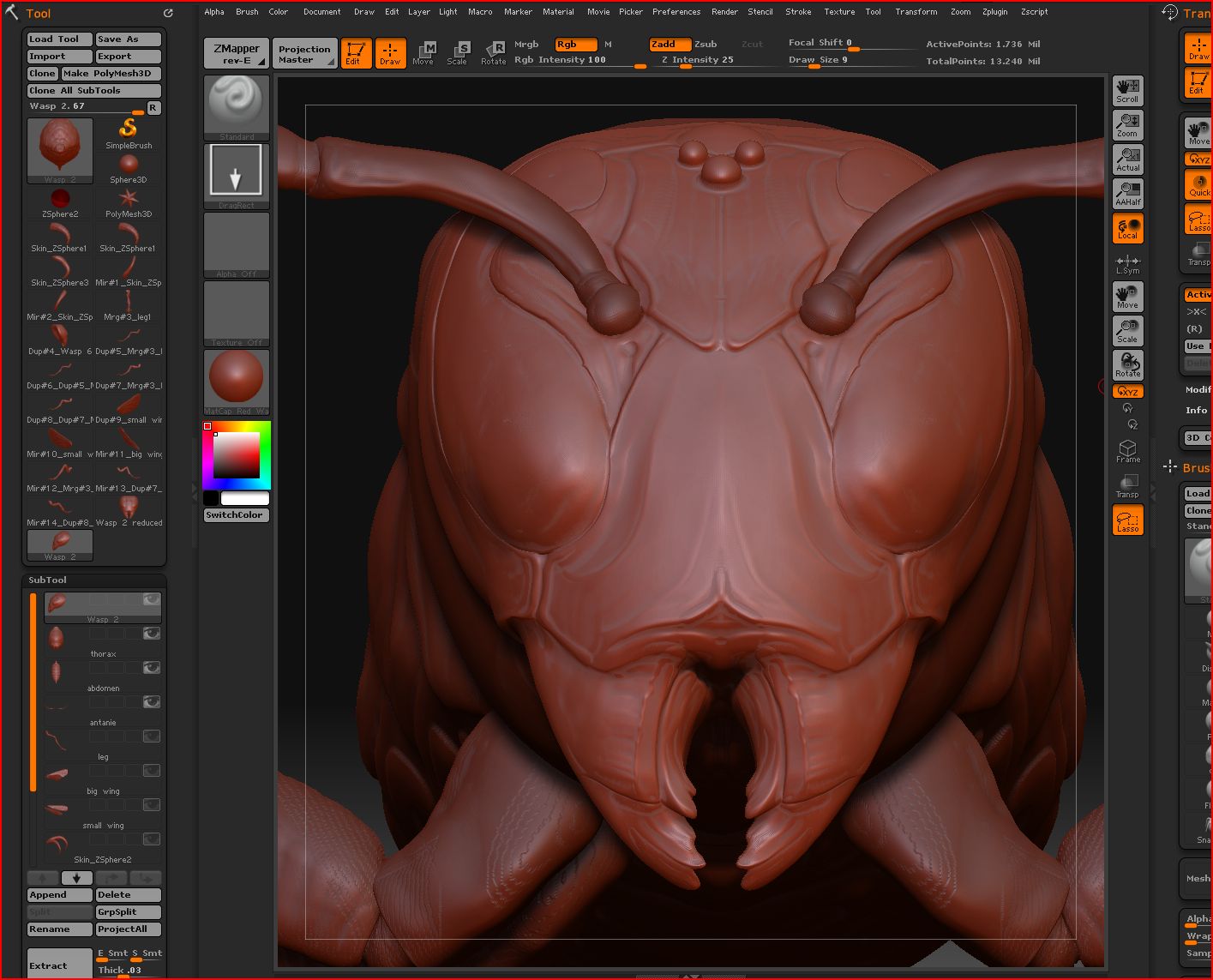

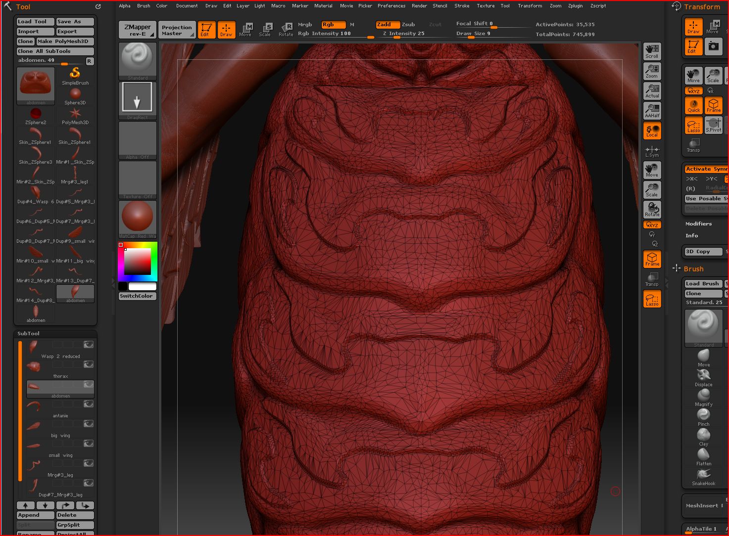

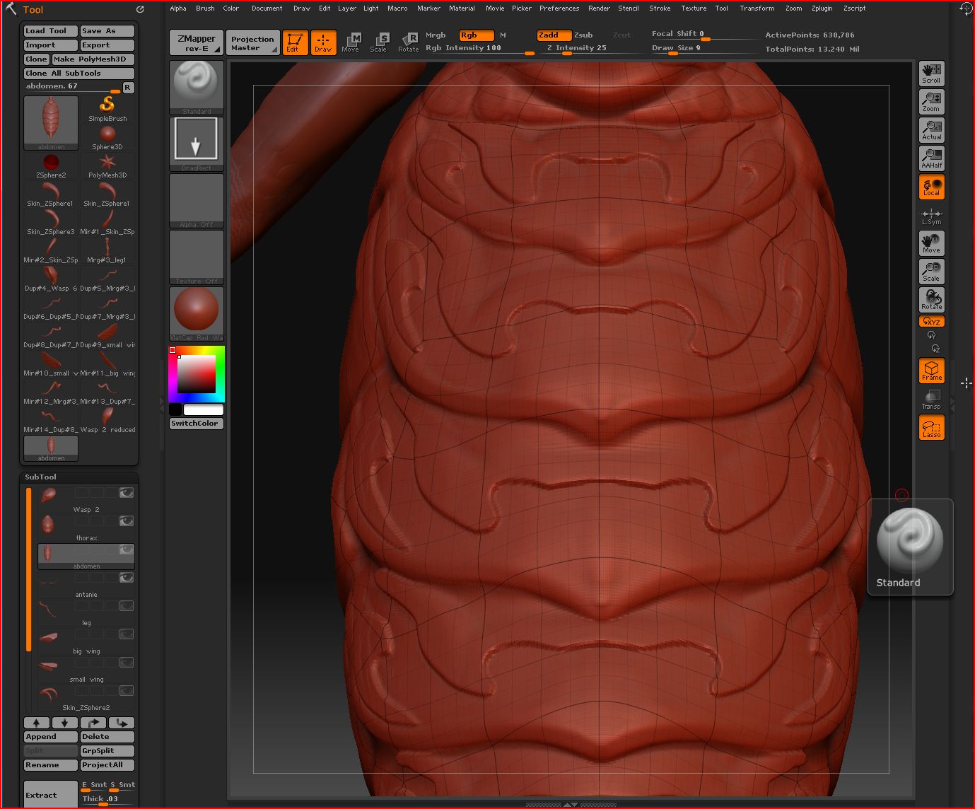

here are a few projects in process steps.
I’ll dig up a few others tonight or tomorow.
wasp-
the base model was 13,000,000 +
the reduction was 700,000 +
1%20import%20blockup%20modo
2%20block%20up%20divided
3%20abdomen-big
4%20face
6%20threeqtr%20-%20big
7%20side%20-%20big
8%20top%20-%20big
9%20bottom%20-%20big
10%20wasp%20reduced
11%20abdomen-reduced
12%20face%20reduced
13%20face%20frame%20reduced
14%20limb%20tabs%20setup
15%20magics%20top
16%20magics%20limb%20key%20tabs
17%20magics%20key%20holes

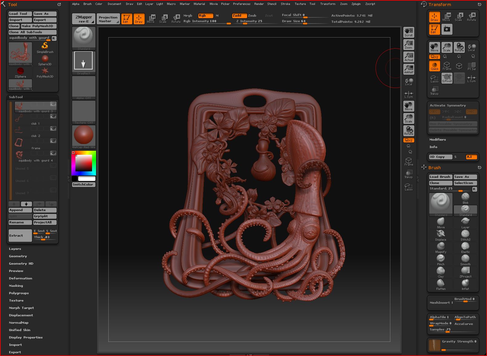

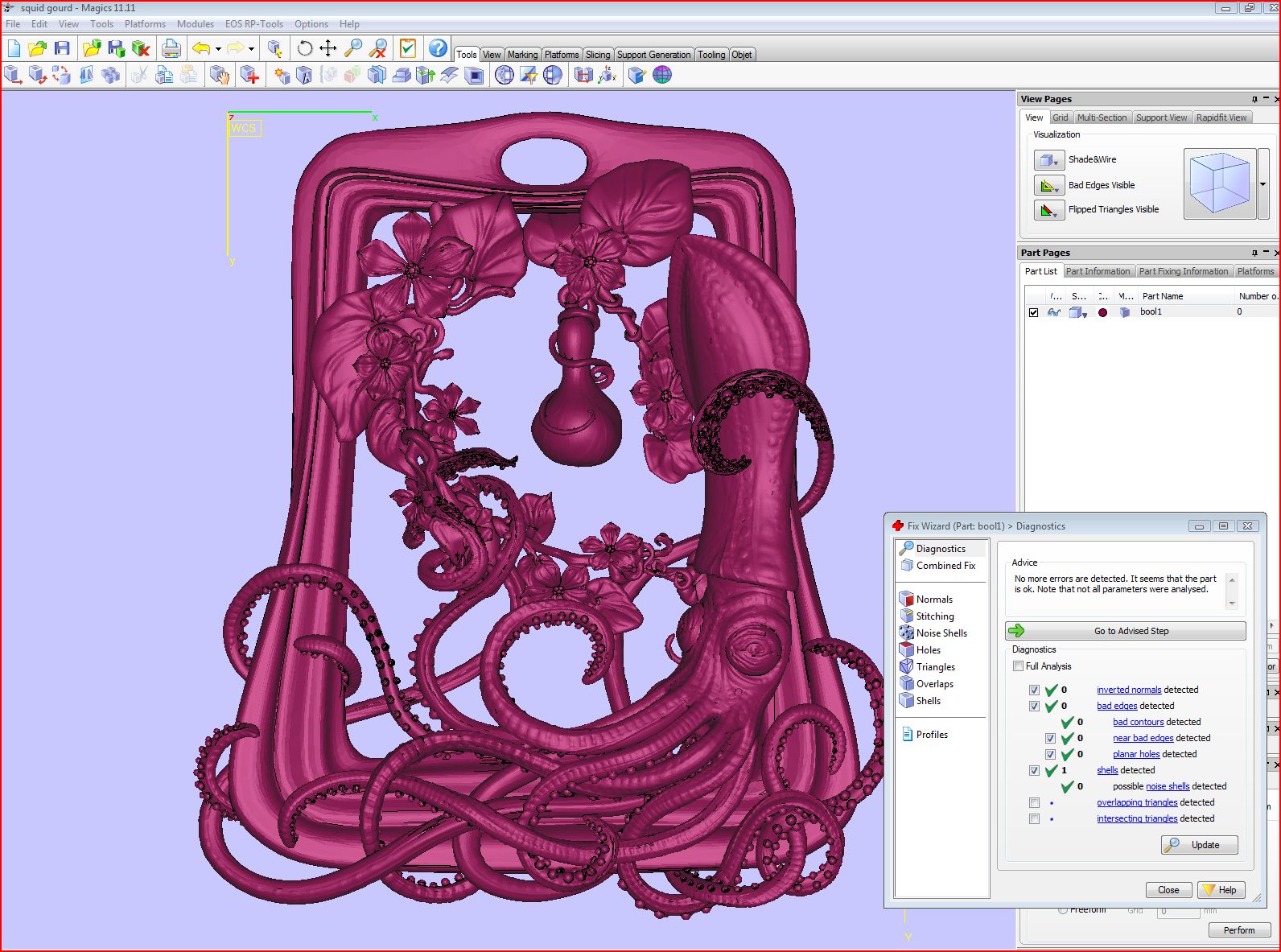

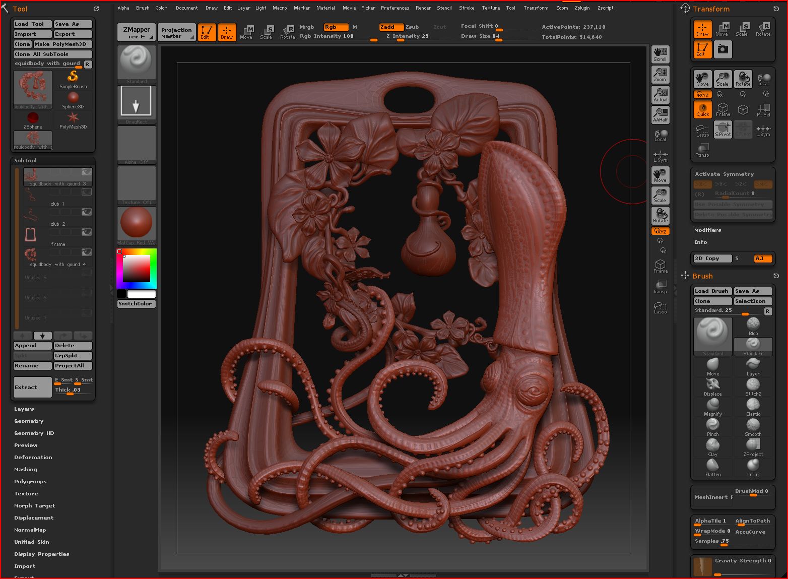

squid-
the base model was 9,000,000 +
the reduction was 500,000 +
and then the shell in magics.
1%20squid-%20front
3%20squid-%20front-reduced
4%20shell%20squid
squid-front

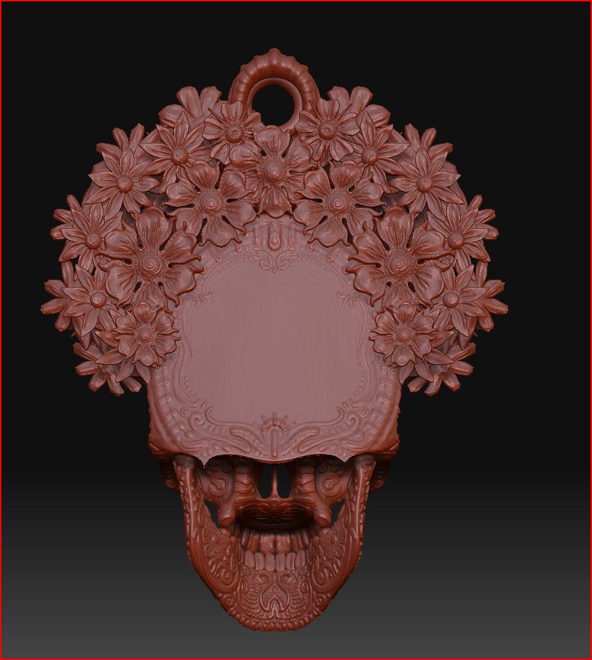

some other parts…

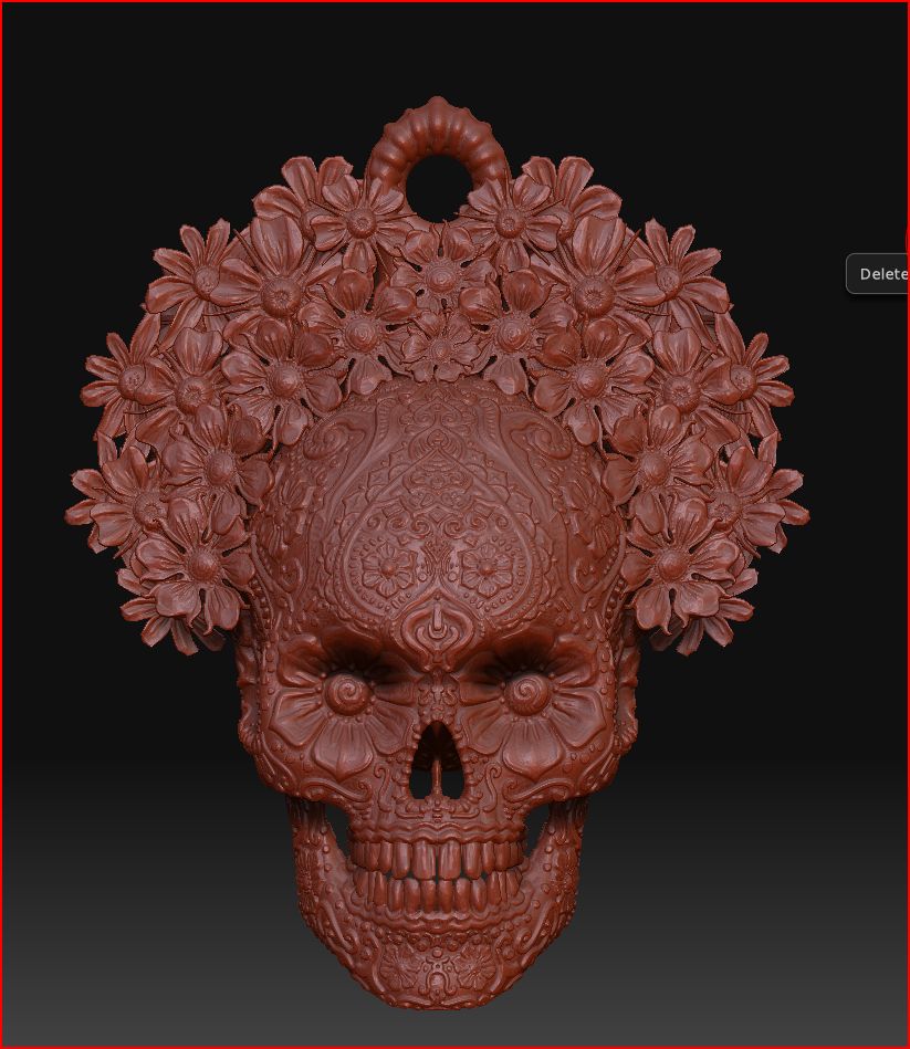

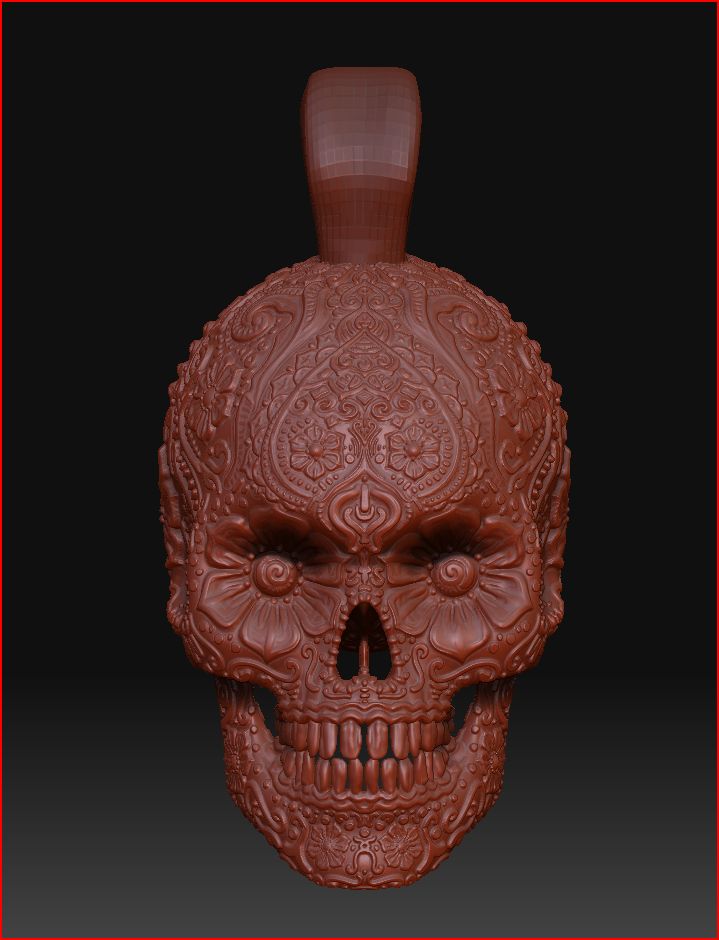

now you may think there is some redundancy but remember I’m designing a line of jewelry so I answer requests. so be kind lol the suger skull sells lmao.
I’ll post the pics of the pieces in silver as soon as i take pics of them.
maya%201
ff%20flat%20back%20front
ff%20flat%20back%20back
ss%20fcrown%20front
ss%20fcrown%20back

firstly sorry, those are some big screen caps.
