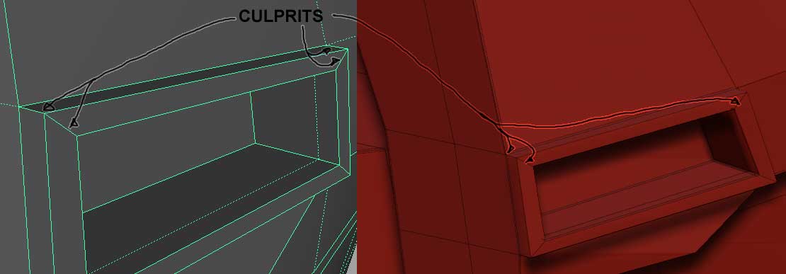

I’m working on a vent (attached obj) and in Maya i can freely import and export the obj and all of my soft/hard edges stay correct.
However when I try import this into zBrush with your plugin, MOST if it is fine, but the corners of the square openings in the sides dont crease, and what should be nice square openings end up round.
Theres also some wierdness in the inset groove near the bottom that i cant really describe…
side_vent.zip (12.8 KB)
The problem is that you haven’t defined enough smoothing groups for ZBrush. I’m not that familiar with how Maya handles smoothing but the plugin works in basically the same way as creasing polygroups in ZBrush: a group is isolated and its edges are creased. So if you want a crisp crease at a corner you have to make sure you have at least two smoothing groups so that there’s a crease at the change in direction.
There are two things you can do:
  1. Define more smoothing groups in Maya.
  2. For areas you want hard creasing in ZBrush, hide everything but the area and then Shift+click the crease button. This will crease all the edges of all the polys.
I’ve added more groups to your model to keep the vents square (but I dare say the insides don’t smooth as you wish!).
ok, the file you just sent me does exactly what i wanted.
I have a sneaking suspicion the fault lies in the way maya takes its ā€œsoft/hard edgeā€ approach and tries to export it into smoothing groups. As you said it clearly doesnt contain enough smoothing groups, but thats something maya doesnt give me any control over, whatever algorithm they’ve used to compute the groups clearly isnt up to snuff, because i’ve found lots of little areas where this is happening in corners.

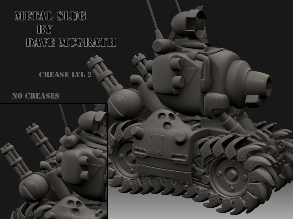

As promised :slight_smile:
It took a bit longer than it should have, but I’ve never used 3DS, and I’ve never used zBrush for anything but squishing spheres for fun, so this has been a monumental learning curve.
Now it’s time to actually sculpt and texture this thing!
Wow, that’s great! Post it in the main forum when you’re ready to, with a few words of how you did it. I think it will be popular.
