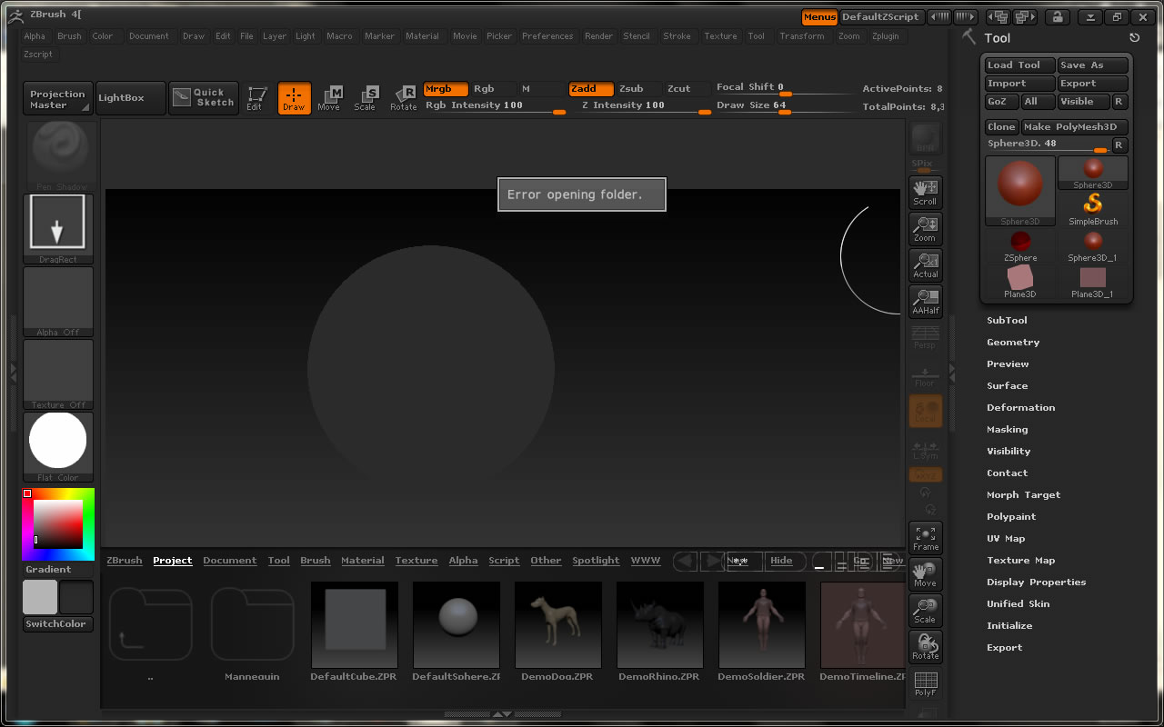

I'm totaly noob! :roll_eyes: I do all like you say instaling ZSculpy tool for Zbrus 4, and whenever i want to make polimash or something else it say for me "Error opening file".
I check everything from previus treats and this don’t work for me. I’m on Windows 7. With this error i can’t learn more and this is very confusing :grimacing: for me. Please help me, Tnx.error.jpg
Sandra, I’m assuming by “Zsculpty Tool” you mean one of the plug-ins. Its important to use the correct terminology to avoid confusion, since meshes in Zbrush are often referred to as “tools”. I believe this is because before you hit the “make polymesh 3d” button and convert them, they are tools for drawing on the 2.5d canvas.
Which zsculpty plug-in are you using? The one from Zbrush Central authored by Marcus or the older one from the Shiny Life website?
