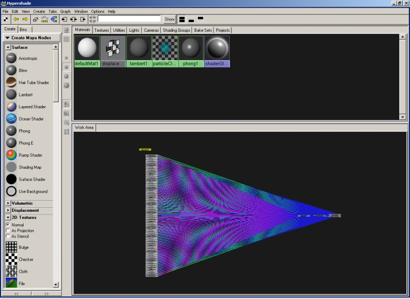

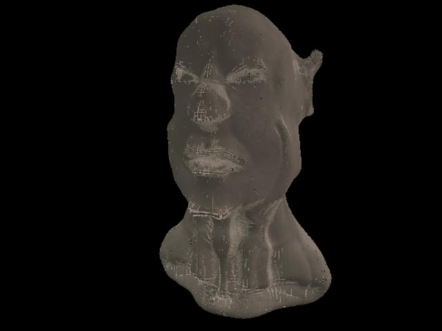

However I got… ehm, a few problems… Is it the UV-coordinate or something, that´s causing this problem?
that is an interesting render…
can you post a screenshot of your mental ray shading network or post some details on it?
S
Sorry, i´m not sure what you mean with mental ray shading network(i´m new to Maya so i´m a bit confused
However I looked at the hypershader graph again, and it looks pretty… ehm, strange.
Hmm I would reccomend trying the 32bit workflow in the Zpipeline guide that is linked in my signature. This makes a much more accurate map and the process is a little easier than 16 bit.
