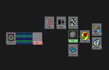

I have been doing some experiements wth using multiple displacement maps on a single object which requires that you keep the alpha offset value open or find a new way to feed maps into a shading node.
Below is a screenshot of the very simple network I am using and the zip file of the shader itself. The test render I got is identical to the previous expression method of offseting the values for the map so it looks promising.
Please feel free to add to this network and post here if you like.

I came up with it playing with the problem in the hypershade. I was vastly influenced by other members on this forum tho as well as the HyperReal Facial Rigging materials from Alias so I cannot claim sole authorship. Im trying to determine how to blend 2 maps now. I am using a plusMinusAverage node on the outputs of the set range node…

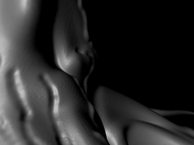

I’m using the grey scale map from Zbrush in maya mental ray, with the settings outlined in the tutorial and I’m getting stepped displacement.
for example, notice the lines. These were not painted in and in Zbrush it looks smooth.
[attach=13808]steps6do.jpg[/attach]
Check the filter you have on your file node. It may be set to Quadratic. Try turning this off. I also saw a similar artifact when I converted my maps to 16bit RGB using Fcheck instead of Photoshop… It may be an issue with the conversion. If the filter dosent help try reconverting in Photoshop making sure that color managment is off and you save it as an RGB tiff file.
Scott
so this was the displacement map that I exported from Zbrush that is doing this. I turned filtering off, but it’s still doing it. I converted the tiff to 16 bits in photoshop, with color management off, and I’m still getting this stepped pattern.
in my setting for Zbrush I had Adaptive and Mode turned on.
perhaps its important to note that my image is 1024 by 1024, should it be higher?
