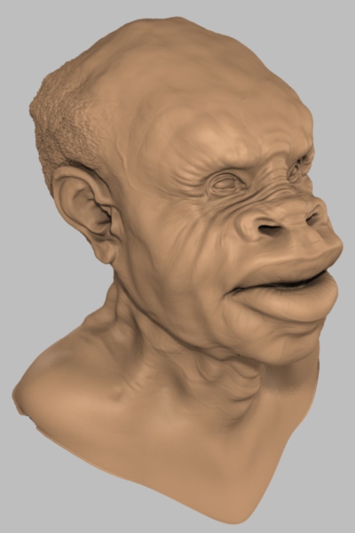

This is my attempt in blender:
Blender doesn’t (in 2.46) read 16 bit tif imagea but handles up to 32bit openEXR images. So here is how i made this:
  1. Used the displacement map in zbrush to create a 5.5Mil poly detailed head.
  2. Used Multi Displacement Mapper 3 with standard D32 export settings to generate a 32bit tif.
  3. Changed the file format from tif to exr using photoshop and the proEXR plugin keeping it in 32bit and using zip16 compression.
  4. In blender loaded the low res obj and sub-divided it to level 5.
  5. Applied a displacement modifier with mid-level 0.5 and strength 5.5 using the 32bit exr displacment texture I created. (learned later than model should be scaledx4 in blender edit mode and strength set to half of alpha displacement value to get exact matching)
  6. Rendered in internal renderer with ao.

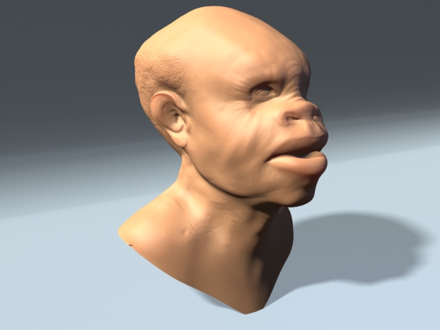

This was in vray-max, i tried to get it to work in mental ray-maya but no joy, i followed every instruction, i really am baffeld mmm:grimacing: . Thanks for all the info, pixolator and scott spencer, you both rock!!1.jpg

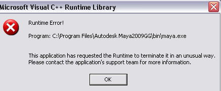

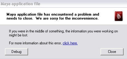

I went through all the steps in trying to apply the displacement map on the Head, but maya crashed on me. Error reading about Runtime
Using Maya 2009 32 bit PC
Nividia Graphics Card
Windows XP
Pentium 4 3.20GHZ 2 GB RAM
error
error02
