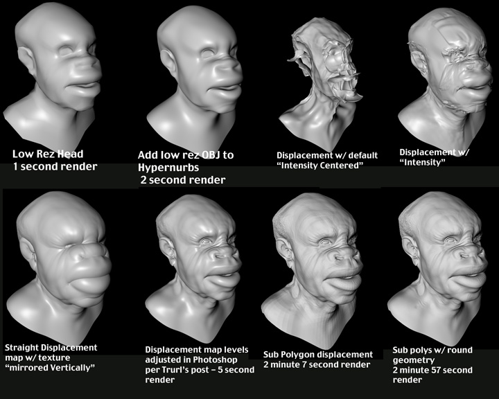

Rendering ZBrush Displacement-Maps In External Renderers (May 9th: 2nd file added)
For info on the settings: http://www.microcan.nl/forum/viewtopic.php?t=6DispTestHead.jpgZSwordDispTest.jpg

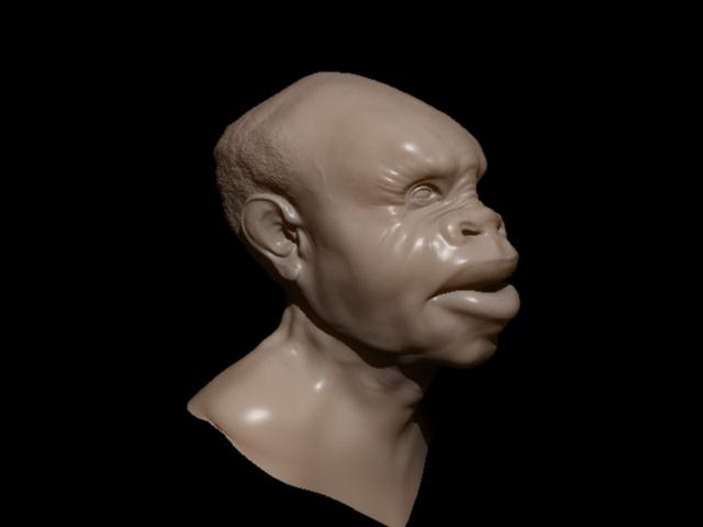

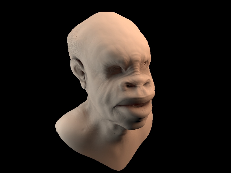

Here’s my test using Cinema 4D 9.5 and following Trurl’s directions in his post. There are a few differences in 9.5 from the version 6 he is using I guess.
Cinema%204D%20head%20test

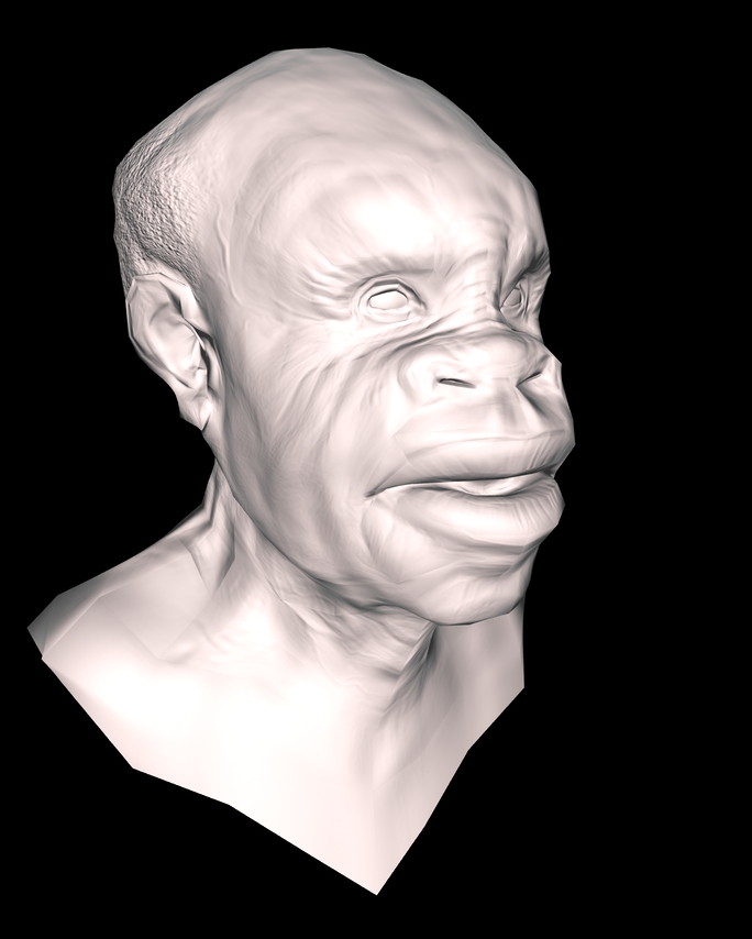

Heres a render test done in Lightwave 8.5
P4 3ghz 2gb ram
36.8 sec
1.7 million polys (subD render level=25)
texture mipmap = off
texture pixel blur = on (this was required to stop creasing I beleive was introduced due to the non contiguous UV’s - just a guess. It didn’t seem to affect detail however)
1280x960 5-pass Low Antialiasing
default light no shadows
This was done using an alternate version of NormalDisplace plugin and a 16bit tiff loader plugin both found here http://lynx.aspect-design.de/plugins/normal_displace_info.htm

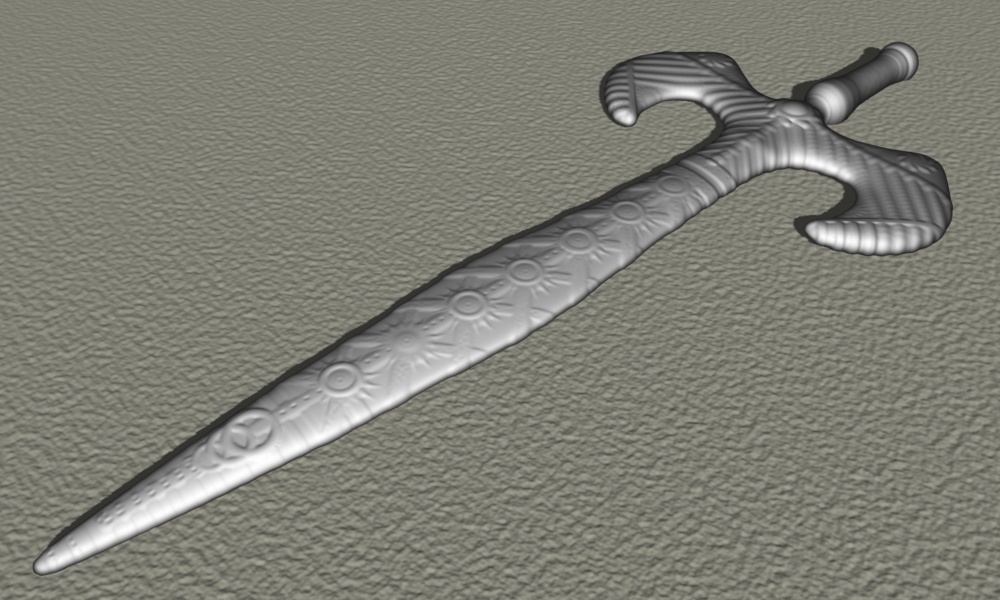

Rendered in Carrara Pro 5.1. An amplitude of 12 was used for the displacement and a smooth rendering of 4 was used on the polygon model.

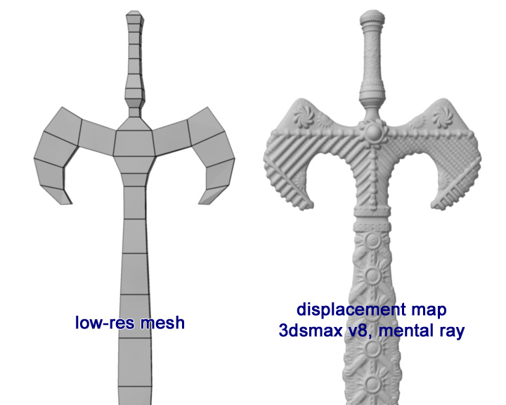

My render with gelato and gelobj
sword

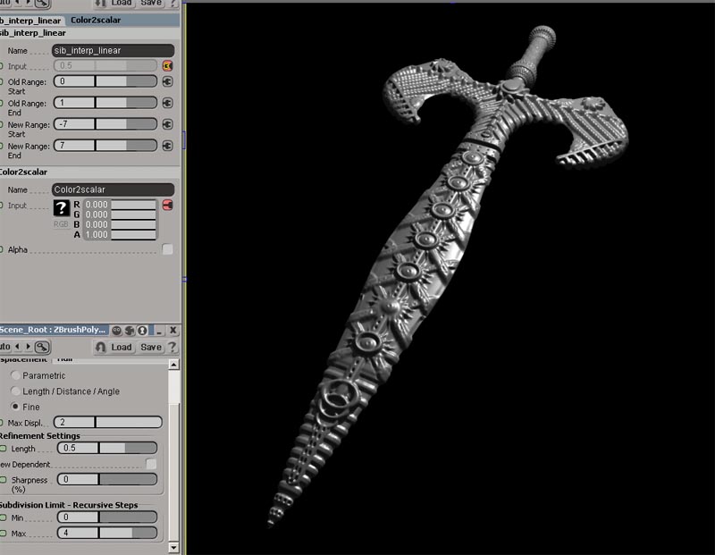

this is my first try for few mins during the class ( oops :stuck_out_tongue: )
for description :
im using Xsi 5.11,
Im doing a little bit tweaking from deffault rendertree (generated for displacement if you load up the disp map at the first time)
I cranked up the new start and end range ten time (maybe hundreed time i forgot :D)
and max disp into 2, sometimes I tried more than 2 it doesnt change anything
lemme know if this sword suppoesed to have more detail.
ps : im not usually
using fine displacement
usually using angle disp, it render faster, but it also create seam prob
http://archive.zbrushcentral.com/zbc/attachment.php?attachmentid=40246&stc=1
