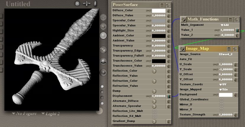

Don’t know if anyone has posted this combination yet:
Poser 5/OS X, GUV export.
Note that you can load the 16 bit TIFF directly in P5’s material room, what’s needed is a math node to substract 0.5 form the displacement.

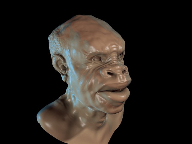

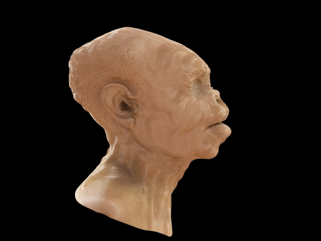

Software : 3DS Max 7 + Mental Ray
Shader : SSS Fast Skin Material
Rendering Time : 0:03:05

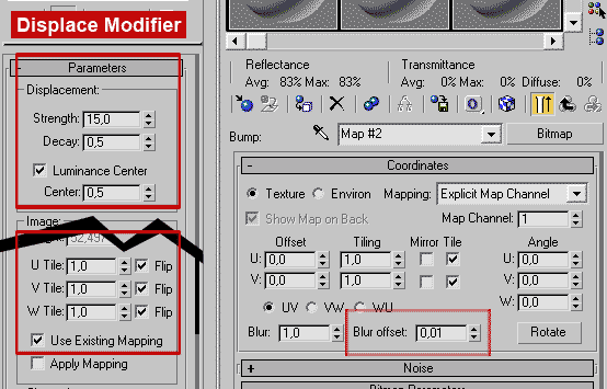

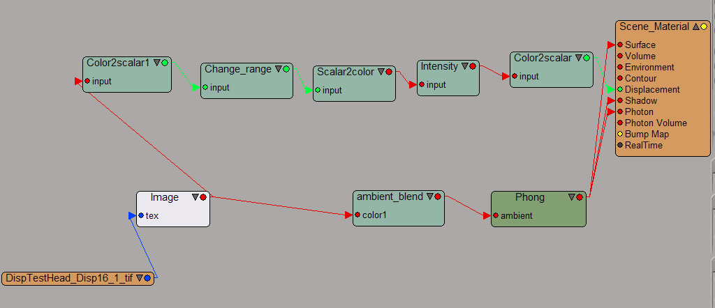

based on the tutorial by mangriff.(thx;))
the settings are similar, with the exception of keeping the default map uv-tiling values.
Fingerman, could you post your settings for the material and for mental ray displacement? I’m dying for getting those results…
here is my test…
i am quite satisfied since it took me ages to figure out how to do it…but thanks to my teacher gattomanzo, my boy drummer and a fellow italian zbrush user smilegrafix (grazie a tutti!), the dirty work was finally done.
i converted the texture in photoshop to rgb 16 bit, and although some say that 16 bit doesn’t work, to me it seems fine.
here is a picture of the rendering and my render tree. i increased my alpha to 4,834 (from a starting value of 0,834).
for the rest on my change range i put 1, 0, -1, 1.
if anyone who uses xsi needs more explainations i’d be glad to help

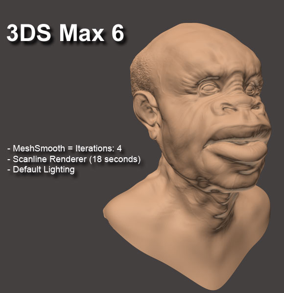

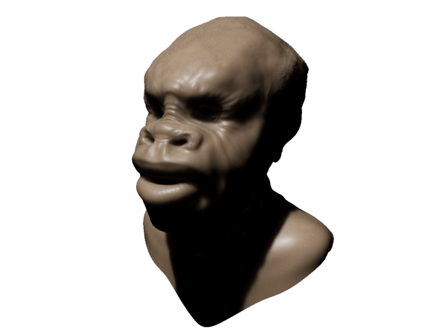

For those of you using 3ds Max I found that with a standard Displace modifier and a Turbo Smooth at 4 render iterations the Scanline renderer rendered the fastest with 11 secs, Mental Ray with 22 secs and Vray with 27 secs (vray took longer than 27 secs with a Turbo Smooth at 2 and a Vray Displacement Mod achieving a slightly lower quality render, Vray mod uses adaptive Subs achieving more detail but not completely smoothing the basic mesh). All renderers were default settings at 640x480 on an athlon 2500 with 1gb ram.

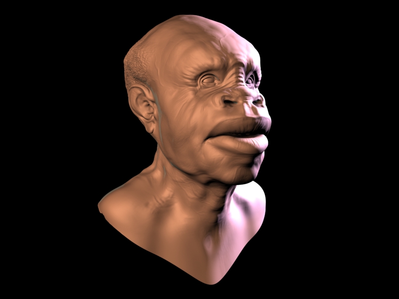

1:11sec to render in Mental Ray with Skin shader and one light. Mesh with Turbo Smooth 4 render iterations and Displace mod.

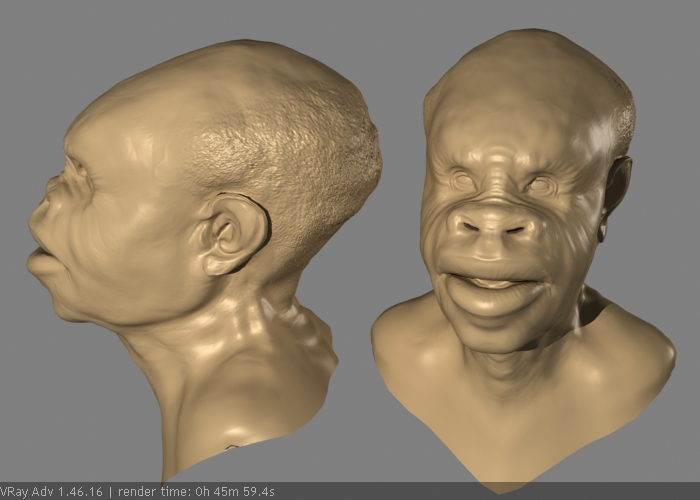

Rendered with VRay and PPT, 5000 subdivs, 2 raytraced lights, GI.
The small grips on the shoulders can be fixed if subdivs are increased to 10000 and leave it to calculate some more minutes. Here is a test /head45/ where I left it while I was on lunch.

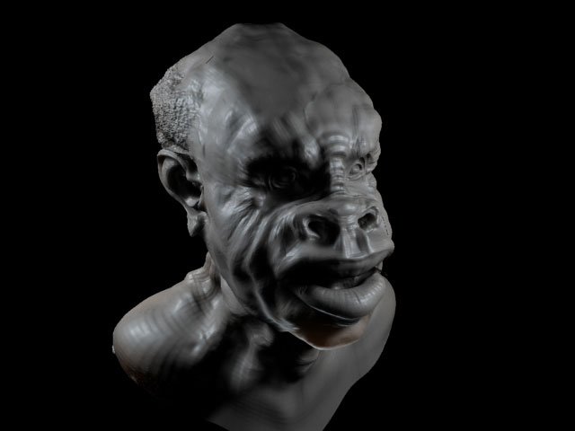

I just tried it in Max with MR, and altough its slow and uber memory expensive, the results are very cool, I just wished the MR

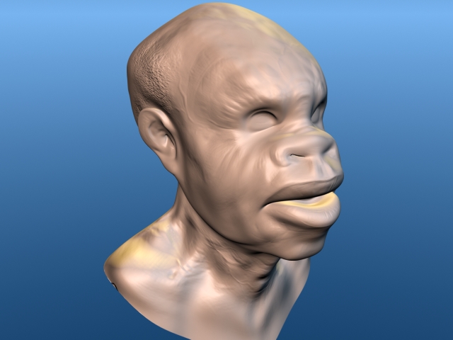

Needed to test how I shall configure exported displacement maps from Zbrush, this is the resault.

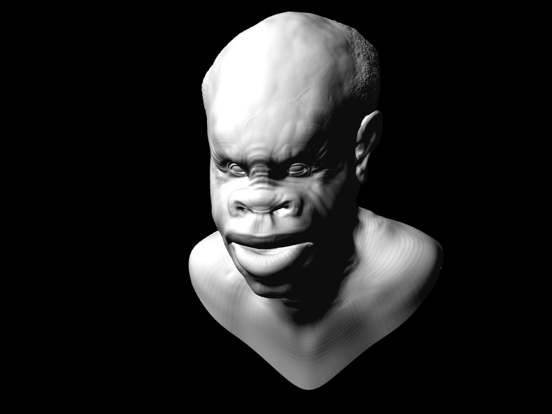

Vray for render
