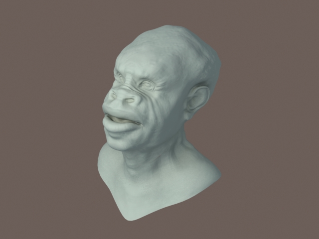

Hi Everyone. This was a quickish test done with the new Rio version of Brazil RS for Max 6. Having problems with the hair and high frequency detail in the flesh although I can’t tell so far if people are using bumps for that. Sorry the pic isn’t a bit bigger but those are the limitations of the demo.
If anyone is still reading this thread and wants to see an extreme close up then reply and I’ll upload one with all the stats etc.

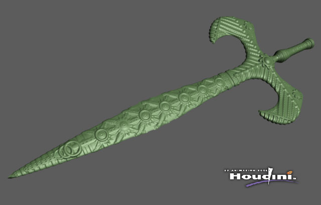

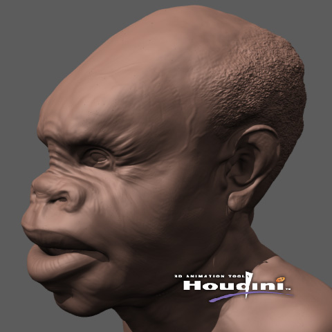

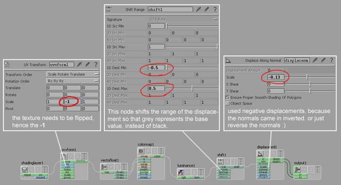

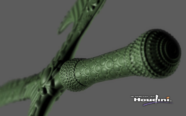

Houdini Apprentice 6
Import obj file. As one previous Houdini user pointed out, the file extension must be in lower case so rename it from OBJ to obj.
Scale the model down to about 1/100th of it’s original size to avoid shadow bias problems.
Apply the shader and set the model to ‘Render As Subdivison Surfaces’ in the object render parameters. You can also set the displace boound and turn up the shading quality if desired.

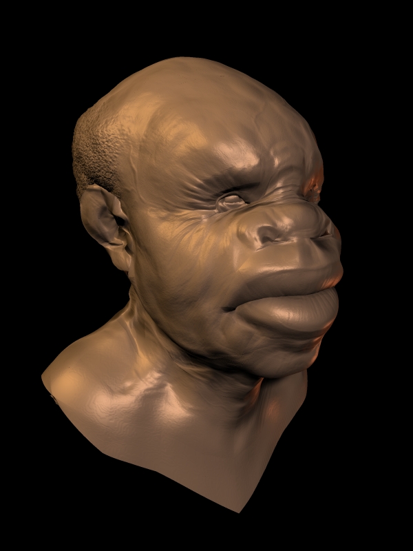

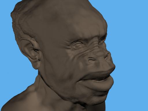

Photoshop
I opend the texture file in Photoshop - under image i used Auto contrast to bring the value to black and white
change the mode to RGB and save as to a new texture file
now you have the option to flip it or do it in maya , I just done it in maya
Maya
import the Obj
Rotate it 90 on the X
in the hyper shader apply a new texture and use the displacment mamp that you just created (the RGB one MR will give an error if you use the orginal one)
in the color balance of the texture file I used the following
Alpha gain 1.670
Alpha offset -0.865
As for the object
get the Att Editor and under displacment map
turn of feature displacment
and under tesselation make it 4

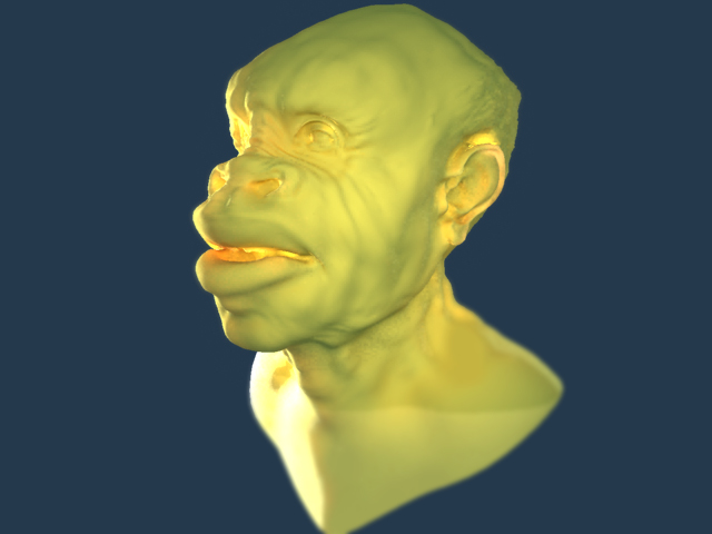

i took it a littel bet further and used SSS shader and htats what i got
head_test_SS
