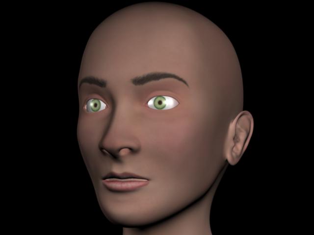

By the way I was having a little diferent problem, the mesh displacement was ok, but when I put some texture in it I lose a lot of information in some parts of the model, I realized that it was a problem with the suddiv approximation because if I set the number of subdivitions to 2 or let it to 1, the texture render better, but I lose detail, and if I use Spatial instead of Parametrical, I didn’t get the detail what I wanted… then, I found this little piece of script, and with some scepticism, I tried it, and it works!!! Now my model looks nice, thanks!
Bellow are both renders, for you can see the differences.
[attach=92993]girldispparametric.jpg[/attach]
[attach=92994]girlOK.jpg[/attach]
