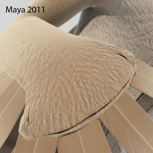

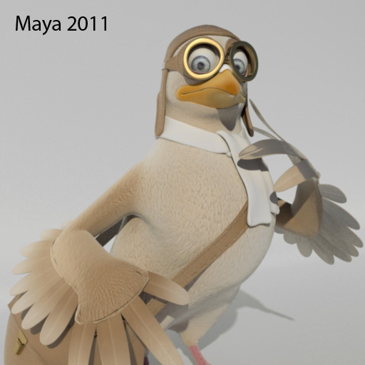

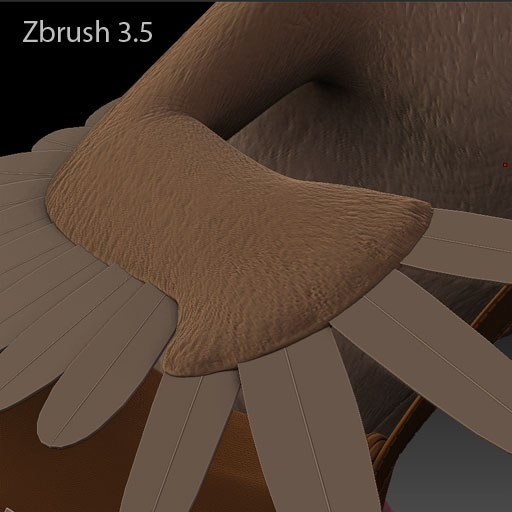

Even though I’ve been using zbrush for many years, I don’t use it on a regular basis and need some assistance with a uv seam problem. I’m using zbrush 3.5 (first time) and have tried to solve the problem in both Maya 2009 and 2011. When I export my mesh (level 1) from zbush as a .ma with my displacement and color map, the uv’s gets messed up. The uv’s look fine at first glance, but zbrush un-stich them into many small shells. When I render the model with these un-stiched uv’s (default), I get no seams, but the displacement looks ugly/bulky where the uv borders are. To solve this problem, I manually re stiched my uv’s in Maya again, but now I get large uv seams/cracks! I’ve tried both adaptive and DPSubPix displacement, but ended up with the latter one and have tried the Mrg button in the export section, but still has the same problem! This project has a very tight deadline so please help.

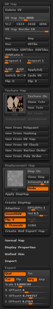

It sounds like you have forgotten to turn off “grp” and turn on “mrg” in the export submenu under tool.

Thanks for quick reply. New features are always buggy and the export as .ma feature in zbrush 3.5 is no exception! I’ve already tried exporting my mesh as .obj in order to keep my uv’s stitched and it works, but it does still not solve my problem. Yes, I might get away with only using a bump map and then use a blend shape to correct the mesh where the displacement was very strong, but will then also lose a whole lot of details on the legs etc…

yes merging uvs in maya will fix the uv seam issue, but the issue still remains with the map generation which is why you need to bring the new uvs into the mesh or use it to rebuild.
I’ve checked my mesh and its uv´s for faults several times. I’ve re-merged my uv´s in Maya when using the buggy .ma export method in zbrush and have imported these “new” uv´s back into Zbrush before exporting my displacement. Other suggestions are appreciated? I hope I’ve missed something obvious that can easily be fixed.

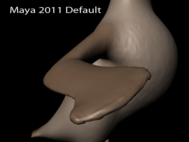

I have an issue with a displacement in Maya I have tried the file in 2010 and 2011. It does not render at all , screen comes up black. The other nodes in the scene do come out with their displacements in tact however one object doesn’t. I use the zbrush 3.2 and work off of a mac book pro.
I have rendered several scenes with mental ray and have never had this problem. I have tried switching the morph target on the original mesh and other thngs like exporting a .ma file all with the same results. The wierd thing is the displacement shows up fine if I choose high quality render in the perspective port. Any body else ever had a problem with this?
use polygon cleanup to fix non manifold edges in maya,and it will render.

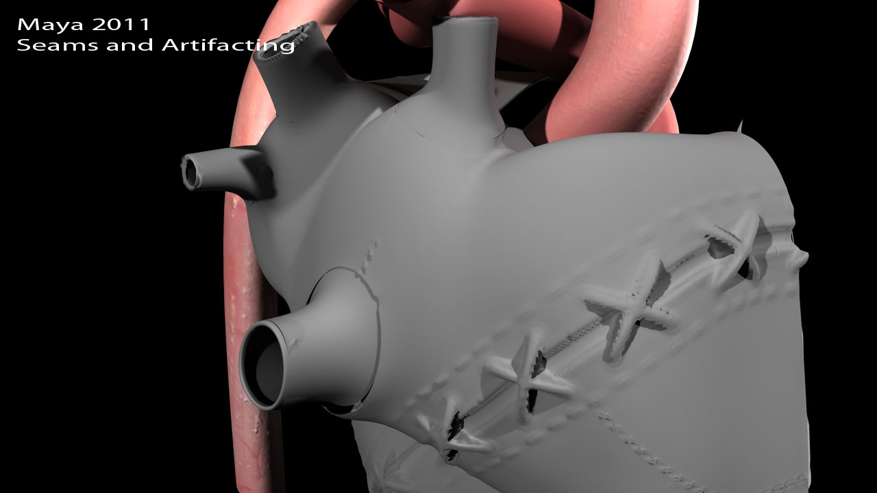

Hello,
I am running Maya 2011 / Zbrush 3.5R3
64x system 24G ram

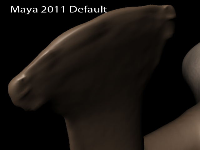

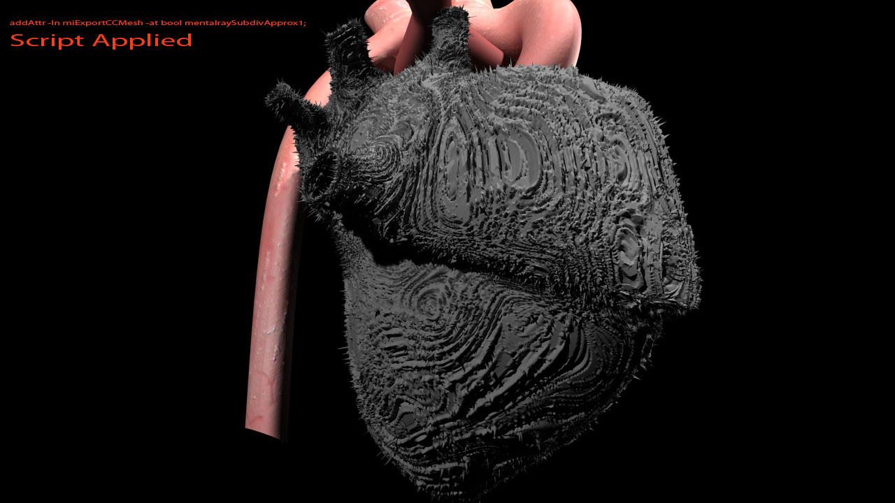

I’ve read the above issues and solutions, I have applied all the settings and tried all the solutions Im still getting seams.
Is there yet a fix to this issue?
The closest I got was a hard Zbrush → Maya2011 Export, smoothing the mesh. But still not perfect…

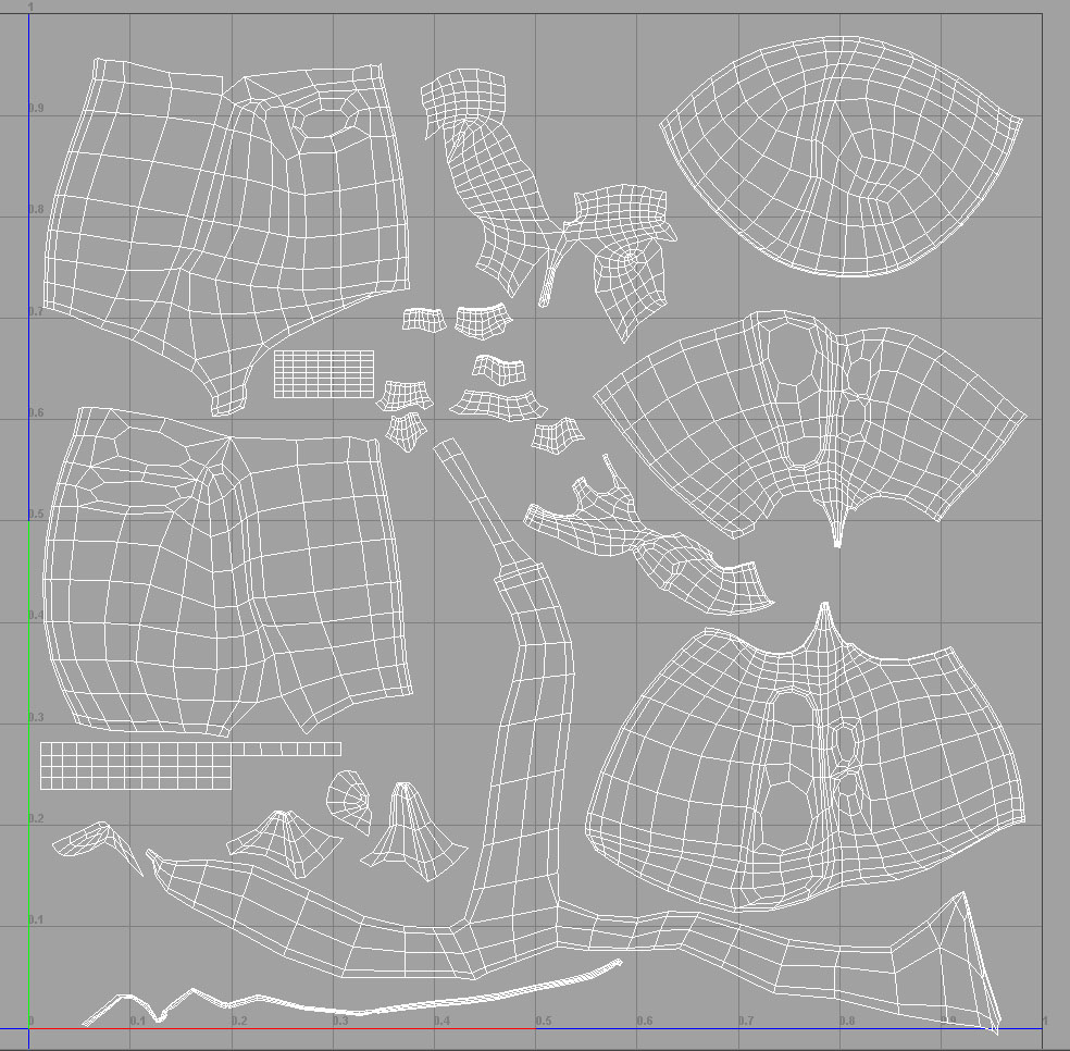

Also… Does the edge artifacts prove that my UV’s are too thin?
If anyone can steer me into a good direction please do… I used to have NO problems before maya 2010
Thank you!
If you want more displacement add more subdivisions in the approx. editor. As for the weird spike artifact, check your displacement map especially where the seams are… could have some unwanted whites in there. I hope that helps at bit.

1.First correct your uv layout, looks like you have some uvs outside 0-1 and overlapping. Also the actual layout looks totally wrong, spend more time optimizing the space and the uv to poly ratio.
2.I would then suggest totally checking your mesh twice for any nasty geo.
3.Now export that clean mesh out of maya, then bring it back in and re-apply your shader and create a new approx node. (This is a maya related step, I have personally had meshes not render properly simply because there was a problem with the nodes in maya, exporting out then in again will solve this.)
  1. Apply the disp as a bump, does it work? (of course re-create with better uvs first).
Use a higher mesh to render with
here is a list of values i use for the min and max of the approx node
2,3
3,5
4,6
make sure you are using a subdivision apporx not disp.
Change the approx to spatial at least, parametric is too simple.
Make sure you understand that undercuts will not render out.
Use 32bit, but do not edit it, if you use 16bit increase the texture size.
The artifacting (spikes) in your render is from the bitdepth banding and values of the map getting crunched from too high settings in your file node.

Can someone please confirm or deny if the ccMesh smooth uv seams problem is still an issue with Maya 2011 and zBrush 4.
If so, does Scott’s ccMesh script work with Maya 2011?
