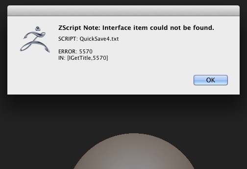

Just installed Zbrush 4R3 and I can not get Quicksave 4 to work. I keep getting this error popping up and then Fibermesh ā€˜Preview’ is activated. I have tried to install Quicksave5 again, but same thing happens. Anyone else having the same issues? I am on Mac OS X 10.7.3.SkƤrmavbild 2012-03-05 kl. 00.37.58.jpg
