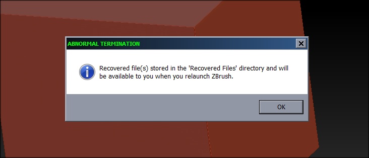

So far I have been able to repeat this every time.
  1. Select Cube3D, draw on canvas, enable Edit mode, Make Polymesh3D.
  2. Subdivide to level 4 then Ctrl+Z back so there are no SubD levels, then subdivide again. Crash!
It is because of the Undo History, because if you ā€˜Delete UH’ after you Ctrl+Z back to 0 SubD levels you can then subdivide again without it crashing.

I get this every time after I have Undo (Ctrl+Z) a couple of times then go to subdivide the mesh. Answer OK to error and it crashes to desktop. I hope this gets fixed in the next update.
Just did it twice in a row, once with sphere and once with cylinder. Same error.
