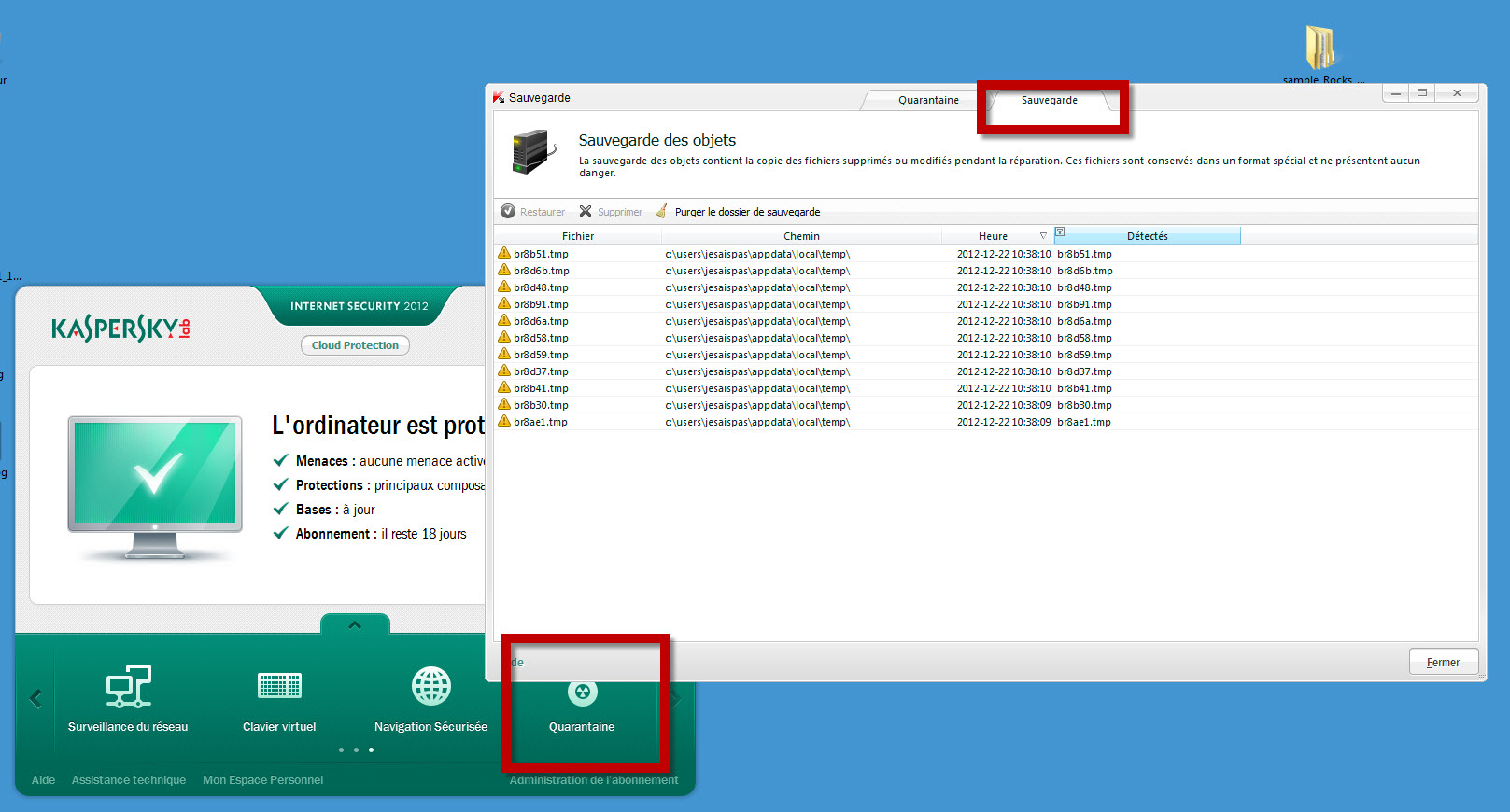

I got the same issue with Kaspersky, but it seems that when you restore the Z4R5 files once, after when you restart your computer it works. Be aware, ALL the Z4R5 have to be restore, otherwise GOZ won’t work. (Sorry it’s in French but I outlined the icons)

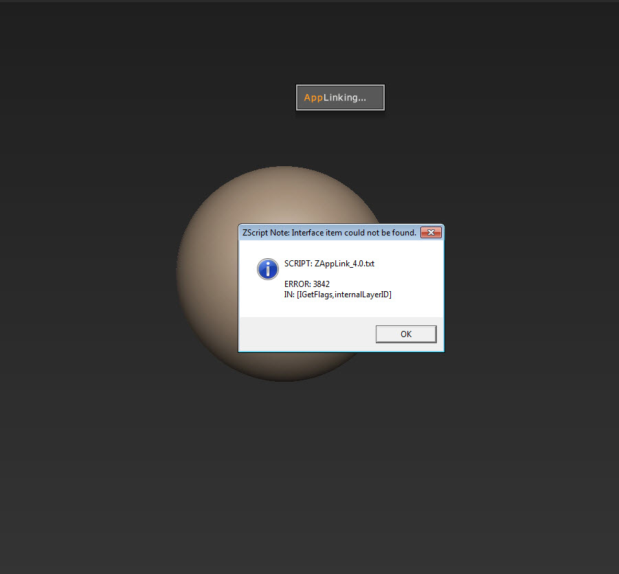

Another problem I get is ZAppLink, doesn’t seem to work. Anyone has ideas ? I use it a lot
You should try to create the ability to save a ZTL bin format too guys, because it could be good to be able to save a ZTL on th R5 and go back to the previous Z version in case this problem happens (ZApplink), hard to explain that when you are in production
Thanks :slight_smile:
The Zapplink issue has been identified. We will provide an update soon… but it will be at the beginning of January.

I am also experiencing issues with Zapplink on 4R5 and I am on a Mac running OSX. The issue is that the Plugin will not recognize there is a tool on the canvas when I select to store a view.
I will be looking forward to the plugin update.
