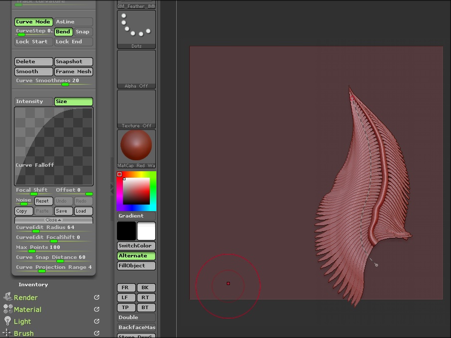

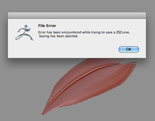

The Curve Modifier under the stroke menu, I cannot save this with a brush.
I tried to save it separate but I get an error. Anyone? Same problems?
I tried this using your feather brush. The ‘Curve Falloff’ did not save with the brush. If the ‘Curve Falloff’ not being saved with the brush is an oversight by the Pixologic developers…, only they can say. I was able to save and load the ‘Curve Falloff’ itself seperately without any errors but I don’t have any idea why you can’t.

Maybe a ‘Mac-bug’. I expected the curve should be saved with the brush. Can you make a curve and post it, so I can try to import it?
Or can you post the brush saved on your system?
I saved the brush with the altered curve falloff and the curve, Both are in the zip file. I’m on PC BTW.
feather brush change.zip (11.8 KB)feather brush change.zip (11.8 KB)
Here is what the curve should look like.

@ Zber2, thanks. Must be the system, there is no way to save the file here.

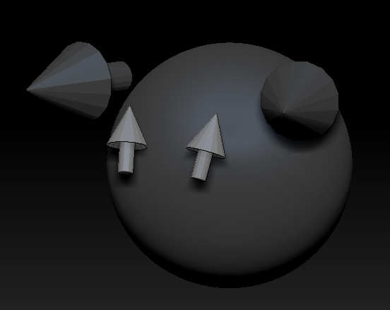

I’m having trouble getting my IMM brush’s multi meshes to be oriented correctly. When I draw these new brushes onto a surface (say a sphere) they are orientated facing to the side instead of pointing directly off the surface.
Here are two arrows that have been orientated traveling down the Z axis and the Y axis. For some reason the only way I could get the orientation correct was to import my objects in from Maya.
Anyone know what is going on here?
