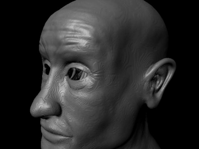

Here is my WIP Head…No Disp. map, just 2 million Polygons, and some minor detail… “Can there be such pain”? Hope you all like…:+1: :roll_eyes: :-1:…D…:wink:

I am trying the zbrush to maya… but when i do Create all… with the plugin then it asks me for a filename, and then it generates it… but the file is not created ?
I only get in my disk root 2 files called. Z-32.tif and Z-R32.tif both 48 mb but not the file i was asked for :confused:
Hmm when i try to render it with the Z-R32 file i get some pretty weird results :o
Those results are indicitave of an 8-bit image. Double check your steps and settings to make sure that 1) ZBrush is exporting a 32 bit map, and 2) your settings in C4D are rendering the 32 bit map. Also, don’t open your map in Photoshop or any other image editor, since it can’t read the 32 bit format.

Hmm it seems i had forgotten to enter the DbSubPix so that is why it didn’t work… though it still seems a bit wierd that it throws in 2 files in my disk root :s instead of 1 file what it asks for?
