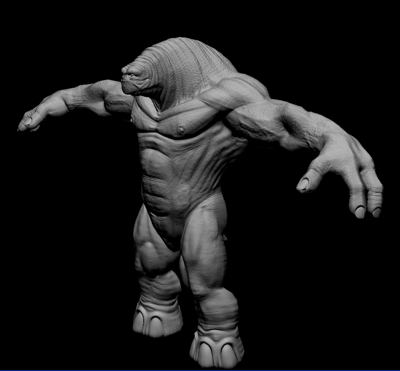

Although Iām not finished with this model, I wanted to make a quick test to see how the ZMapper plug-in would work with Lightwave 8.5
The image on the left is the low poly model in ZBrush at around 16,000 polys. The image on the right is the lightwave render using the TB_NormalMap.p plugin. There are a few anomalies in the mesh, but I think thatās because I have a little bit of overlapping meshā¦Thatās a no, no. Over all Iām really happy with it.

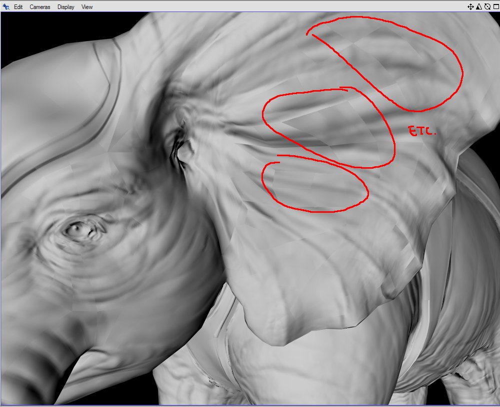

I made a quick and rough test in C4D. There are some issues visible in the ears. Any tips on how to fix these?
Cheers / Alex
Badtastic - Please post questions here. What you are seeing is the result of your settings not be set correctly for Cinema 4D. As there is no Cinema 4D preset at this time, this will require trail and error and the support of Cinema 4D community.
