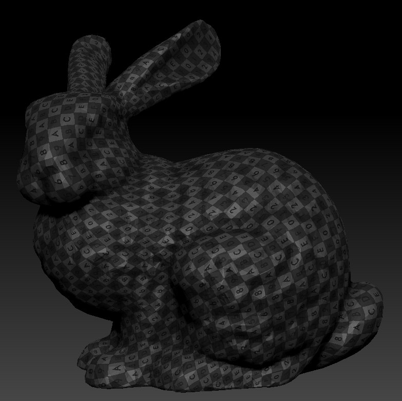

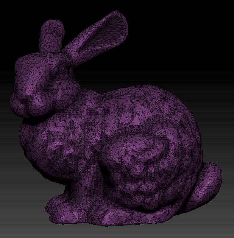

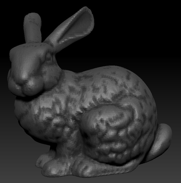

Gareee: I just did and it was even easier than i thought hehe. Have a look at the screenshots below from my little experiment using the cavitymap technique i mentioned above for polygon decimation. It works beautifully! :slight_smile:
Now you can preserve detail only where necessary, this will ofcourse also work with polypainted maps to control the decimation level in certain areas of your mesh.
Generate a cavitymap for your model

For Decimation Master, as you may have noticed, the Mask is protecting for decimation. Then you should inverse your mask if you are creating it from the cavity. I know it’s for a sample purpose, but I prefer mention it!
And for ā€œthe funā€, you can also create your UVs with UV Master on the decimated mesh. The Decimation with the UVs preserved require a lot more memory.

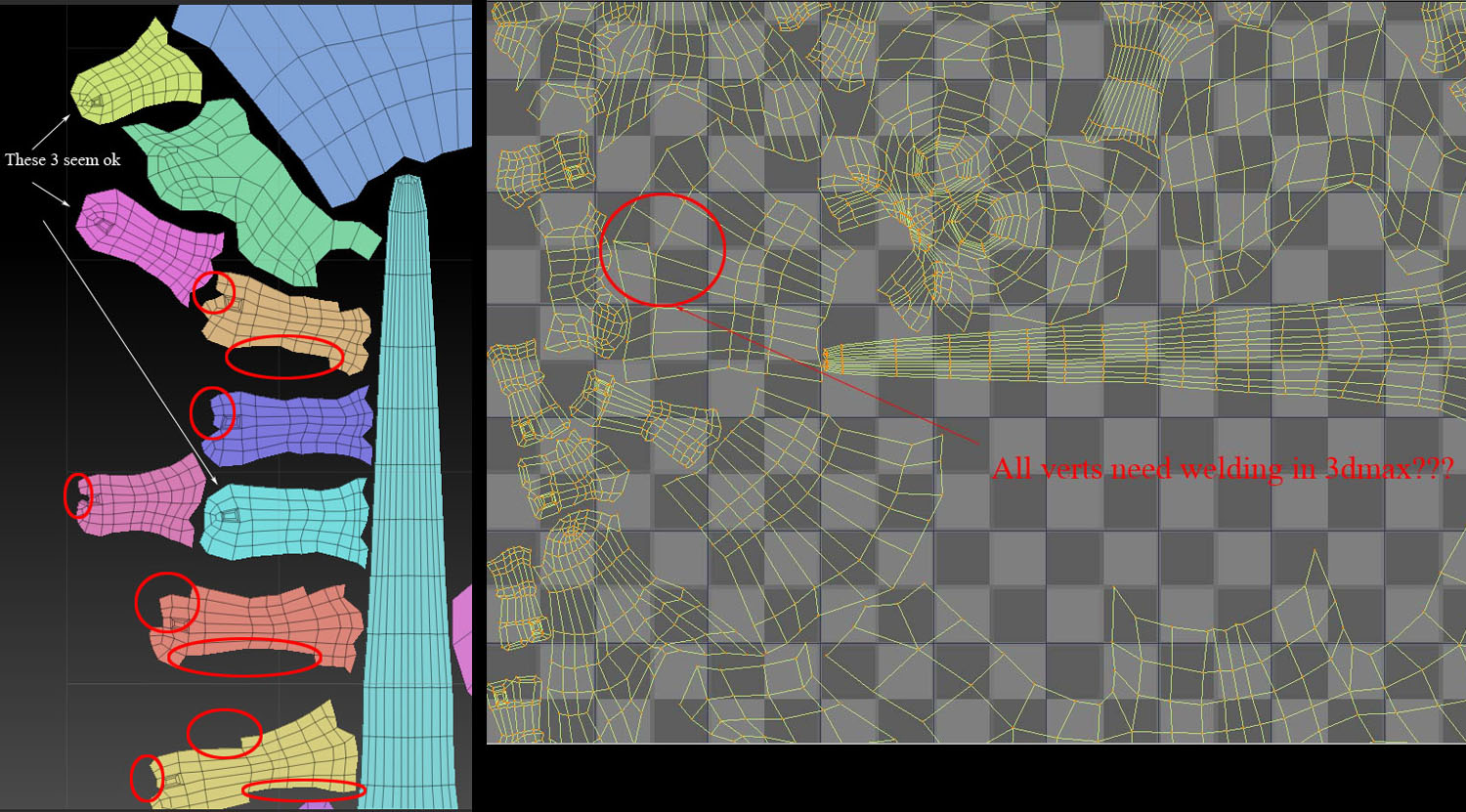

Sorry if this has been mentioned before, ive tried searching google etc. Im pulling my hairout, everytime i use UV master and import a model (obj) into 3dmax 2010, drop UV unwrap on, click edit, everything looks fine apart from every vert needs welding back together within 3dmax uv editor. Any ideas why this happens? i tried ticking/unticking all export obj opitions etc but same same all the time.

In the export options select Mrg and deselect Grp?
Richard
Richard that worked! Cheers mate can’t thank you enough!! I’ve been trying to work that out for hours! thanks once again.

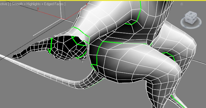

THanks for the tips aberant, One question, when i import my Obj into 3dmax, why do i get this clipping when i zoom into the model? pic attached. The model/view port doesnt clip like this within 3dmax before exported to zbrush. strange. any ideas?
It is a combination of scale and camera clip distance.
Your object is too small in 3DS max world. Since your camera has a clipping distance (lets say its set to 1 foot) and your model is only 1 inch high… it must zoom in closer than a foot to fill the screen and you get this clipping.
Two ways to fix it, one is to adjust the camera settings and make your minimum clipping value close to zero.
OR
Simply scale up the object and this should be solved.

Sorry about this but im still get UVs verts not merging, i’ve enabled <img src=ā€œhttp://www.zbrushcentral.com/pixo/atn.gifā€>Mrg and untick Grp, but when ever I import into Max the UVs still arent fixed. Please help ive got deadline Friday!!! pulling my hair out ! Ive attached pic show my problem. Usually selecting Mrg fixes it but not this time, iv’e tried 20 times now still no joy. please help if u can?? many thanks!!!
montana2008

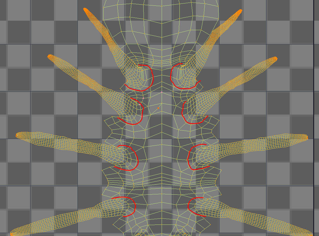

I would separate your uv shell following the image attached.
Layout/flatten the shells in zbrush then stitch the sheel together outside zbrush.
You can re-import the final geo back into your ztl.
Tripple your mesh by running a ā€œcleanā€ operation in Max (maya has one) or use the ā€œcheck mesh integrityā€ in zbrush.
