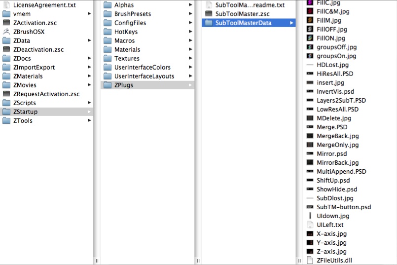

You get that message because a file is missing or not in the right location. The most like explanation is that your unzipping program has changed the folder structure.
When properly installed, your ZStartup\ZPlugs folder should contain:
SubToolMaster.zsc - the plugin file
SubToolMasterData - a folder containing many image files and the ZFileUtils.dll

Can you show me a screen shot of the file/folder structure of your ZPlugs folder? There’s no other reason for that message.
twoxa, thats in the wrong place, you have it in the zdata\zplugs, you should have it in the zstartup\zplugs folder instead

i try to install Plug in but i have the message that ZFileUtils not found
i use Mac OSX
Sombody can help me? PLEASE)
Thank you very much
It worked! Thanks alot!
