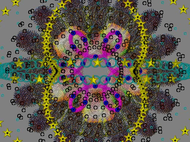

Super-Duper-ZScript.!! BELOW = 1st go, 5 mins before having to go out. Can’t wait to get back in and have a proper fiddle-de-de.

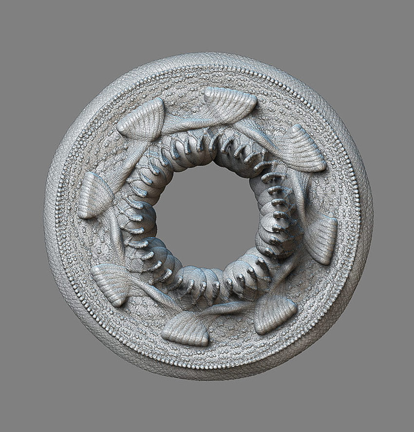

Here is the revision B…
Add Random Color and Palette Color.
A small challenge:
try to create the following tool with this script:
Happy Year to all.
ciao
cameyo

anyone got the tool ???
cameyo

To build the tool you must select a 3Dsphere tool, run spirograph script with standard value.
You must let the script draw three or four complete revolution…then grab the canvas with MRGBZGrabber and use Alpha->Make 3D.
That’s all.
ciao
cameyo
