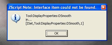

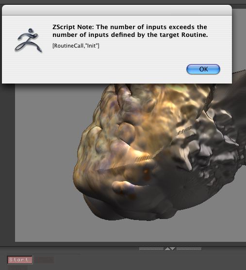

I had this problem when trying it…
Jason, do you remember what you had set when you got that…I had gotten it myself a while back when I first tried it and somehow fixed it or figured it out but I can’t remember now what I did…maybe if ya posted…what ya did leading up to it…and if best render or preview etc…will jog my memory and maybe I could get lucky and actually help someone hahaa.
Will run specific tests - but I believe I was following the instructions step-by-step!
Later Amigo!
TTTAAADDAAAA!!!
OK
  1. run this script - material_baker_interface.txt, when you hit start I get that error.
  2. run this script - material_baker.txt, this seems to work.
Doesn’t matter the model, material, etc., even if it’s the first and only script.
Ideas??
I never ran the interface one cuz I assumed it was a script called by the first one to perform certain routines. Looking at the files in a text editor seems to confirm that but…
