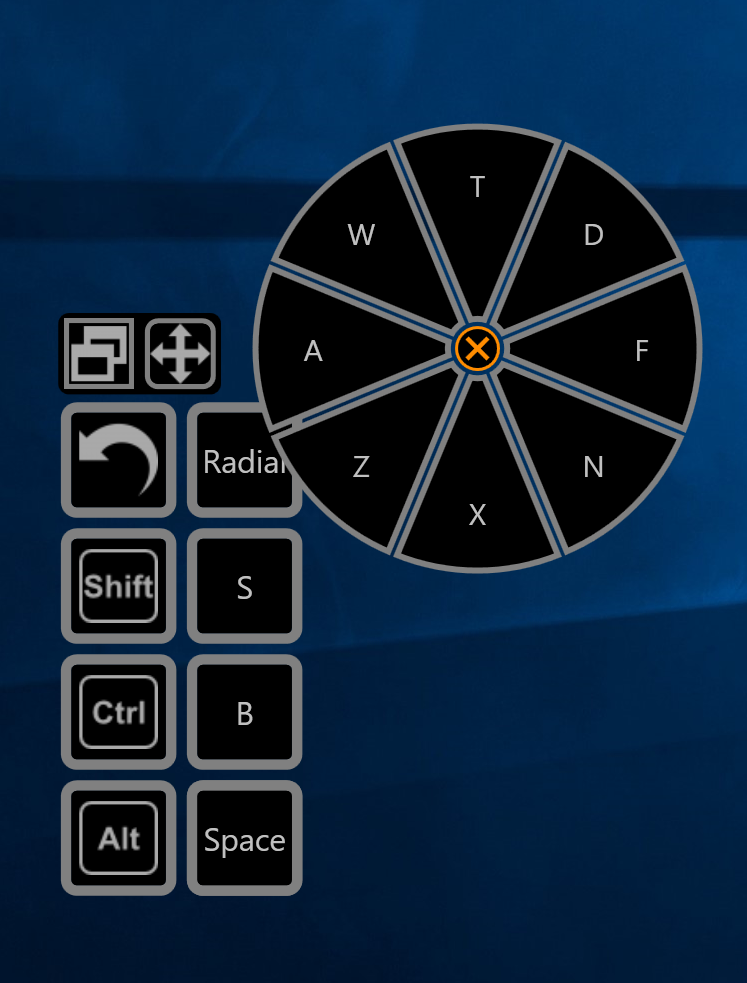

The RadialMenu layout I had initially settled into looked like this…
The round (radial) letter menu only pops up when tapping the square button labeled “Radial”
I relied on the “S” (brush size) and “B” (brush type) keys more often, so I broke them out alone for quickest access. I used “Undo” more than “Redo”, so first button stayed and the latter got reconfigured. If I really needed to “Redo”, I’ll just slide the ZBrush history bar forward with the stylus.

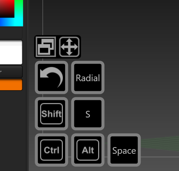

Now as I’m thinking this through, I’ve been tapping ZBrush’s prominent brush icon regularly and this means I can get rid of the dedicated “B” button in RadialMenu. Retweaking things and kicking the “Space” button into a third column, my RadialMenu layout now looks like this…
I went so far as adding the Wacom ExpressKey remote to the shopping cart, but then realized it would eat my only USB port on the SP4 while not exactly enhancing the mobility mandate I’ve set for myself, so decided to see how far I could go with just RadialMenu. After some 8 weeks, I’ve found I can indeed run lean and mean anywhere anytime I get the hankering to sculpt in ZBrush.

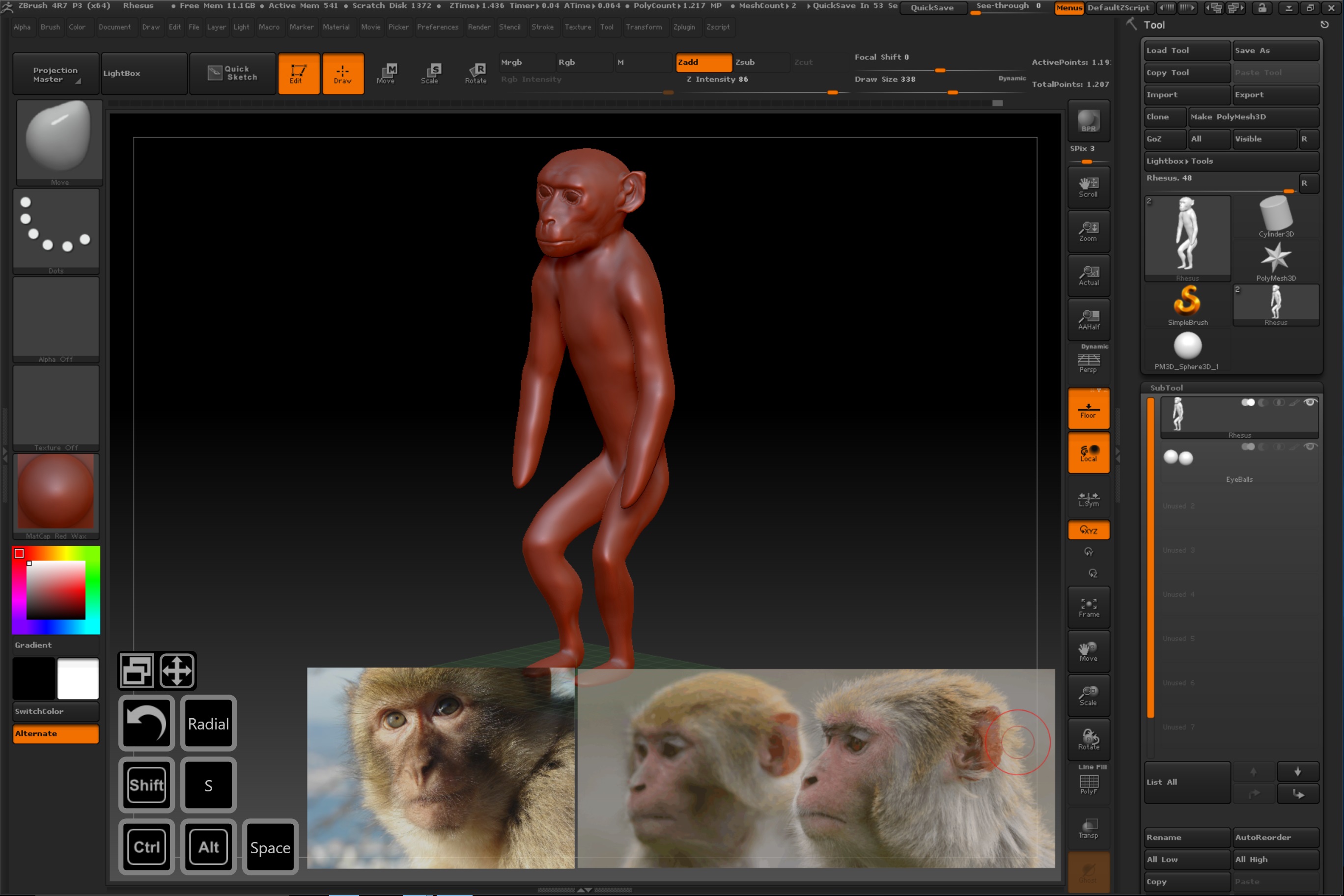

Monkey work-in-progress done only with ZBrush 4R7 (x64), RadialMenu on the Microsoft Surface Pro 4…

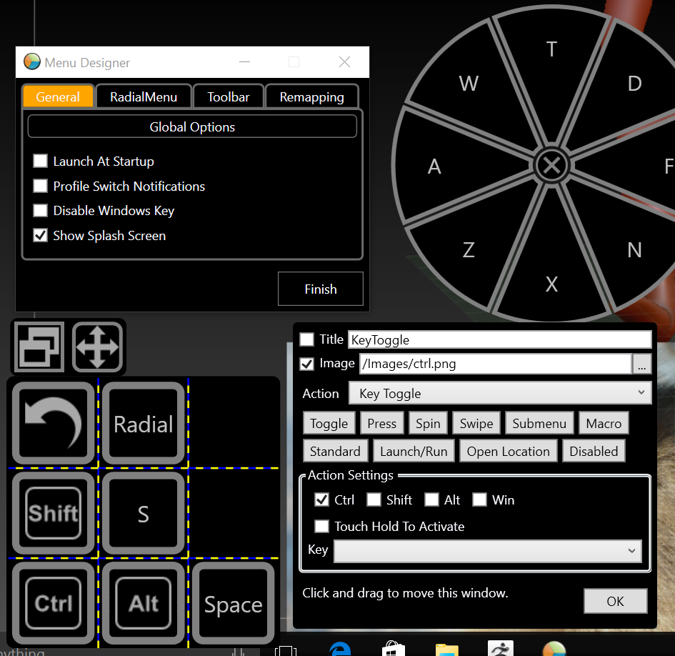

As I made a point to mention, having too rigid an expectaton with on-screen keys might lead to disappointment. With a small adjustment in the way I work with ZBrush, I opted to configure my RadialMenu keys for Shift, Ctrl and Alt to toggle on or off instead of trying to make them act like momentary ones:

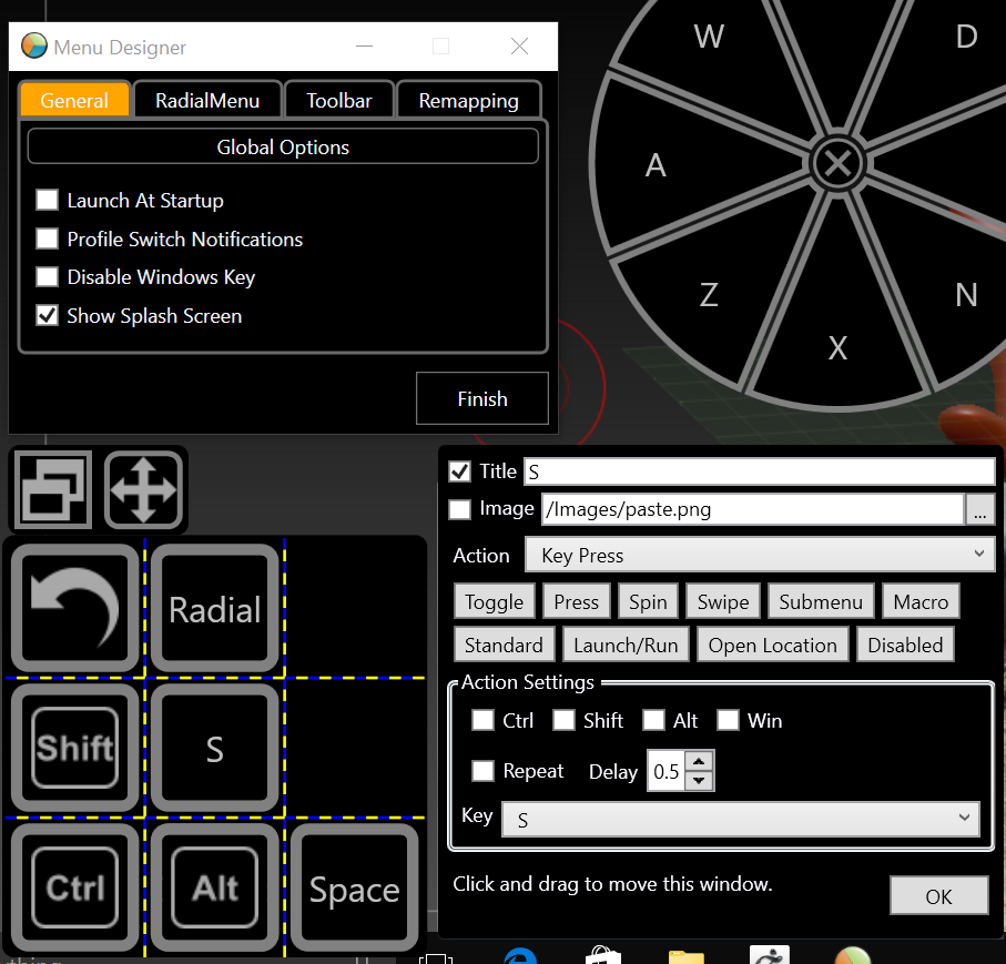

Everything else is configured to behave as a regular tap of the key:
