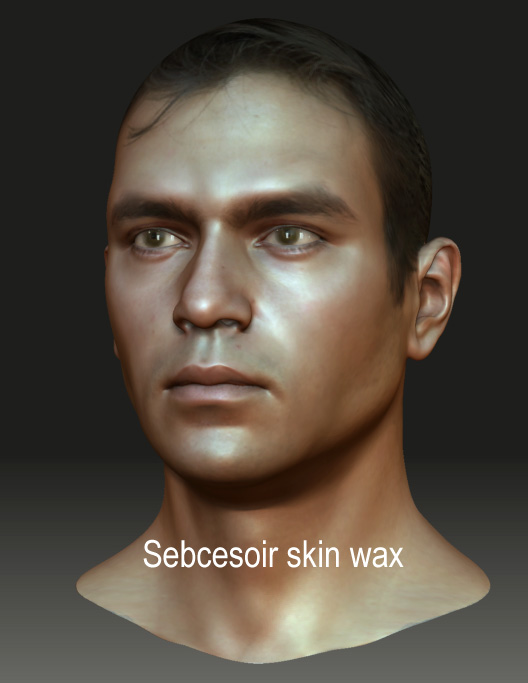

Here’s my tweaked version of the wax shader, that works nicely with textured models
http://archive.zbrushcentral.com/zbc/attachment.php?attachmentid=64019
headbase
Much appreciated Sebcesoir!!! :+1:

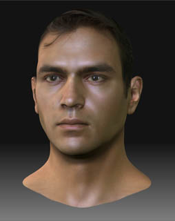

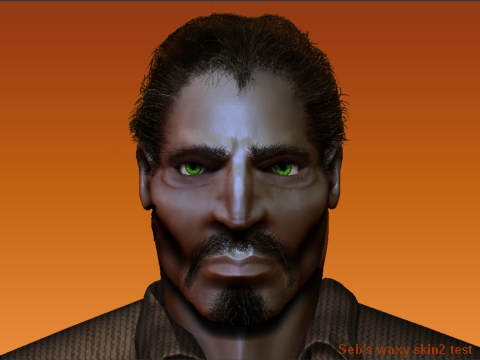

Here’s a more convincing skinmat…
I think I start to undertsand matcap…
sebcesoir%20skin%2002
Sebcesoir skinmat 02.zip (82.3 KB)
:+1: thnx Seb…love it…:+1: Just tried it out on a model I have worked on this evening…

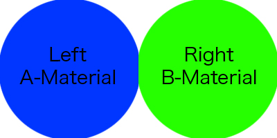

Thanks to Erklaerbar for this Thread. Here`s my small tutorial for creating Matcaps with custom-made A-B -Materials
Nice for creating Materials with a reflection map and a different shading for cavitiy areas.
Keep in mind that MatCap will capture basic material properties such as diffuse color and specularity. It won’t handle complex properties like transparency or procedural coloring effects.
1.	Open ZBrush and create the first sphere.
2.	Apply your desired material to that sphere. Any Material is fine, even "normal" materials... which can have a reflection map.
3.	Tweak that material as you like
4.	Render the sphere inside a square document. 1024x1024 is good for most purposes.
5.	Scale the sphere so that it is very slightly larger than the render. (So that it just barely goes outside the render frame.)
6.	Render the image and export it as a PSD. This is the sphere we use as A-Material.
7.	Repeat step 1 to 6 for the second sphere. This sphere can look totally different, darker, duller... anything. We will use this sphere as the B-Material.
8.	Open the 2 spheres in Photoshop. The sphere documents should be square.
9.	Create another document which is double the width of a sphere. (Sphere = 1024x1024px, Blank document = 2048x1024px)
10.	Place the first sphere (A-Material) into the blank document. Put the image on the left side! (A-Material = Left Side)
11.	Place the second sphere (B-Material) into the blank document. Put the image on the right side! (B-Material = Right Side)
12.	Flatten the image and save as .psd (Verify the Sphere-Position with my Picture)
13.	In ZBrush, load the image into the texture palette.
14.	Select one of the MatCap materials and open its modifiers.
15.	You'll see a small texture patch that shows the current MatCap source texture. Click that and select the new image that you just imported.
16.	This time, there a two small spheres, exactly like the photoshop file.
17.	Now you can tweak the cavity, intensity and depth settings of your new material.
18.	Apply the Material on a Tool and enjoy!
Happy ZBrushing!

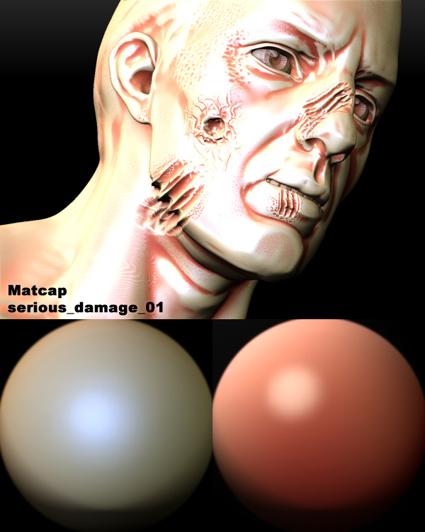

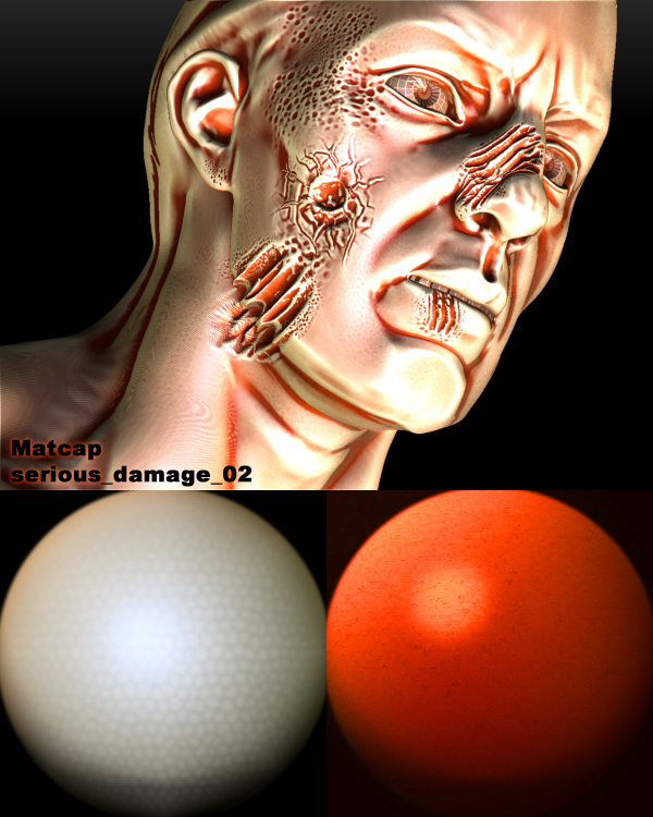

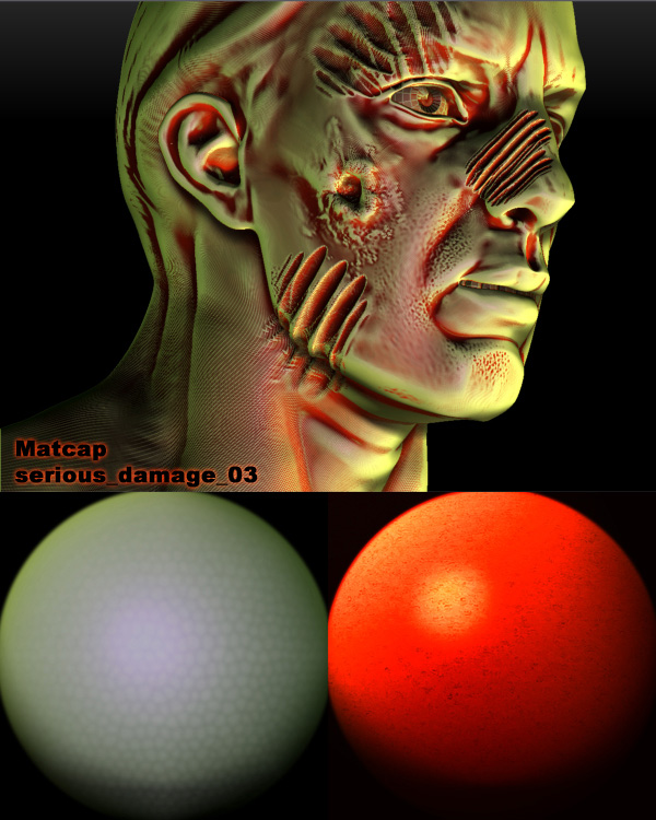

hi,
3 materials as basetexture for polypainting zombies or other monsters.
have fun!
chem!
download here: http://www.gigasize.com/get.php/-1099814673/serious_damage_03.zip
sorry for this stupid link… but i was in a little hurry…serious_damage_01.jpgserious_damage_02.jpgserious_damage_03.jpg

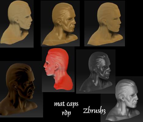

Click my link here to get my 7 new matcaps I created.
http://www.sharecg.com/v/10370/material-and-shader/ZBrush-3-MatCapsmatcapicon.jpg
