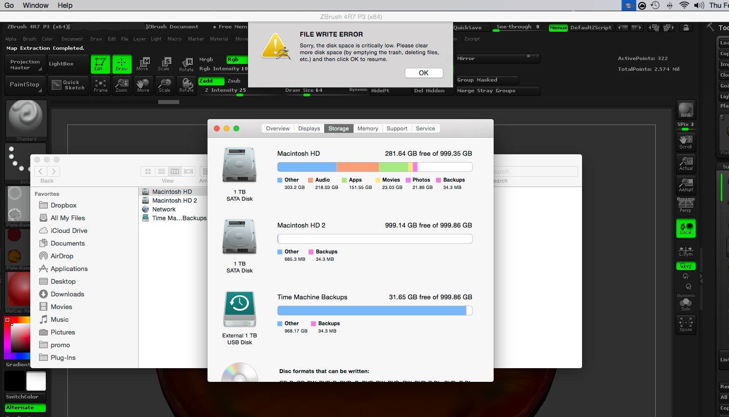

Please Read Edit at bottom for fix.
Please Help I have spent 2 days trying to figure this out myself with no luck before I decided to try to ask for help.
I Get The Following Error Message after processing when I try to use the plugin:
Sorry, the disk space is critically low. Please clear more disk space (by emptying the trash, deleting files, etc.) and then click OK to resume.
I have attached a screen shot to show the amount of Disc space I have. as well as providing the following Specs to help with this.
OSX 10.10.5
Mac Pro Mid 2012
3.2 GHz Quad-Core Intel Xeon Processor
16 GB 1066 MHz DDR3 ECC
ATI Radeon HD 5770 1024 MB
EDIT: Ok so after several days of trying to figure this out Ultimately it was the plugins data file was stored in the plugin folder incorrectly. After unzipping, BOTH the plugin and the Data folder needed to be moved out of their enclosing folder into the zStartup/Plugins folder independently. I cant believe I missed this from the beginning. I spent so much time over thinking the issue believing it was some kind of permissions issue. Anyway I hope my dumb mistake will help someone avoid this issue in the future…
