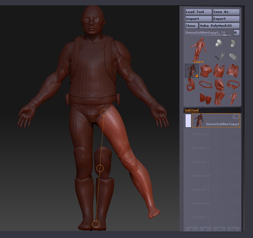

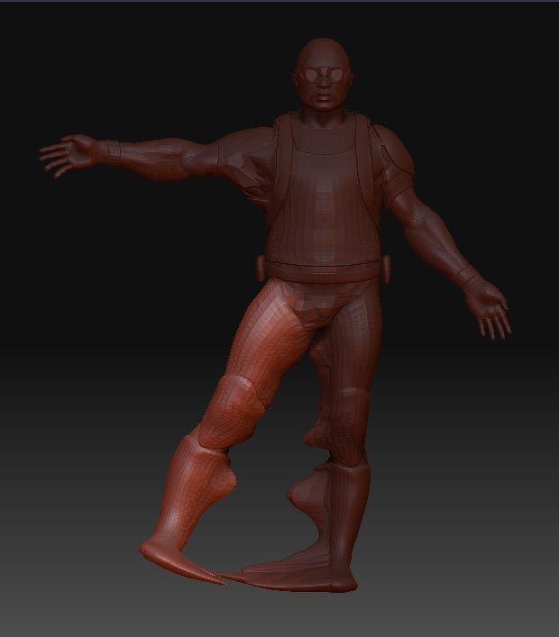

I have not been able to get Multimarkers in ZBrush 3 to work like they used to. I have been investigating sub tools and looking for some answers as how to merge them and use as a replacement for Multimarkers. Many thanks again for your terrific script:)
Is this plug-in just to merge all the subtools or is it also for, after merging, to move all the subtools at the same time? In case it is also to move, I am not getting to do.
Thanks
I can answer this
You have some of your objects masked which is why they aren’t moving. You can’t really use topology masking for merged subtools. Instead use the lasoo to mask the parts you don’t want to move (often the simplest way is to mask the bits you do want to move and then invert the mask).
HTH,
You are right.
It is easy, but perhaps it is not so easy, depending on the case and of who is the artist, like you can see.
Thank you.
Actually the demosoldier’s legs are so close together that it is difficult to avoid that.
