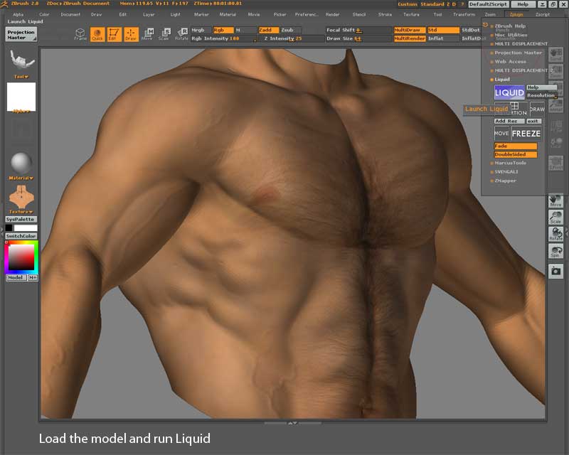

Ok, so i load a model with some subdivs, then import my texture and flip vertical. Place it on the canvas and hit L.
It all seems to go well, i do some small modifications moving the texture and when happy i hit L again. It drops and everything seems ok. Then i realize that i have double side texture. Try to undo, but it does not work. Then, i change my texture back to the original and hit L again.

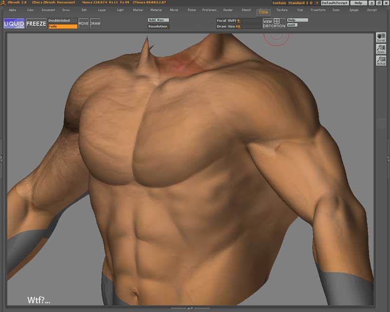

Now, the texture on the object inside the Liquid seems to be wrong as hell. Nothing is in place like if the projection had failed totally. I hit Exit and the texture on my object is correct, but it seems that if Liquid has a temp buffer, it is not cleared when entering a second time.

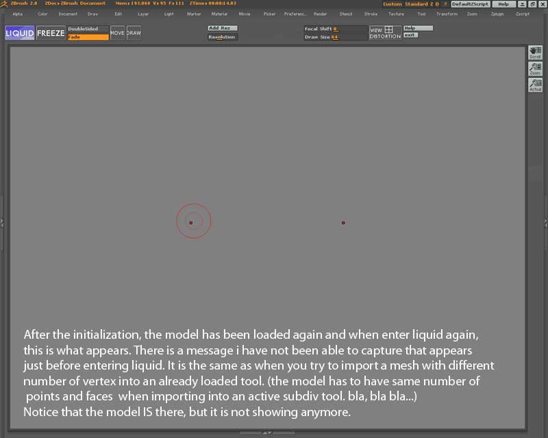

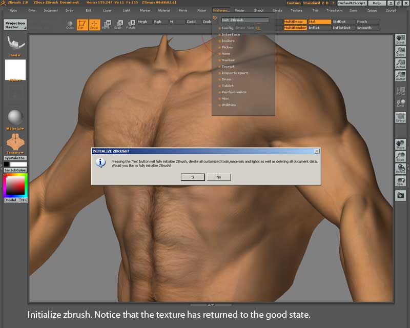

Even more, after some frustrating tries, i do a Init Zbrush to start again. I load my model, my texture and hit L. Then while the entering progress, a message appears during a second or two saying something like “swith to the correct subdiv level…” and when Liquid enters, my model has dissapeared. If i exit, the model still is dissapeared, and the only way to get a mesh back to the canvas is to reset zbrush.

Instead of that, i have done some screenshots of the problem. I hope this can help.
  Here we go:
So, the problem seems to be when entering Liquid for a second time. Initialize does not seem to clear everything on the backstage.
Oh, i forgot to say that if i click on the Move or Draw button inside liquid… they dissapear :stuck_out_tongue: Just like when you ctrl+click on any button. Veeery strange.
