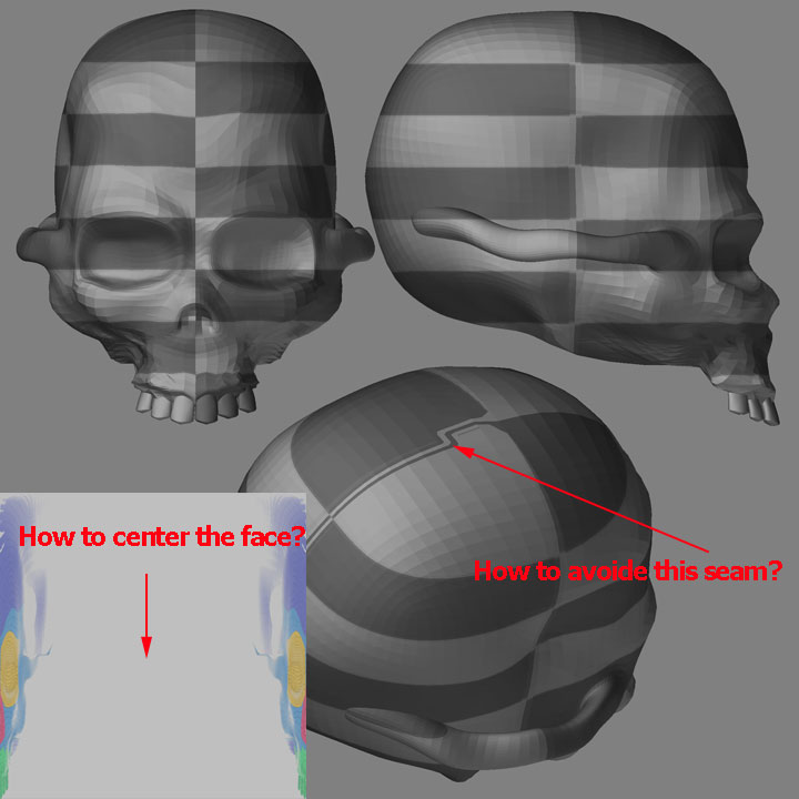

I have used Preview to rotate the head mesh and reapply UVc but seem unable to get the results you have shown.
sorry if this is an obvious mistake i am making.
thanks!

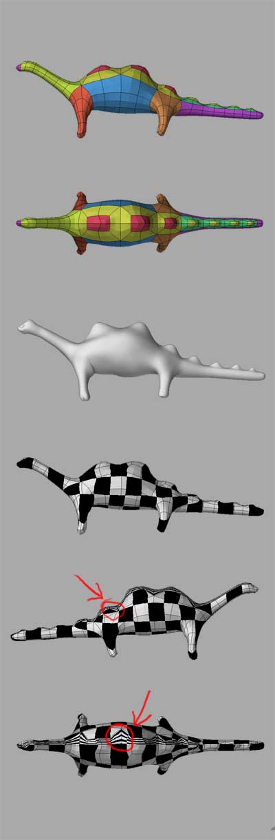

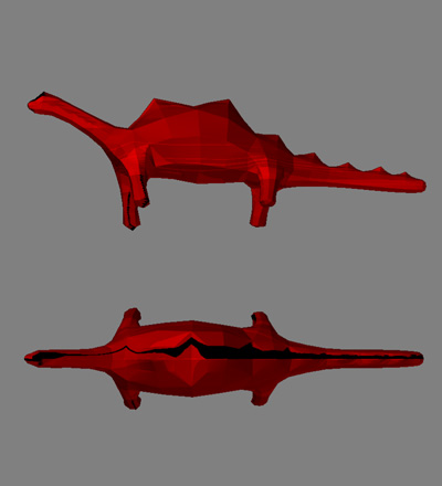

My intent is to make a model in zbrush using zsphere (zbrush 2.03 Mac) and exporting it for Maya.
My hope was a good UVmapping, making a good texture and using than Maya for animating the model.
As you can see i have some problems
Now i have a question…does zbrush work or am I too stupid for that??
Any suggestion?
http://www.zbrushcentral.com/zbc/showthread.php?t=8558
Maybe that enlightens you.
Lemo
lol lemo!
that is the same thread! :smiley:

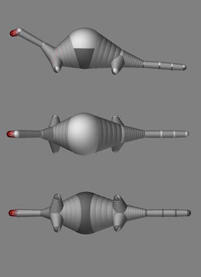

Can you show us your zspheres? I’ve seen this before, but need to see the structure to help you. :wink:
:wink:
Lemo
PS:The question is… Did you ever generate UV’s? Did you check how the UV Map looks like now?
so, Jason…i hope this one can help us
Thaxs a lot guy…i didn´t feel me alone anymore
I forgot…the Uv check give me also terrible results

I am haveing the same problems as posted above. Thing is though…i took a regular sphere out of maya and slapped it into Zbrush 2, and it came in with proper shperical mapping. The poles were messed up as expected but it mapped around the rest of the sphere just fine. Now when i applied Zbrush 2’s spherical mapping it freaked out and gave that horrible seam.
Now i am a 3D animator and i know about uv’s and the like…and yes seams have to be hidden at times…but on a regular sphere…with spherical mapping…there should not be this problem.
I read through this tut numerous times and have come to a dead end.
Anyone have any ideas??
