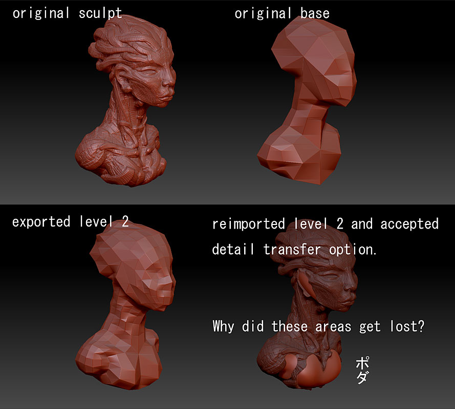

I tried this and ran into problems. Any idea why?
Simple.
You chose to export you’re mesh at level 2, when you are supposed to export it from level 1.
If you want to do an export at level 2. De-Subdivide down to level 2, and press the “Delete lower subdivision” button. Then export/import.
