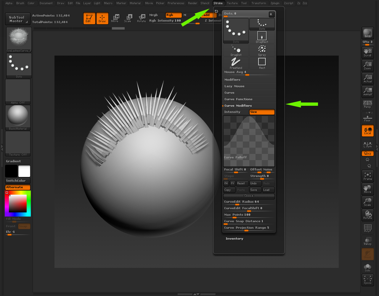

To Adjust the size falloff:
1) Go to the Stroke Menu.
2) Turn on Size under the 'Curve Modifiers' Tab.
3) Adjust the Curve Falloff to get the result you require

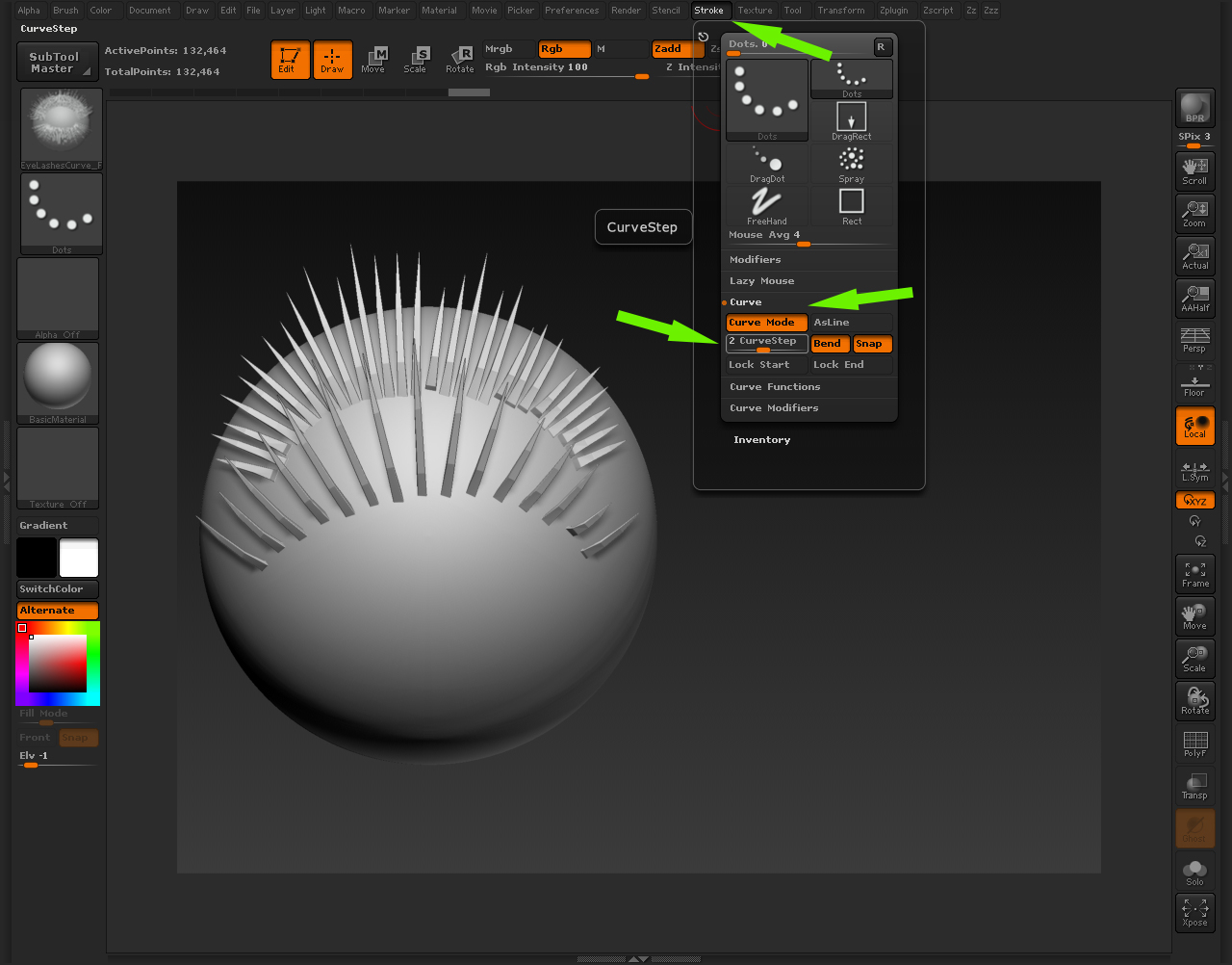

To Adjust the amount of EyeLashes per stroke:
2) Expand Curve Tab
3) Adjust the CurveStep slider (Higher value for more spacing in between)

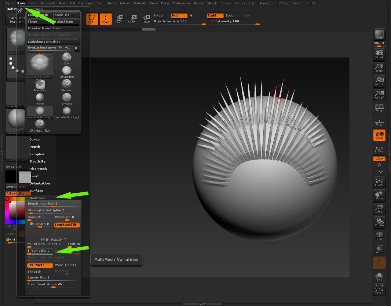

If no Random EyeLashes needed:
1) Go to the Brush Menu.
2) Expand the Modifiers Tab.
3) Set Variations slider to 1
Optionally you can choose from 6 diferent EyeLashMeshes:
3) Choose a mesh with the MultiMesh Slelect slider

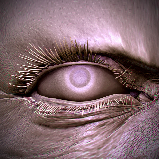

Hello Aurick! I love these insert meshes in these images… after searching the thread I can’t see them. Are you hiding the awesomeness from us??
Or am I simply blind?
Thanks in advance!
These are amongst the standard IMM brushes in Z4 r5, select one of them in the brush palette then press M to choose one frome the category.
