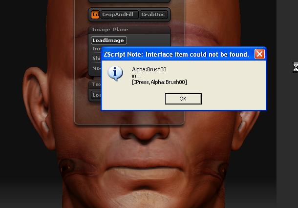

Hi there, I am haveing major issues here. When ever i get to the ā€œload imageā€ part of the process it gives me this error. I know this has been covered in a previous post but the link to the solution has been killed off. please help me i am ready to go crazy. I am using zbrush 3.1 and imageplane plugin 3_1 and texture loader 3_1
[attach=165549]ScreenShot267.jpg[/attach]
leesalo,
That error will only appear if you have the wrong version of the plugin installed. It’s possible you have an earlier version that is causing conflicts. Download the plugin again from the Download Center and delete the previous versions before installing. Be sure to install in the ZStartup\ZPlugs (NOT the ZData\ZPlugs).
