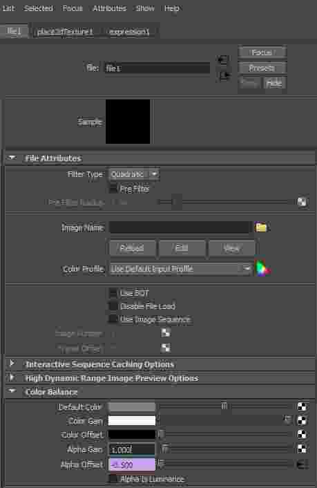

How to calculate alpha gain and alpha offset in maya when using disp.maps from Zbrush

Does anyone know how to use this information for displacement in Max? We do not have the saim alpha gain etc for our settings in material displacement. I have made some attempts but have only failed so far.
Please type this in Alpha Offset in colour balance
=file1.alphaGain*.5*-1
Please change the file node to the name you use …
