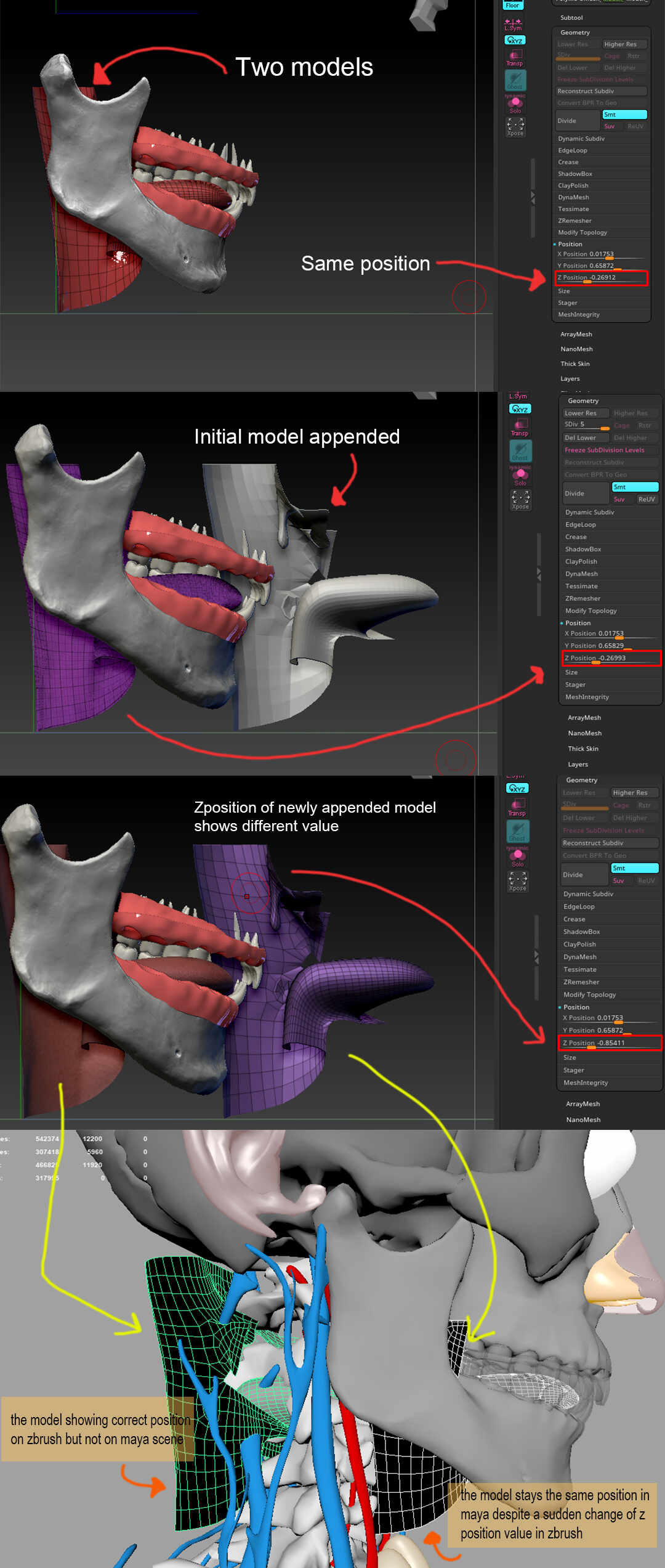

  • First of all I have a model of mouth interior which as you can see on the image its on polyframe mode.
    there are actually 2 models of mouth interior( one is the one that i just imported from maya and the other is on subdivide mode ready to be sculpted) on the 1st screenshot if you see carefuly the models are overlapping each other, because on this state both are on the correct position. (see the Zposition on the red box)
  • 2nd screencapture the polyframe model is at the same position (see z position) but the model that i imported from maya moved forward , i noticed this issue by appending the initial mouth interior model to the scene in the middle of the work.
  • 3rd screencapture is to show that the initial mouth interior model i just appended showing a different value of zposition in zbrush which is really odd
  • 4th screencapture what made me even frustrated is that the low poly model of mouth interior that i sculpted on zbrush is being on the wrong position once i imported it to maya despite the correct zposition in zbrush, WHILE the initial model which zposition value changed suddenly being on the correct position in maya scene.
I was wondering if i accidentaly did move the model in zbrush but its imposible since the other subtools are sepparated such as jaw bone, teeth gums ETC and stay at the same position. if it was an accident then i wouldn’t be able to move all subtools one by one intentionaly.
have you guys experienced any of this? and how did u solve the issue. many Thanks

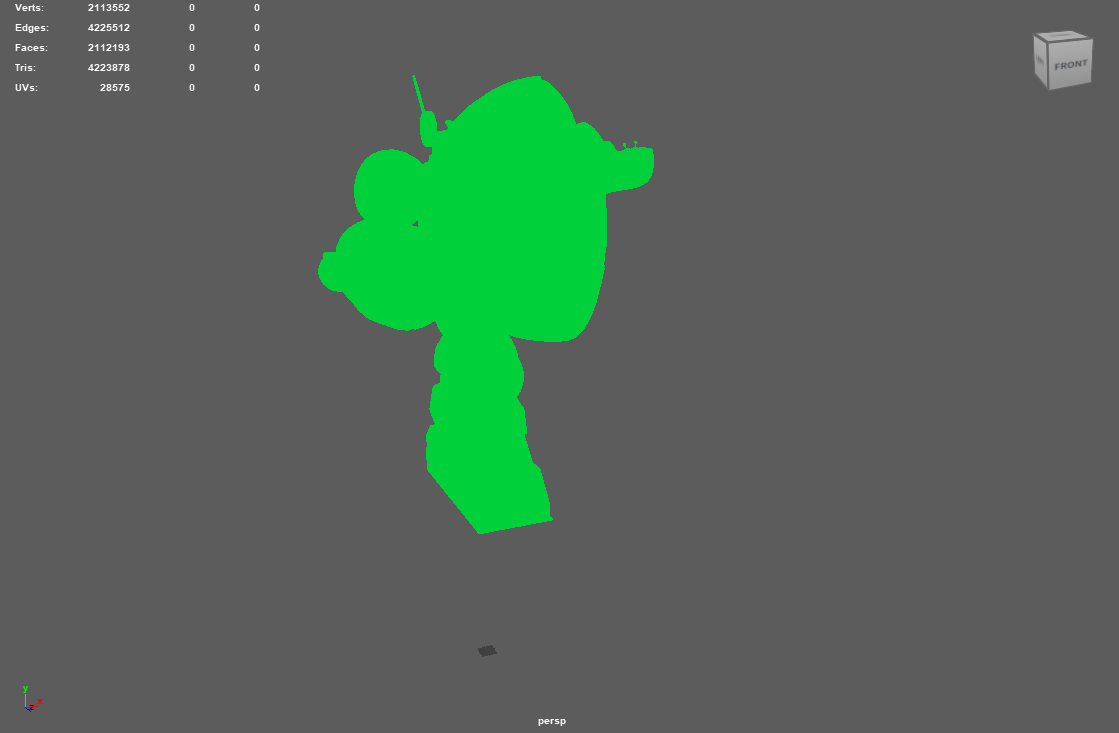

I mean, I’ve just tried having everything merged with both OBJ and FBX and the models import back into Maya in the right position.
Also, if I import an FBX model into a new scene, it’s placed at the centre of the world/Floor and looks fine, but if I export it out as an FBX (SubTools separate and in a single file), and import it back into Maya, it’ll be the right scale, but it’ll be placed miles above rather than over the grid where it was before. And I also made sure to the freeze the transformations beforehand. :-\ Everything comes in green too and I have to reapply smoothing as parts of the model get weird triangular shading.
Before:
maya_m91D5vthPo

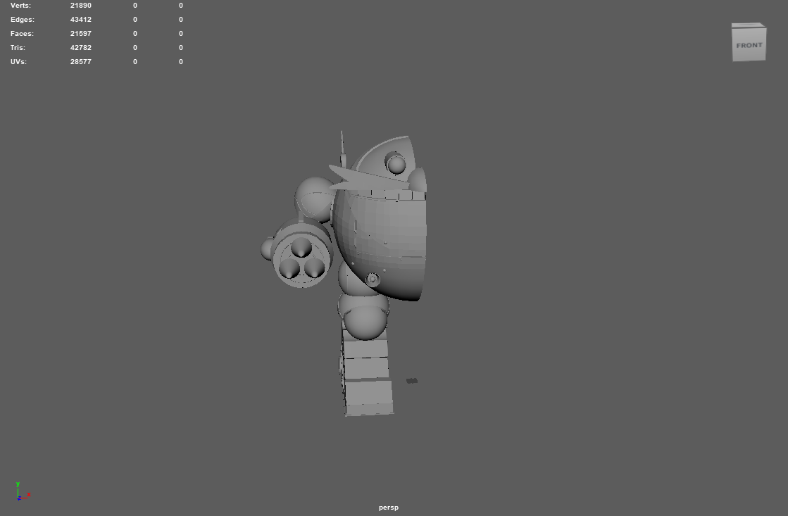

After:
maya_GAQeM98U7V
maya_a8zjYdYEOc

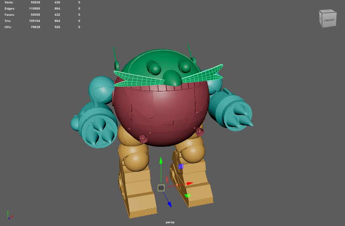

OBJ fares a bit better, but it still places it away from over the grid:
maya_kHh8Q0kkF5

Before export to ZBrush:
maya_m91D5vthPo
After importing from ZBrush:
maya_GAQeM98U7V
maya_a8zjYdYEOc
maya_kHh8Q0kkF5

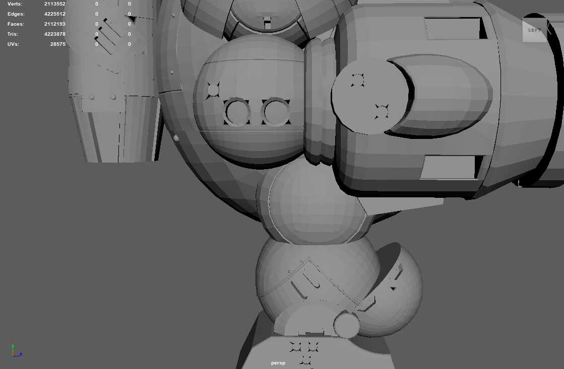

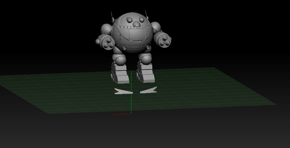

At the moment, I’m tweaking one object at a time, such as changing the UVs etc. But no matter what I do, whether with an OBJ or FBX, and whether adding a star primitive beforehand, it fails to come in at the same location. :frowning:
Before exporting to ZBrush:
maya_11QTdvoxTx

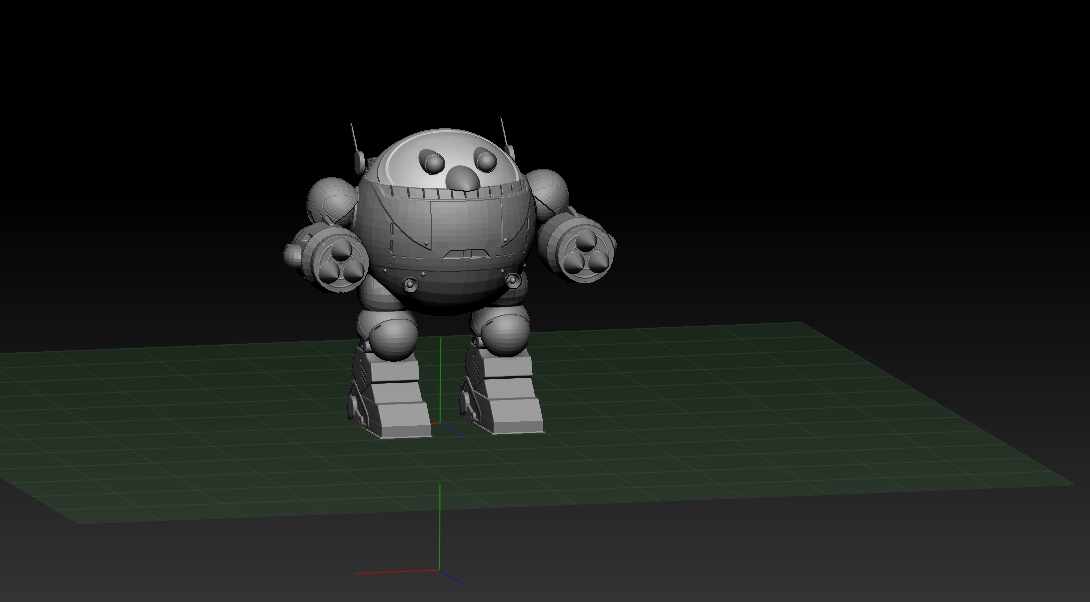

Imported into ZBrush:
ZBrush_SeeTwvAQEU

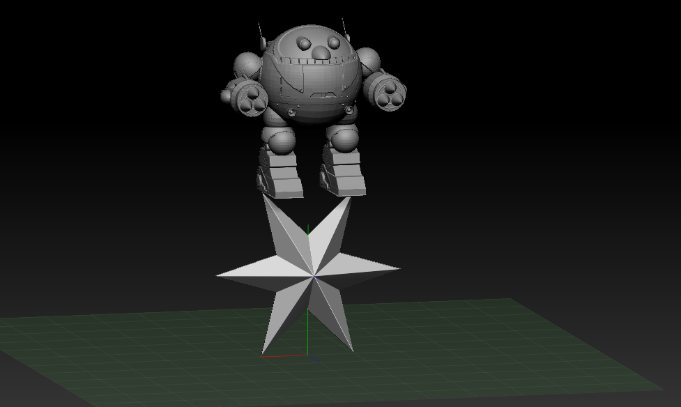

Inserting a star primitive:
ZBrush_3T0fchFM7h

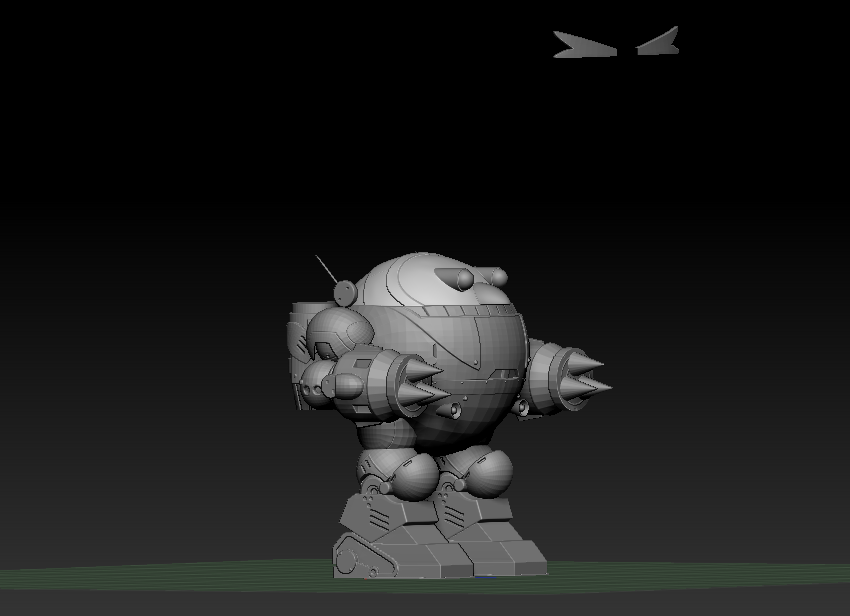

Importing the OBJ:
ZBrush_RkBnik7lmB
Importing the FBX:
ZBrush_OYlj3PdgC9
