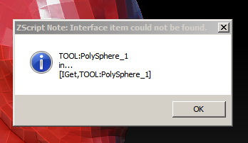

        Thx for new update, but there is a problem.
        Importing into Max is working great, but when I export to ZB(using Max button), there is a ZScript error pop up, which looks like attached image. So nothing happens in ZB. NO crash for both program, just the ZScript error pop up window(this window automatically closes).
        When I tested v1.4, this never happened. It must be the new script you made.
        I think this has to do with the line in the script where it is looking for the PolySphere_1. I'm sure this is for the initial sphere problem other people have. But I have disable this initial sphere thing by changing DefaultZScript.txt (Pixologic\ZBrush 3.5 R3\ZScripts folder) like this:

   EDIT: I replaced v1.5 GoMAX_Import.txt with v1.4 GoMAX_Import.txt
   It works fine. So like I said, I'm sure it has to do with the coding in GoMAX_Import.txt
   I have looked at the GoMAX_Import.txt
   [If,[IGet, TOOL:PolySphere_1],
   This part is problem I think. I don't know anything about scripting. I'm just guessing.:o
Anyway, I can use v1.4 GoMAX_Import.txt instead, so it’s not a big deal.:smiley:

Strange, could you give some more details? Like, what was the name of the tool that was selected when you imported?
I was not able to reproduce the problem.

    Hey Norman,
                  I figured out what was causing the error and found out temp. solution.;)
    I hope this help people who might have a same error like me.
                  To solve this problem, in ZB, I have to either load any ztool or select any pre-loaded ztool and name it 'PolySphere_1', then let it stay in my tool palette. Once I do that, GoMAX works perfect. I can load my own ztools and Use v1.5 without any problem. The ZScript error I mentioned before never happens again.
                  And this is the reason.
                  PolySphere_1 <- This is the name of the shpere that apears when you start ZB in default setting, right?
                  Since I have changed my 'DefaultZScript.txt' to disable that initial sphere thing appearing in ZB canvas, when ZB started up, there was no 'PolySphere_1' in my tool palette. That's what was causing the ZScript error. Simply GoMAX_Import.txt was not able to find 'PolySphere_1' from my tool palette.
         Maybe you can make two different 'GoMAX_Import.txt' for people who use ZB with default setting(initial sphere in canvas) and who do not.
                  I Know most people just use ZB with initial sphere thing.(and complain lol)
                  But I'm sure there are some people like me.([manusito](http://member.php/?u=143973) said   he encoutered same problem once.)
                  Anyway, now I know why v1.4 GoMAX_Import.txt is working with v1.5.
                  I guess I will just use v1.4 GoMAX_Import.txt with v1.5:D
         I love this plugin too much:laughing:
         Thx again.(and sorry for some of my broken english.)

    Funny because the zscript what it does, is check if you have PolySphere in the tool palette. If you do, then it switches to simple brush and then imports the obj, draws it again in the canvas, and so on. If it does not find the polysphere (which should be your case) it simply imports the obj as usual. At least that is how it’s working here. I’ll have a look again, anyway.
