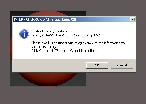

norman I get the following error when i export from zbrush to max, using the macro button.i scanned the previous posts and didnt find someone complaining about this error so I decided to post here. :smiley:
[[attach=180267]error_gomax.jpg[/attach]]error_gomax.jpg
Ps: might have fround ze problem! lol
No I didnt… I thught was the caption on the O on the GoMax directory… i change dbut didnt go trough still
Your folder structure needs to match the one in the path. It could also be, that for whatever reason, you don’t have the rights to write a file in that folder. Please double-check your GoMax installation!
You were right I was an idiot I didnt realize winzip created a Gomax folder outside the original Gomax folder. my bad :smiley: thanks for the quick response!
