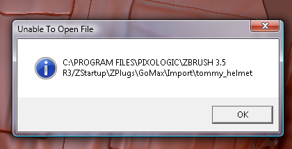

Hi, I installed as per instructions, except I cant move an object from Max > ZB, I get this:
Is this something to do with permissions? I get no GoMax panel in ZB either…
Damn I really need to use this as well, I suddenly got the scaling gremlin in ZB! lol
cheers
Did you try running 3dsMax as admin? You can do this by right clicking 3dsMax and clicking on “Run as administrator”

Hi Norman3d, thanks for the reply. It seems that it is only certain objects in my scene which fail. I have tried other objects which import fine to ZB, unfortunately it doesn’t solve my scaling issues, whereby all my objects import really small into ZB, whereas before they were importing fine lol
Could you do me a favor and try importing it twice? I have recently come across the a similar problem, and the scaling issue was fixed when I exported it from 3dsMax to Zbrush twice.
I will give it a go re the scaling. I found out why those errors were coming up. It seems I have to use GoMax to open up ZBrush. If ZB is open already the errors occur, when I click open ZB from GoMax options it is fine.
