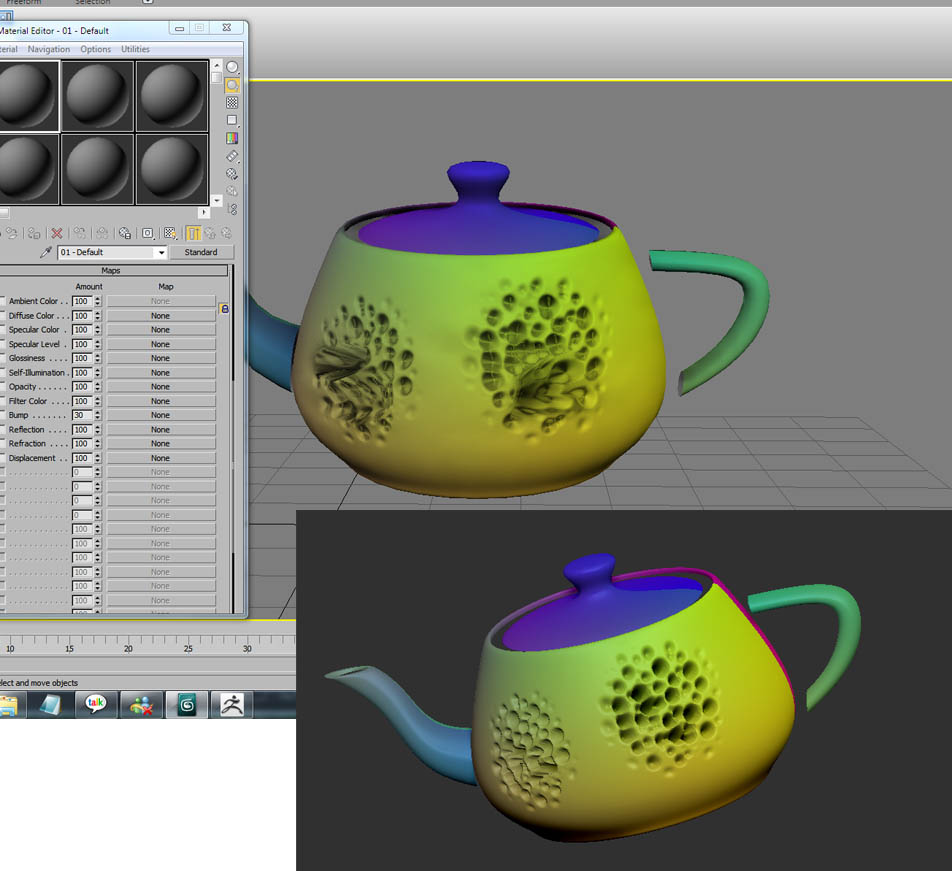

I don’t know why a have a little problem.
When the object are exported, the holes …better you guys see I don’t know explain :laughing:

There’s only one thing that I can’t get to work, render, I don’t see the material that should appear in the material slot #23. I Get the displacements and everything in the viewport but I can’t render the thing.
I use mental ray and the objects have UVs. But the material doesn’t apear in the mat-editor.

But I don’t get the MR Material. I just get the dirct X material but I can’t render anything. And I dont get any material in the material editor (it should be in slot 23 I think).
It works great but i cant render.
