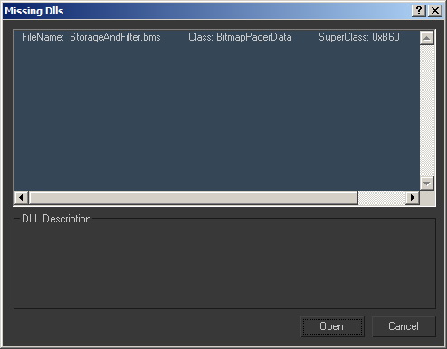

    3ds max 2009 says it is Missing a plug-in (StorageAndFilter.bms) when i use Gomax 1.6 because it don’t support max 2010 plug-in’s inside max 2009 …But was the code not optimzed to run on Max 2009??:wink:

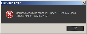

    When exporting to Max, once the script dose its part in ZB, in Max, error window pops up. I have attached the images of error massages.
    I did quick resaerch and found out that storageandfilter.bms
    is part of Max 2010 file Darv. I am using Max 2009, and this is first time I have seen this error. v1.4 and v1.5 did not have this error.
    I know you’re using Max 2010. Hopefully, you can look into this for Max 2009 users.
    Thx again.
    Edit:
    I’m guessing Material.max is saved in Max 2010, so it cannnot be opened in Max 2009.

    Edit: ARghhhh… I already know what the problem is! totally my fault! Will fix it very soon! I’m getting sloppy… :confused:

     Found a workaround!:D
     I replaced v1.6 Material.max with v1.5 Material.max. It works fine.
     Like I said, you must have saved Material.max in 2010. It is not possible to open 2010 file in older versions.
     Anyway, anyone having StorageAndFilter.bms error, do what I did.;)
    PS. scale thing seems to be working. also it seems importing back to ZB is much faster than b4. nice work.
    ok, cool, I fixed it now, redownload the zip file if you are having the problem. :wink:
