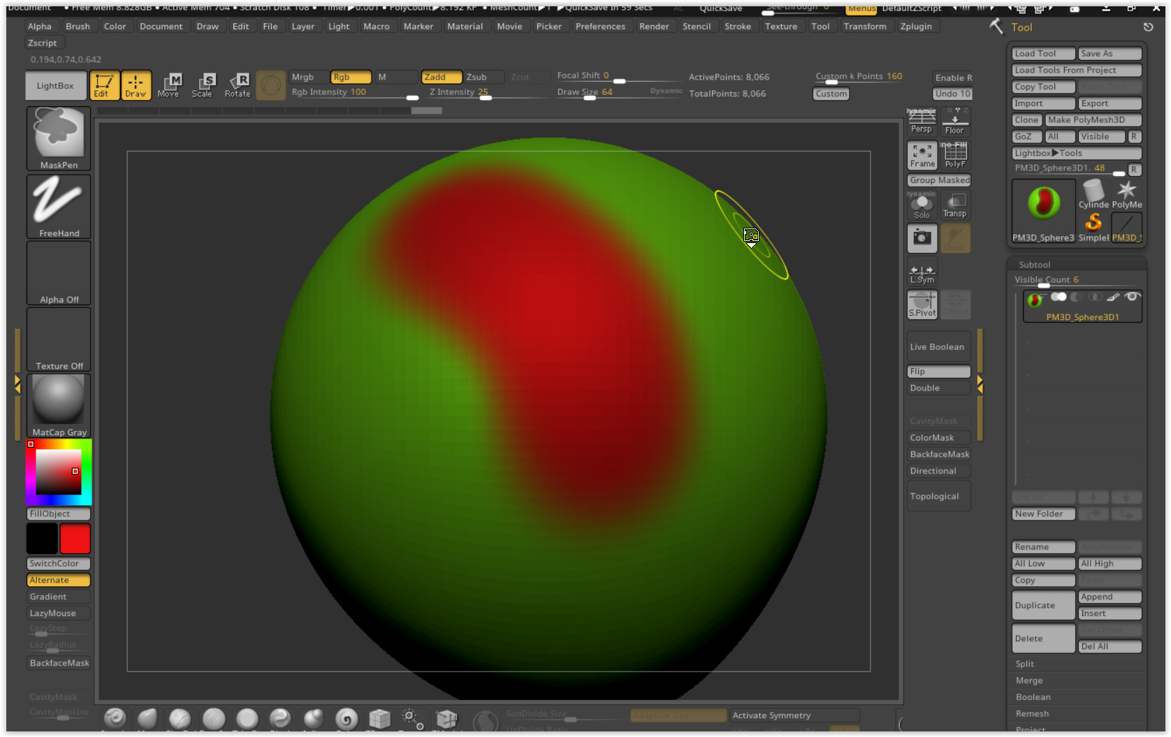

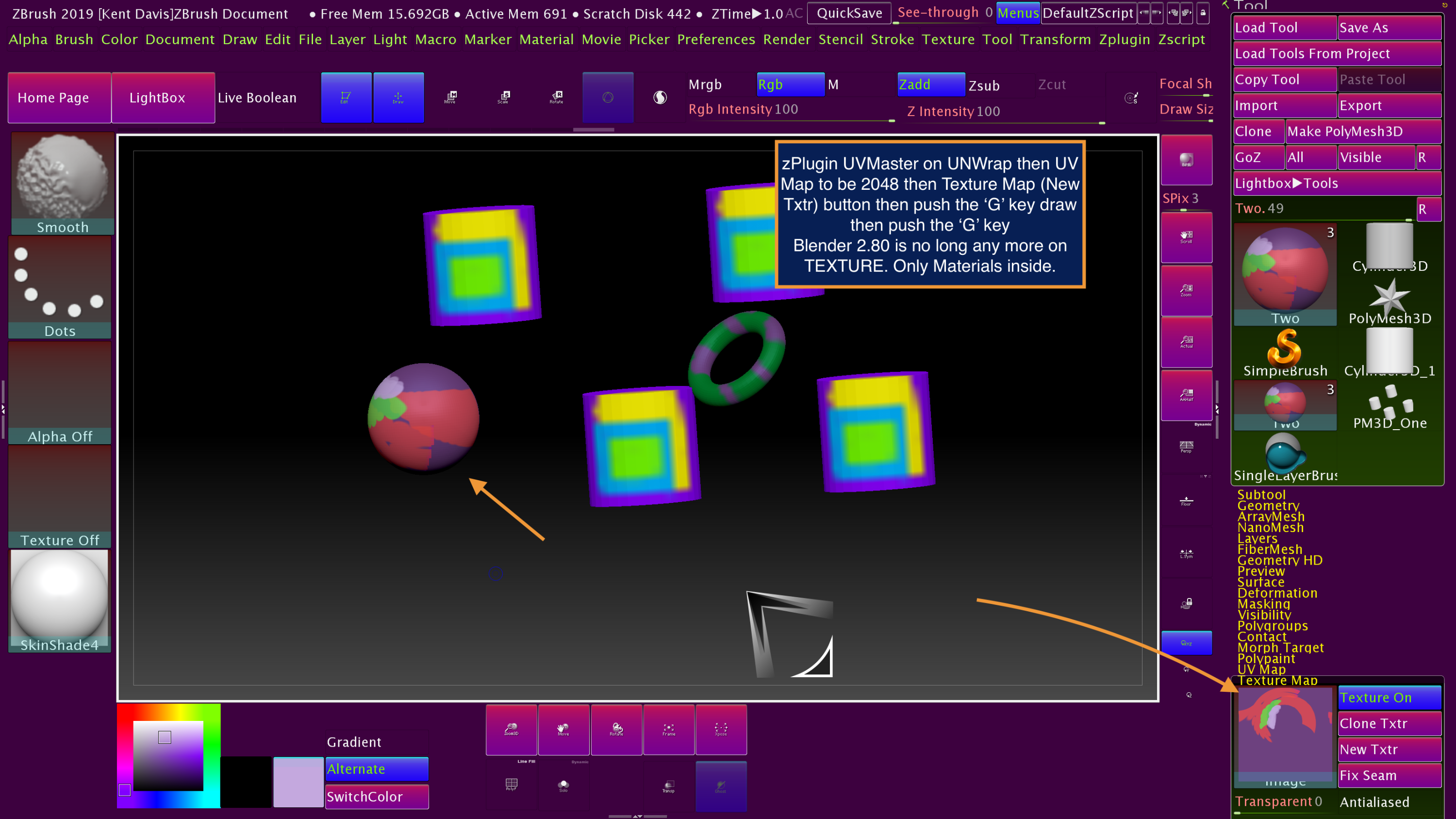

I just check from zBrush 2019 apply on color on 2 different mesh and different color on PolyGroup to go Blender 2.80 appear on Materials itself it work but there fail on color stay white.
I just change color then GoZ from Blender 2.80 to zBrush fail color.
Oh no I mean use materials on Blender 2.80 I am going show you youtube.https://www.youtube.com/watch?v=40SI19CMPNQ

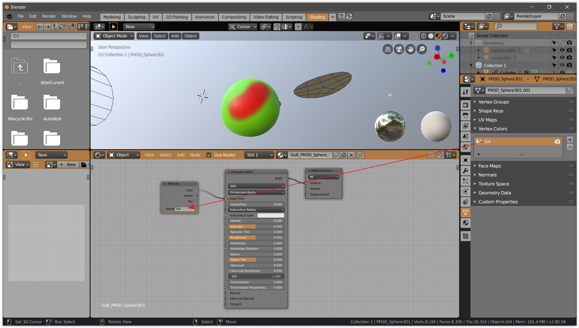

@mac4kent: i see what you mean, the problem is that what we see as materials in zbrush is a “matcap” with vertex color or polypaint mixed on top of it. So in order to get the same visuals in blender we would need to also transfer the matcap (which might be possible as baked texture) and probably generate a node setup that mixes it with the vertex color. (no clue if that is possible at the moment, will need to tinker around with ).
I see the point of having this in a more user friendly way and im sure it can be done, i will have to see how difficult/feasible this is.
As for the material, would you expect the same look like the matcap or just a basic material with the same color as in zbrush?
@mac4kent: i had a look what the node setup would need to look like and we can easily feed the vertex color layer name into a attribute node that is used as input for the material base color.
can you give this a try and let me know if this would be what you had in mind? this should be quite easy to implement.
Screen Shot 04-22-19 at 03.57 PM.PNG.jpgScreen Shot 04-22-19 at 03.53 PM.PNG.jpg

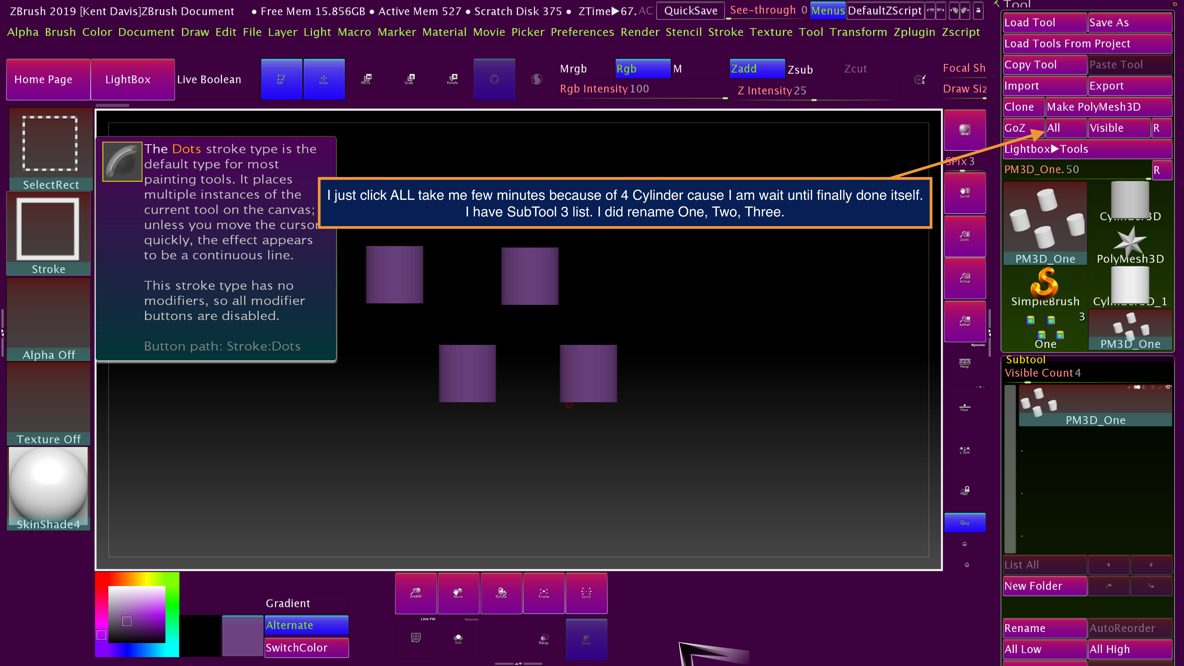

You may create new 3 object (mesh) on zBrush 2019 and Color menu click both fillObject and fillObject GRAD each other 3 objects then GoB click ALL
I did tried and I have fail to process.
  1. When zBrush 2019 create new object.
  2. Click Make PolyMesh3D
  3. Color menu change color then click FillObject GRAD also click FillObject
  4. Color menu change other color then paint a little
  5. GoZ ALL

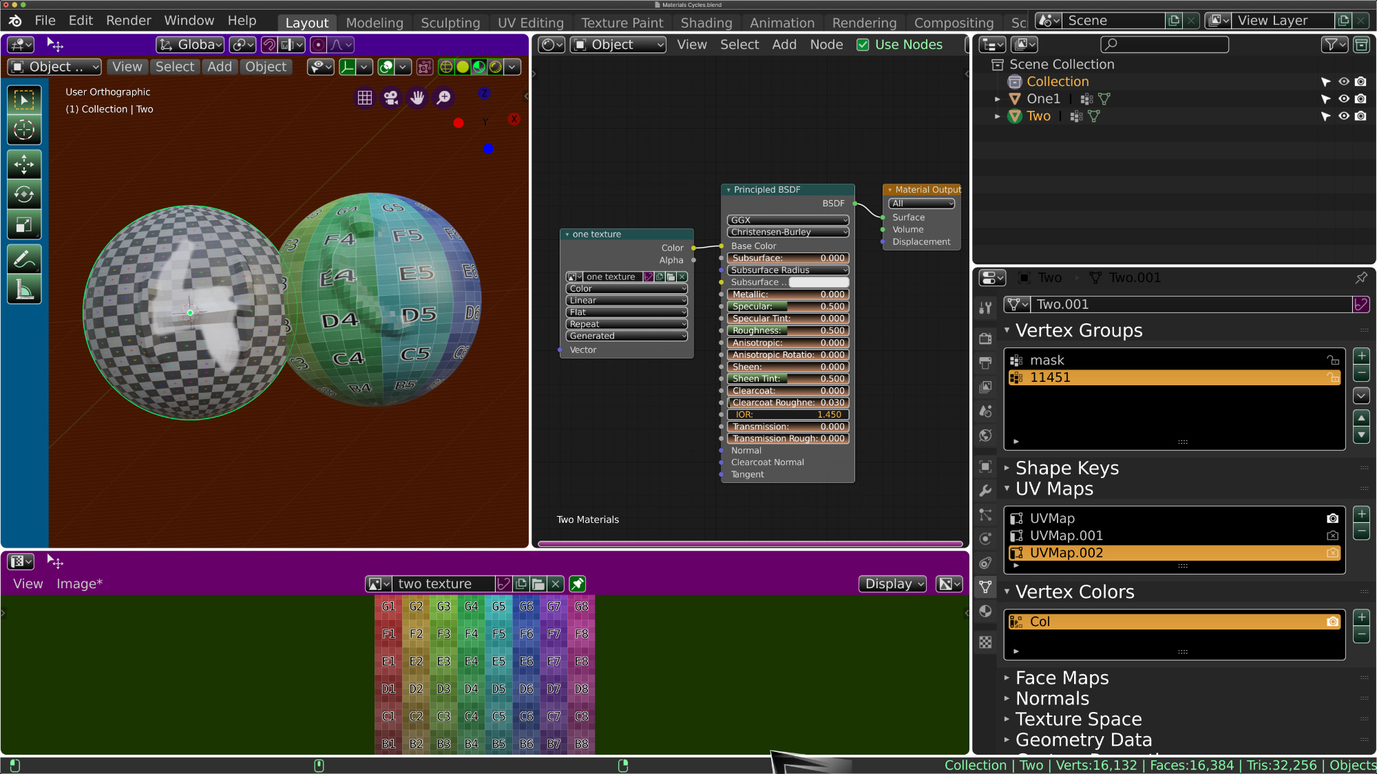

Blender 2.80 doesn’t appear Materials itself but object yes appear.
https://www.youtube.com/watch?v=r6k85KB5qo8
@mac4kent: hey i hacked somethig together so the color gets transfered, im sure there are scenarios that are not covered yet but if you have some time maybe you can give it a shot and see if it does what you would expect.
:warning:experimental :warning:
https://github.com/kromar/blender_GoB/archive/feature/material_import.zip
Yes it work 3.0.1 congratulation good job. There appear Materials finally.

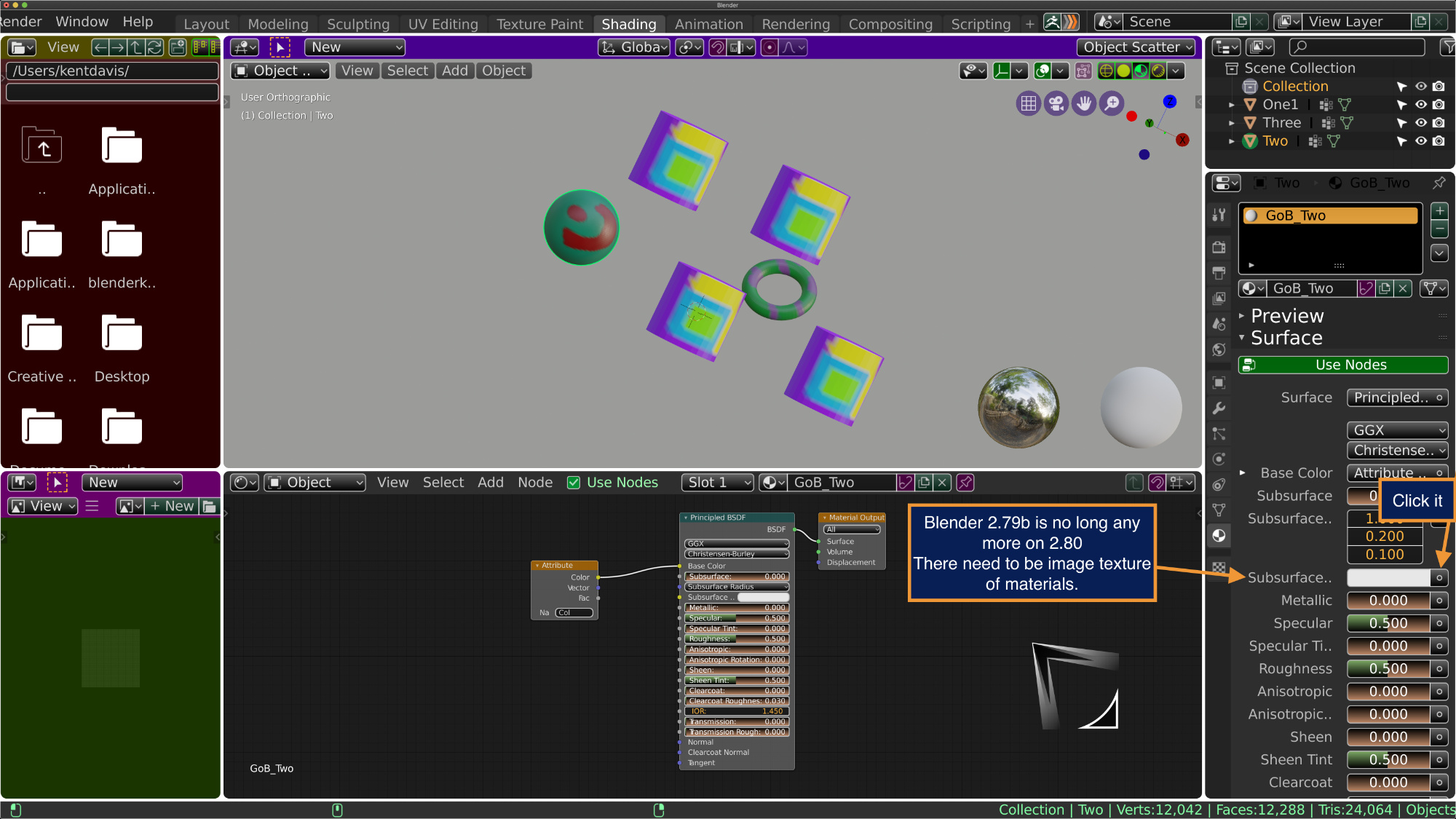

Never mind I remove my sentence. All it work subtools 3 list yaaaaayScreen Shot 2019-04-22 at 3.33.17 PM.png
https://youtu.be/KsqfDmeFDucScreen Shot 2019-04-22 at 3.49.13 PM.jpgScreen Shot 2019-04-22 at 3.51.19 PM.png
Sorry my wrong. I mean Base Color on texture

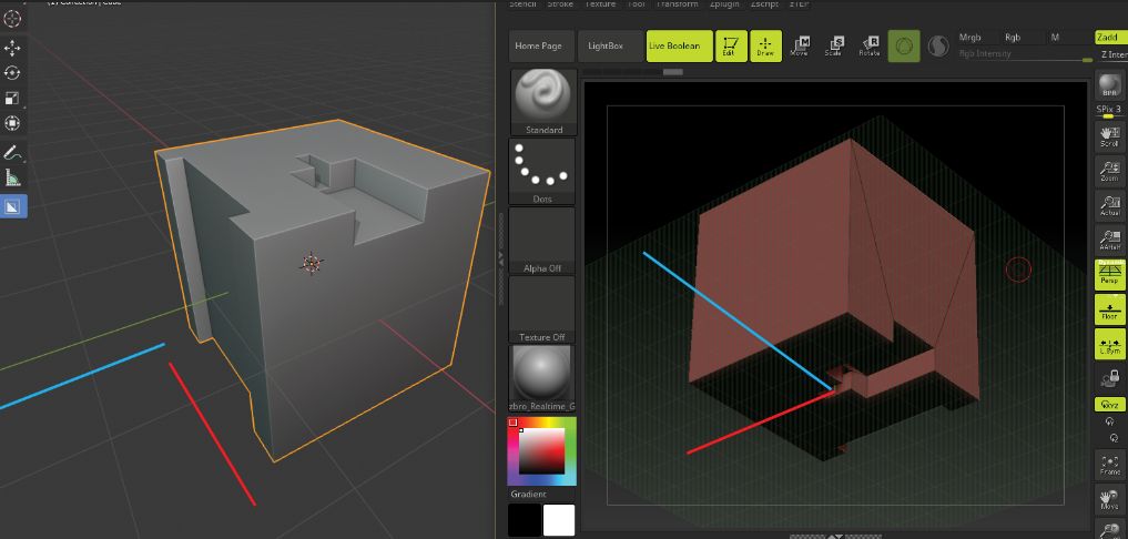

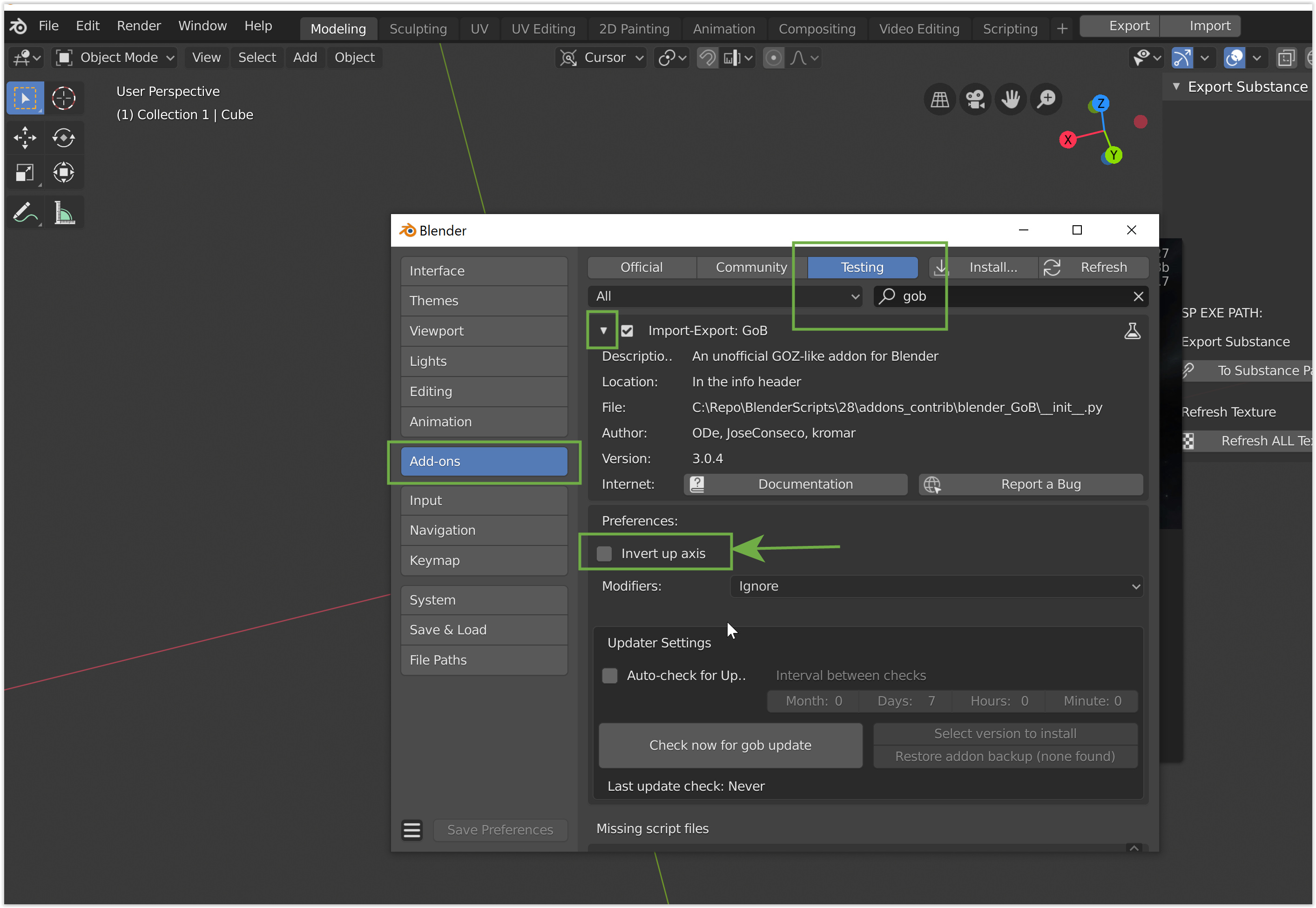

Is there a way to get Blender to be “Y” up? or a way to “set and forget” automate, the process of getting apps to have a 1: 1 Axis viewport?
I mostly work in Ortho view but as long as the objects will import / export in the same (expected) direction would be very helpful.
Zb_BlenderGoB
haha yeah it still is^^

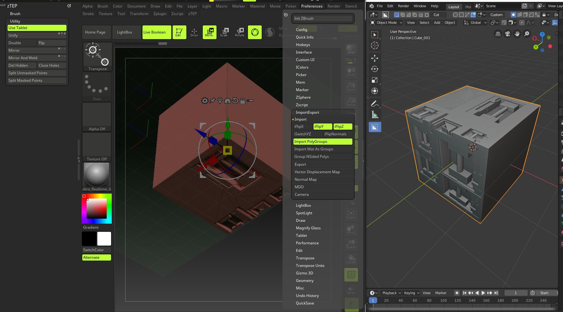

you should find a option in the blender addon preferences of goz where you can flip the up axis. for some reason some users need to change this.
In ZB pref Import, found the “switch YZ” but that works for import and not whatever GoB is doing. (I do realize I can rotate the mesh before GoB but THAT is exactly what computers are suppose to do for us)
Is there another pref setting to get the mesh front to face the front camera in both apps?

@sadicus glad the up axis flip did work.
Flipping the forward axis is certainly something that can be added, so far we never had that inconsistency reported and i think i also never experienced this personally, i will have a closer look and see if i also see some inconsistency.

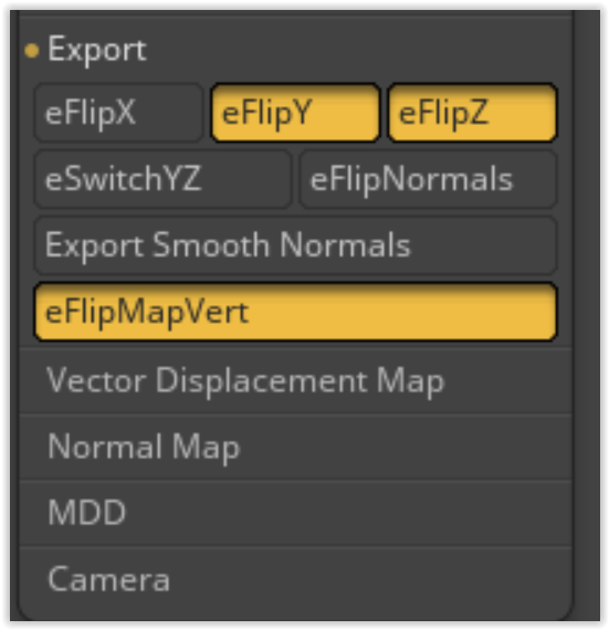

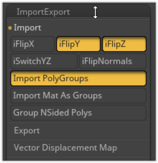

Hmm maybe those import options in zbrush have a impact on GOZ, can you post a screenshot of your import settings?
here is what i have which should be the default of zbrush
thanks for looking into this, The settings look the same yet it imports upside-down and facing away.
