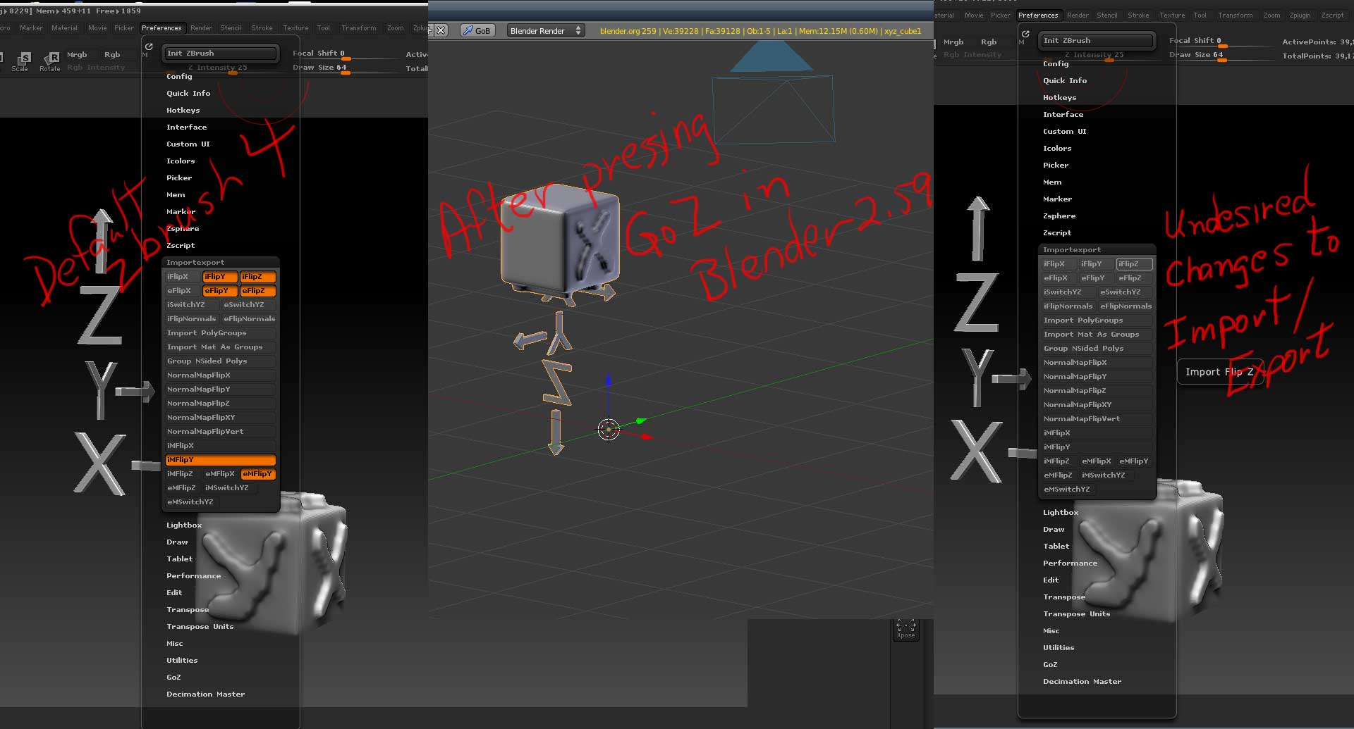

This GoZ for Blender is not working as desired.
I have noticed 2 things that are wrong.
When I hit the Goz button in Zbrush to jump to Blender.
  1. My model is vertically inverted in Blender.
  2. The Export/Import options of Zbrush 4 are then changed undesirably
  • I've attached a image showing the before in Zbrush 4.
  • A model in Blender as opened with the GoZ button of Zbrush 4
  • And the annoying changes in the Zbrush Export/Import preferances
So with these problems in mind how can we make the GoZ for Blender better?![GoZ-for-Blender-mess.jpg|1100x1035](upload://fcE2MhpFWUXaoRhrkW9p56lOC9N.jpeg)

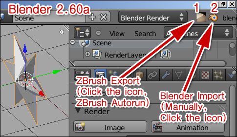

Hi bobyy.
Try as see below.
Damned ! Didn’t notice the blender icon :o
Thanks a lot for your help and have a good sculpt :smiley:

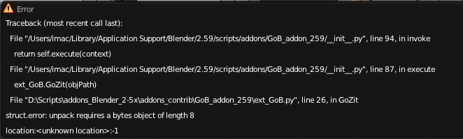

I’m getting an error when using the 2.3 script on my Mac (OSX 10.7.2). I downloaded the script and Extracted the ‘ZBrush’ directory contents to:/Users/Shared/Pixologic/GoZApps. Set the goz preferences in Zbrush to find my blender 2.59 app - all is good with the Zbrush part.
For the blender add-on component I placed the GoB_addon_259 folder and contents into “Macintosh HD/Users/imac/Library/Application Support/Blender/2.59/scripts/addons” and changed the init.py pathGoZ = “C:/Users/Public/Pixologic” to “/Users/Shared/Pixologic”. When I follow along the video with the rhino, I export out of Zbrush and then go to import into Blender with the blender icon in the header, I get this error:
What am I doing wrong?

it looks like the already compiled “ext_GoB.pyc” is relying on windows-specific filename paths. as opposed to generic path variables to be passed in, or even mac specific paths with structures like “(uc/Users/designusername/Library/Application Support/Blender/2.60/scripts/addons_contrib/GoB_addon_259/)”
I’ve performed the same fixes to init py as Dougt mentioned. And am able to send objects TO ZBrush from blender, however, I am not able to reImport the GoZ data back into blender when clicking on the blender icon in the menubar(within blender). I get the same error, which looks like its arising from and “D:” drive based file path, that looks to be hardCoded into the “ext_GoB.pyc” file. Has any one found a means of defining the filepath that “ext_GoB.pyc” is attempting to use? This looks to be the last glitch preventing OSX usage of GoB that brings the mesh back into Blender.
Hello Mac users,
We found with doug some mistake in ext_GoB.pyc
use the new attachment file for Mac.
All paths are only in the “init_.py” file.
So edit this file is a good thing, the default path is for Window.
Two lines need to be modified is the “init.py” file:
line44 pathGoZ = “C:/Users/Public/Pixologic”
and
line126 os.system("{0}/GoZBrush/GoZBrushFromApp.exe".format(pathGoZ))
@uaun:
Can you post your modif from line 126, because I need the GoZBrushFromApp name on Mac to send back a Mac specific version of GoB.
Thx for the help.ext_GoB.zip (5.29 KB)
