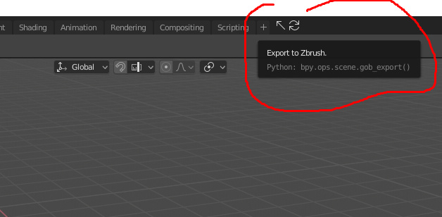

GoB: an unofficial GoZ for Blender.
Use buttn here:
Also make sure in zbrush preferences-> goz → set patch to bledner 2.8
Yaaaaa a a a a aayyyyyyy it work Thank you for your show me and I got it.
Thanks so much for this @Jose!!!
