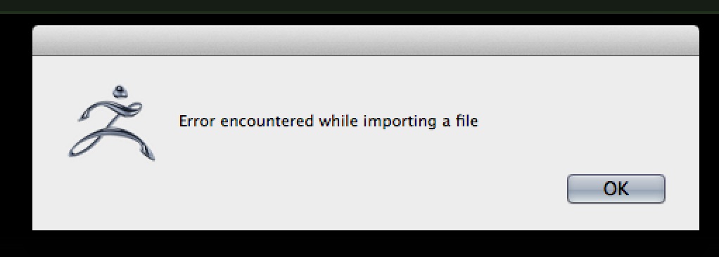

Thanks for that Stunton, I manually reverted all the permissions to ‘all can access’ effectively and it works now. Except now it will work halfway, I mean that as in, it gets to Zbrush, and gives me an error message. So close! Grr. :slight_smile: Thanks for the help. Screen Shot 2014-01-03 at 5.03.42 pm.jpg
Edit: I have a cube which I subdivided and turns into a hexagonal shape. Then I press the little button on the left and it launches Zbrush and gives me that error. :slight_smile:
Try to copy the .goz file to an other folder and open it in ZBrush by hand (import-> *.GoZ). If the Goz file is loaded, so the problem is elsewhere.

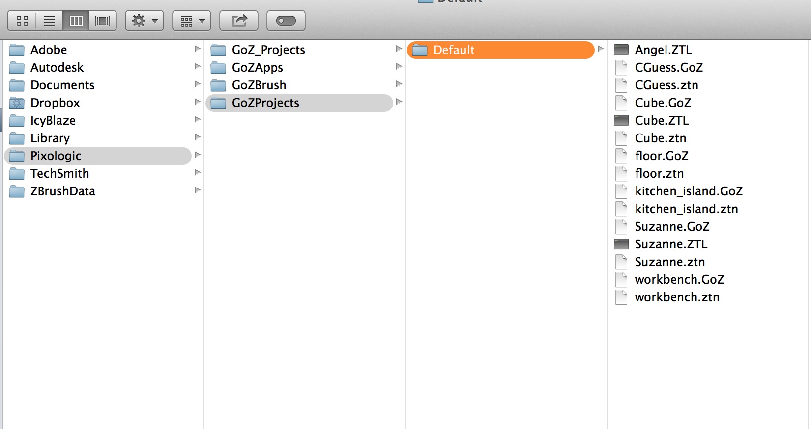

Ah yes, check out the screenshot. Has it got something to do with the ‘almost’ duplicate folder structure? I seem to be getting this. The .GoZ tools import OK by the way! They seem to replace whichever sub tool I happen to be editing in Zbrush.
What does the GoZ_Projects folder contain?
On Windows only three folder inside the pixologic one:
GoZProjects, GoZBrush, GoZApps
Try to remove GoZ_Projects and export from Blender, then check if GoZ_Projects is created again.
Okay, so I deleted the folder. It still gives me pretty much the same error. And the GoZ_Projects folder is not re-created. I do find it curious though that GoZ_Project folder had a .txt file that says something along the lines of "this is the folder for exchanging files between blender and zbrush…etc, whereas the GoZProjects folder had no such .txt file. GoZ_Projects also doesn’t hold the *.GoZ files being generated.

Okay, I went away and deleted the ‘265’ folders residing in Blender and it seems to have fixed it! Also renaming each object appropriately helps. (Plane_004.* confuses the Zbrush app?)

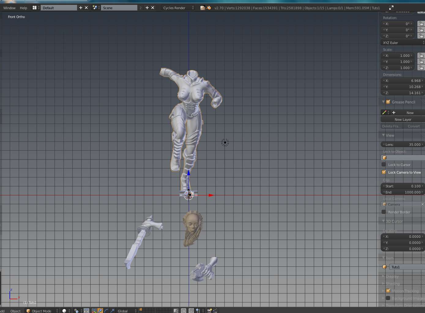

I continuing to have issue with GOB, in particular seems Zbrush and Blender don’t exchange correctly world coordinate.blender gob.jpeg
This happen when I send a file to Zbrush or viceversa. Not every time, but is quite frequent. Also, when I add some geometry (i.e. a cube) in blender, and send back to zbrush, zbrush don’t update the subtool but append it to a new scene/ztool.Again, not everytime, but is very frequently.
