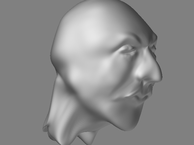

hello how r ya to every 1:roll_eyes: taht 1 is my new experimental work on which i m still working on it y iu submit uncomplet b/coz i need to alll my seniour cretisize on it thanx .
